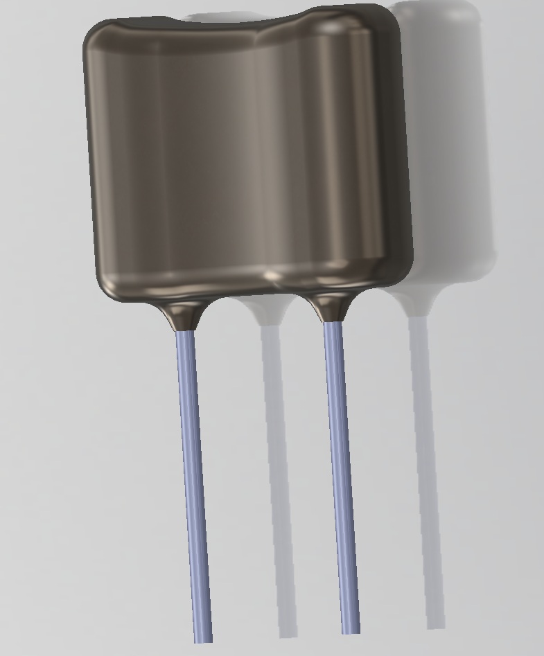

1st attempt, based on the CD15CD010DO3F part. It is a parametric model so I can scale it in SolidWorks. Dont know much (well anything!) about Eagle/POV, but most 3D software can import STEP format. Wouldn't mind more info on POV.
Had to try and guess overall shape from data sheet! and a bit rusty at modeling in 3D these days so it looks a bit lumpy, but can fine tune it.

hi marce,
Thanks, that looks more than satisfactory for my use.
Now to get it into a format I can use.

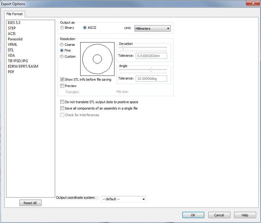

an STL version, and a screen shot of the STL settings.
I'm glad I've got Solid Works its much easier, I also use the IDF interface to get from the ECAD package (Cadstar) to the MCAD package (SW).

hi marce,
Thanks again for your time. 🙂
Converting the STL file to POV ended up being very simple and the result is shown in the attached image. The mesh file for this one object ended up being nearly 1 meg., at over 42,000 lines. 😕 Surprising... raytracing this file took only a couple of seconds.
