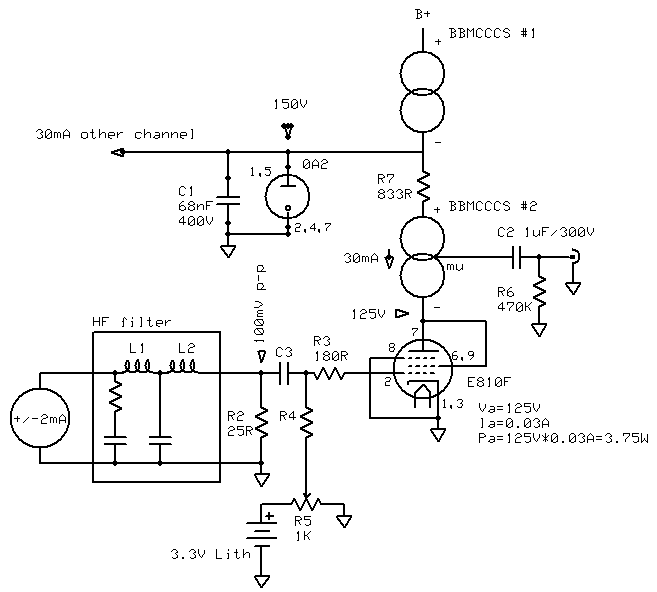

Umm.. I'm looking into the possibility to drop the stepuptranny I originally had in mind, and use a coupling cap instead.. No other reason than cost... So I am looking into battery bias arrangements using capacitor coupling..
I'd like some feedback (well, not NFB 😀) on the circuit attached, and it's bias arrangement. I'd also really appreciate suggestions on component values for the R4 grid leak resistor and the C3 coupling cap. Can't seem to figure them out

NiCad or NiMH in cathode,so you have batery charger without grid cap?
in any case-for 3.3 V lithium ,1K to ground is way too low value-stay below 0.75 mA for that purpose,and use whatever you can for grid resistor in range of 100K at least.

Not exactly sure what you mean..? The battery/pot arrangement with pot wiper to cathode?

Thanks. I agree 1K is way to low.. 100K would be more appropiate for the pot I guess. Would a 100K grid leak resistor to the wiper of a 100K pot be a good starting point?

Actually not. If you look closer, the top CCS does the job of a current set resistor 😉

*for example-in my preamp with EC8010,I have one 4Ah NiCd cell instead cathode resistor ; you got it now? 😉
** for start is good enough
*** mea culpa!
