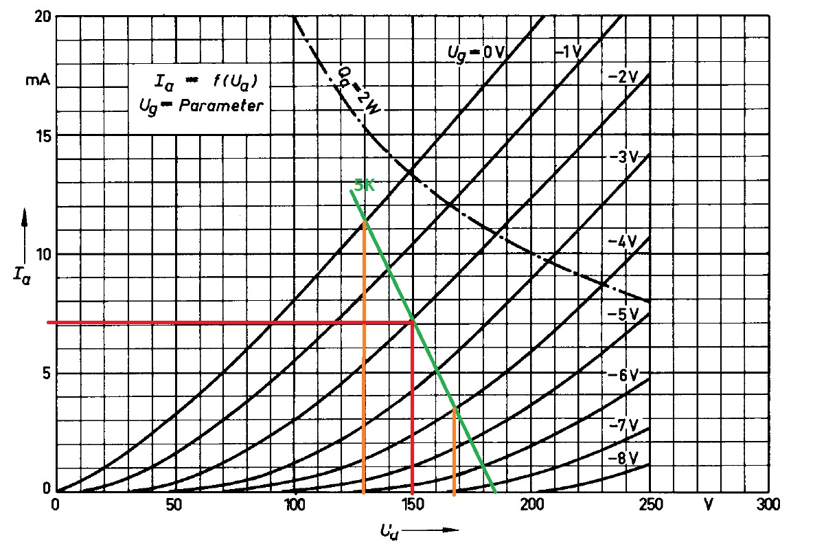

Hello,
want to build a PP pre with E80CC output tubes and have a plate to plate 10K Ohm, 600 Ohm secondary trannie. Have read some literature about calculation of the correct working point of the tubes for class A, but have some difficulties to understand the topic.
What I understood is, the correct primary impedance has to be calculated for the double idle current of one tube. So in fact, if one chooses 150V per tube and 4mA per leg of the trannie, than it should be 8mA for one leg and 150V. Result for this operatin point is 18K Ohms.
Could somebody please correct my calculation, if wrong.
Is there a possible class A working point for this tube that I could make use of with this 10K output trannie? Max. voltage of the power supply will be 300V, current is freely available.🙂

The working point for PP with 10K plate-to-plate load is the same as the working point for SE with 5K load (of course, PP stage will draw twice as much idle current simply because you now have two tubes).
Anyway, 5K load is probably not the best choice for the tube with internal resistance of about 10K. Technically you can raise plate-to-plate load even with existing transformer by using higher than 600 Ohm load on secondary, but the outcome depends heavily on the particular transformer.

Anyway, for a 5K load (10K plate-to-plate), I'd go for something like 150V and 7mA.
Max input voltage (for each input in PP) - 2Vp-p (1.41Vrms)
Max jutput voltage at 600 Ohm load - 9.3Vp-p (6.6Vrms)

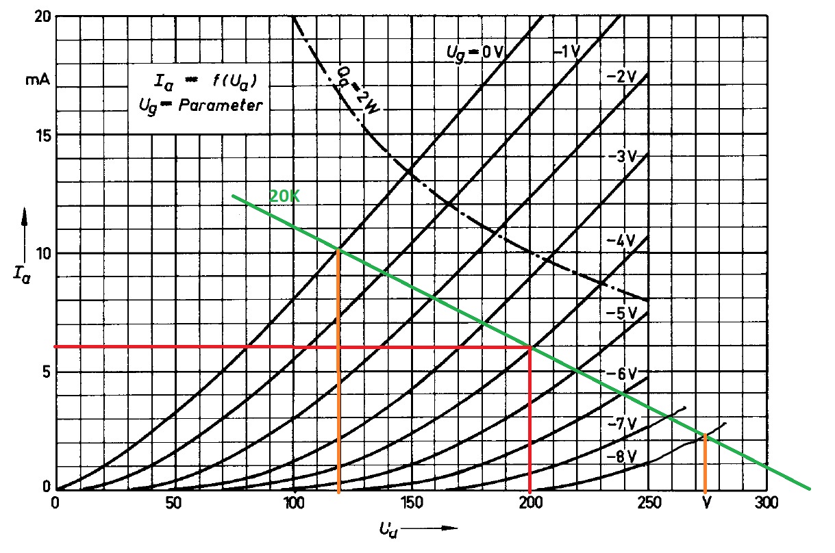

For a 20K load (40K plate-to-plate) it's rather 200V and 6mA.
Max input voltage (for each input in PP) - 4Vp-p (2.83Vrms)
Max jutput voltage at 600 Ohm load - 19Vp-p (13.43Vrms)
But using 600 Ohm load at 150 Ohm tap is no better than using 2.4K load at 600 Ohm tap, and results again depend on the transformer.

That's true, and because of that with lowish loads you generally want to work in the high current/low voltage area rather than vice versa.
But what's even more important, with higher voltages the load line will go above the maximum plate dissipation curve, which is not acceptable for any serious design.

When using the 150 Ohm output tap for 600 Ohm gear, does this mean I can use the 20K OP point instead of 5K? That seems to work with the Shindo E80CC.
Yes, you can, but it might introduce some problems like higher LF rolloff or bump somewhere in the HF region.

LF rolloff probably will be quite high anyway given the fact the transformer is designed for tubes with much lower plate impedance (not enough primary inductance).
