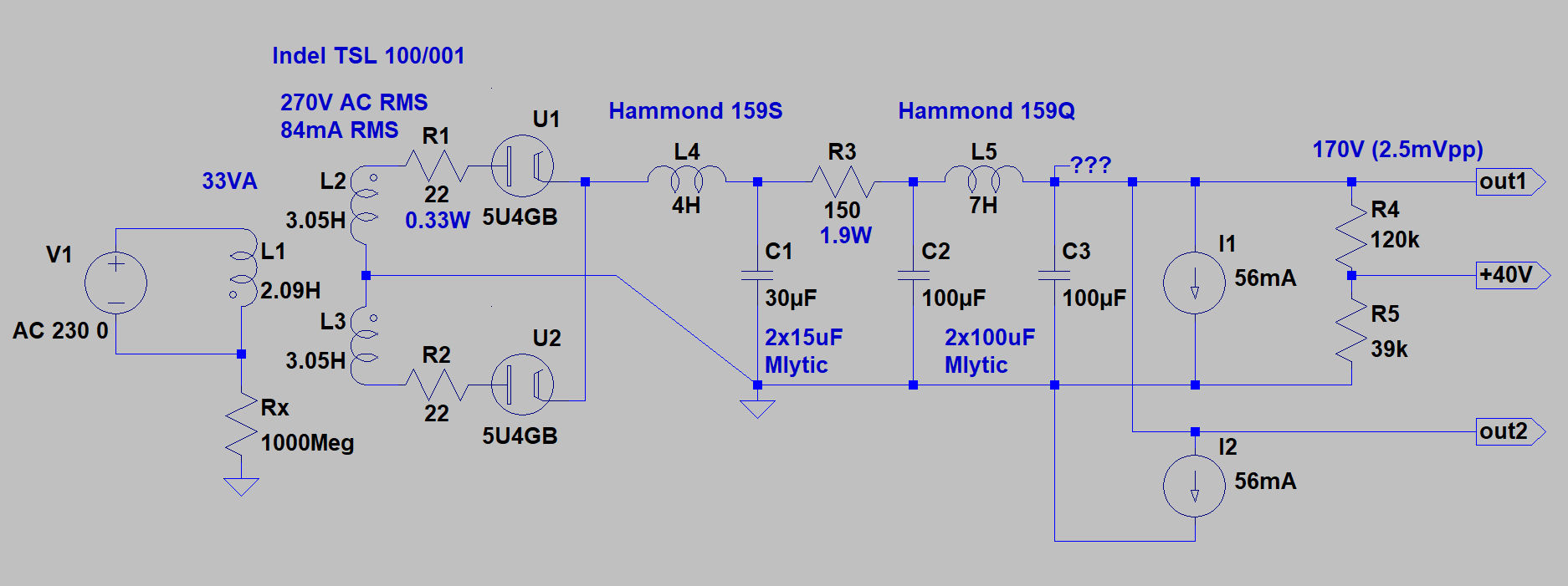

I am considering an E55L parafeed spud amplifier later this year. I've been doing this tube DIY thing for a little over a year now, want to see if I am overlooking anything and get some feedback.

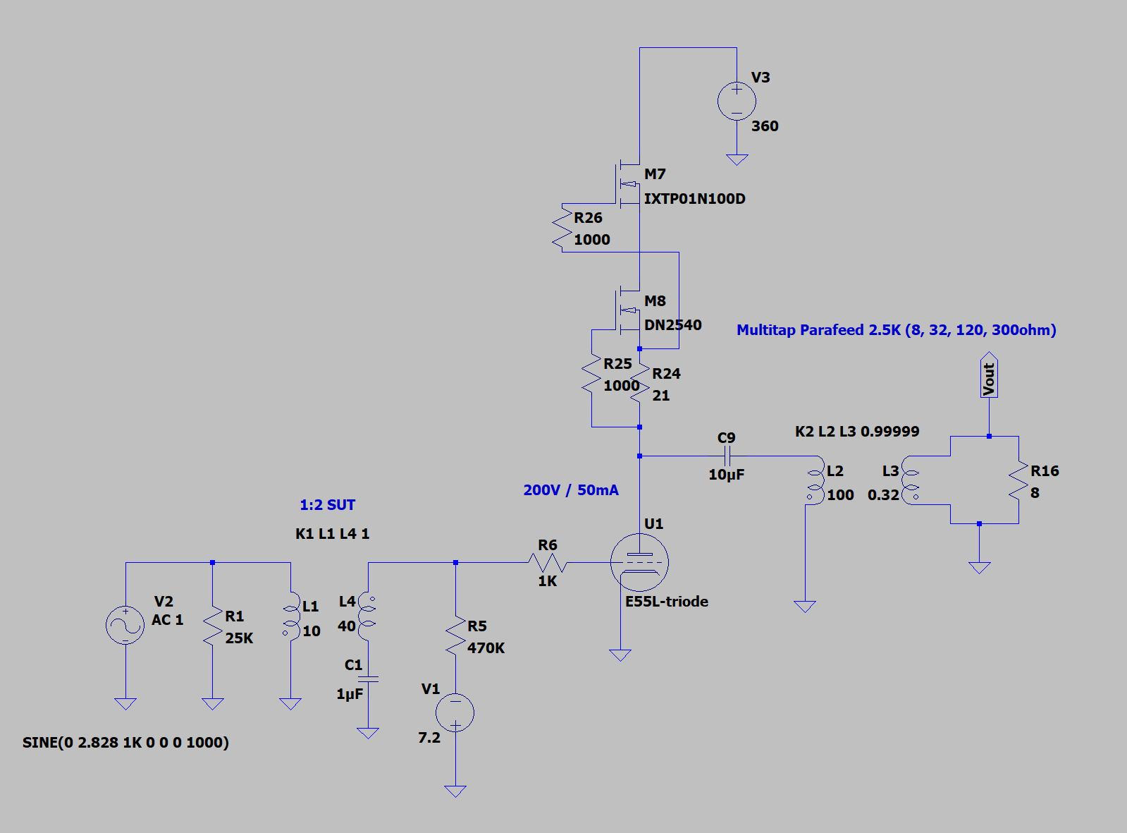

Here is the draft schematic and then some commentary. Note that some part values are stand-ins.
Rather than a plate choke, I would use a cascode CCS load on the E55L. I have a spare Sowter 325VAC 161mA mains transformer with the appropriate voltage to cover the full peak-to-peak E55L plate swing and headroom of the CCS.
I would like to use a 1:2 SUT on the input to reach full output of the E55L with a 2Vrms input.
My mains transformer has three 6.3VAC secondaries. I was thinking of using a voltage doubler on one and going fixed bias since the E55L will only need around -7V on the grid.
The other two 6.3VAC secondaries would be used for the E55L heaters and a tube rectifier.
For the power supply, had thought to use 5V4G or GZ37 for soft start. The Vdrop of the rectifier will help chop off some excess voltage and spare the CCS some heat. Given the PSRR of the CCS, a simple passive CLC supply could be used.
For output transformers, I have swapped emails with Jack and Electra-Print a few times, would like to try his stuff out. I had thought to order a pair of multi-tap 2.5K parafeed transformers with 8, 32, 120, and 300ohm secondaries. This amplifier could do around 2W into 8ohms, so good for a flea-watt speaker setup and gobs of power for headphones.

I prefer solid state rectification, 330VAC is just within reach of some of the common relais like the finder 40.52 series. So you could use a 555 and a relay to delay the application of B+ untill the E55L has warmed up. Not that tube or solid state really matters once you put several meg in series with the circuit (speaking of that cascode CCS impedance)

Yes, exactly my thought, with the CCS in place, the power supply becomes very flexible. I will consider the relay approach, I do like the rectifier to drop some excess B+ voltage to spare the CCS, but of course there are other ways around it. There is the rectifier aesthetic appeal 🙂 you have read my mind, I have some ceramic Russian magnoval sockets on the way! Thanks for your input.
7v grid bias - are you thinking bypassed resistor, string of diodes or going fixed. its annoying high but not that high....
also, given relatively high drop and and current through top mosfet, would the ixtp08 series be a bit easier to tame the heat? scratch that...either will be fine looking through datasheet, asnd the 01 have ever so slightly better specs.
Hey adamus - no bypassed resistor or string of diodes, I was thinking grid bias, negative bias supply generated from a 6.3VAC winding with a voltage doubler 🙂
As for the top FET, the 01 is a stand-in since I do not have a LTSpice model for the 08. But the top FET WOULD likely be the IXTP08N100D2, the bottom either DN2540 or IXTP08N50D2. Unfortunately, the DN2540 is backordered for quite a while, think I might have a few left...

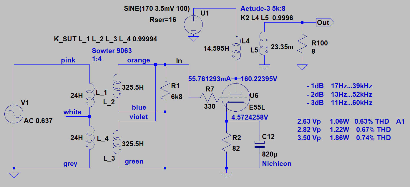

I am afraid this is a very optimistic approach. 🙂I would like to use a 1:2 SUT on the input to reach full output of the E55L with a 2Vrms input.
I'm not sure that 1:2 SUT "enough" for 2V RMS (2.82V peek) input.

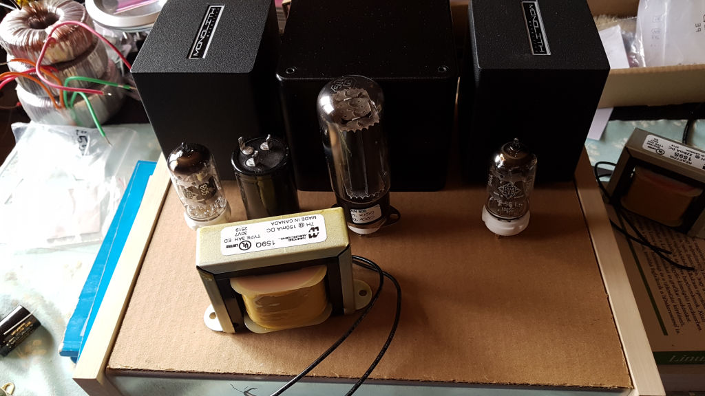

I tried my SUT as 1:2 (see attachment), but the final layout will be as 1:4.
Little lower HF bandwidth, but after all, the overall limiting factor is the OPT.
I’m beyond the design phase, only the mechanical work is back ... I hate it. :-(
Hmm I will have to see, maybe 1:4 is necessary to drive to clipping. Monolith magnetics, very nice 🙂 I thought you never use cathode bias! And a 5K primary OPT?
Also, what is the purpose of the +40V supply? I need answers 😀

It's a minimal version, only few parts. 😛
I have "small" -2W, and only 2kg weight- 5k:4-8 Monolith transformers, so for this purpose it's right.
+40V is for heater lifting.
If you remains below A1, the 1:2 may be enough, but the desired power will be very reduced.

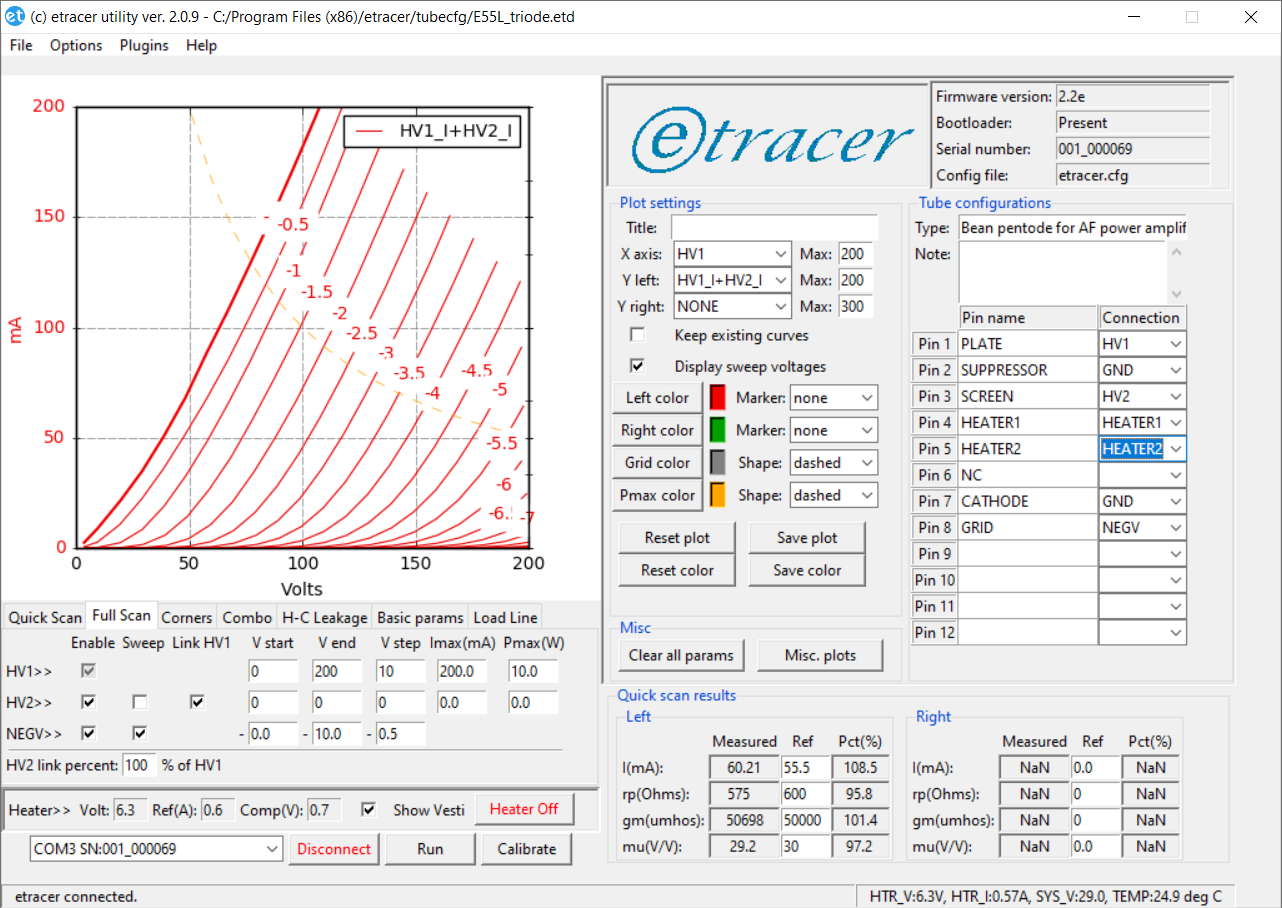

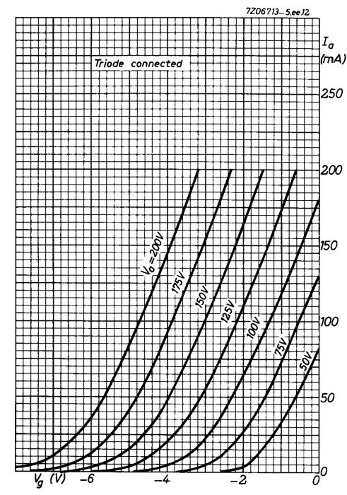

cathode bias is superior to some other biasing forms because it is less susceptible to thermal runaway.
Some of the frame grids like the E55L have G1 very close to the cathode, they are insanely built tubes.. And some of the last ever made, the product.. the swan song of tube engineering.
However the flipside of having these frame grid tubes with grids that are wound thinner than the human hair and insanely close to the cathode. Is grid current. I realized this rightaway when i saw your 470K grid resistor in the first post. But i didn't wanna come off like a wise-***. Plenty of that going on here, and im not immume to that myself. Catch me on a bad day, or take a dump on something i really put some thought in, and your in for an intellectual ******* contest to satisfy my ego.
But at least im honest about that.
Some ideas you can try: You can try some Sillicon carbide diodes in the cathode lead.. but this means the circuit becomes slightly more suceptible to tube aging.. So if you figured -7V is the sweet spot. Id say use 4 Sic diodes with a resistor in series for the cathode, this provides some local feedback(cathode regeneration)
There is not really a point in bypassing those diodes, cause they have a really low AC impedance.

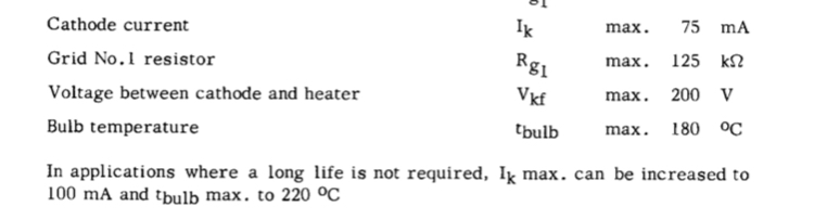

Grid bias is a no go for me, unless you are fine with like 10K input impedance.. which is reflected to 40K for the tube grid. But that may cause trouble if you want to build another box with glass on it to drive it down the road.
If you only need 7V cathode bias is the way to go hands down for reliability and simplicity.
