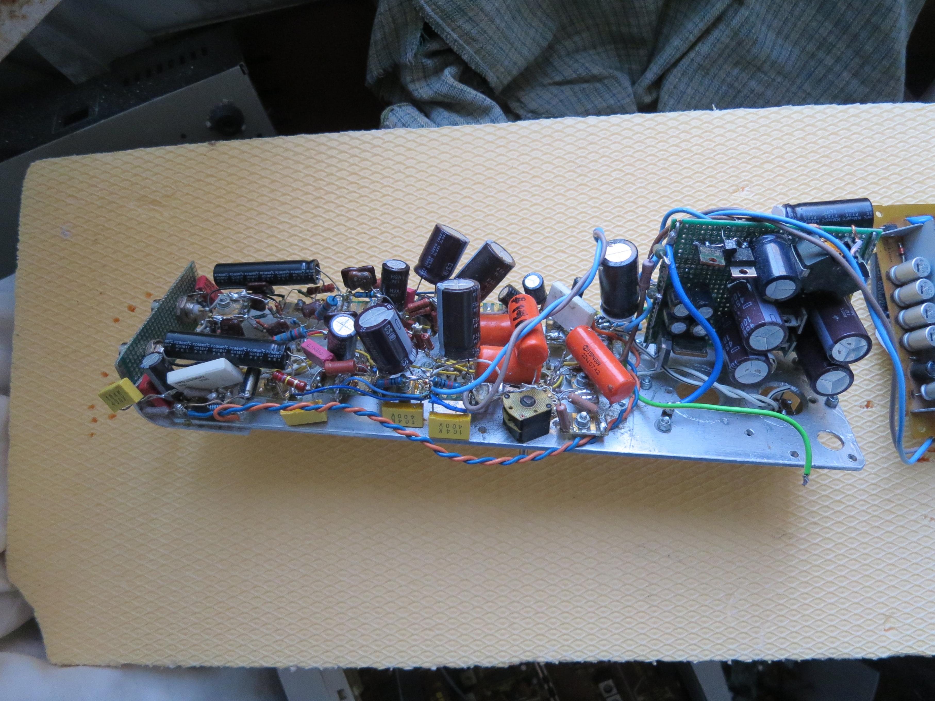

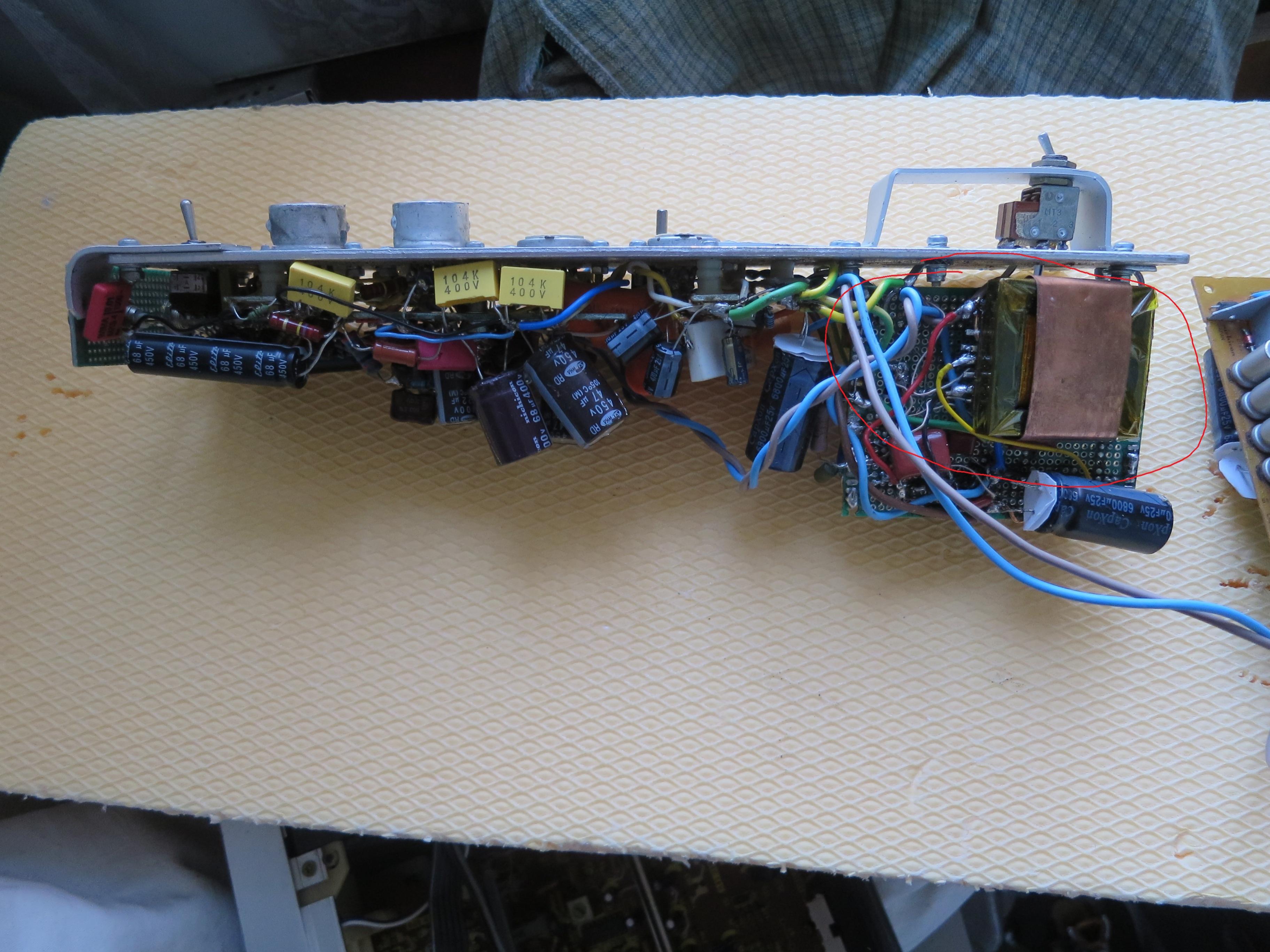

I am trying hard to promote a very simple idea able to solve any class A tube preamp or amp easily.You only need a 12v switching power supply ( i chose a sony play station 2/3 or xbox360 12v ps which are pretty low noise for audio .You can modify them easily to give 12.6 v instead of 12 , but 12v is good enough for fillaments.Then you can to build a 4 transistor baxandall resonant converter for the anodes raising the 12v to whatever voltage you need like i did here for my Luxman cl34 clone following Davekni advice which proved to be really usefull so all credits to Dave for the schematic: Baxandall converter strange output

You welcome...for both topics.You may ask a moderator to merge them both together...Luxman cl32-34 schematic showed me the best way to use a cap multiplier for fillament noise reduction, but then i needed a 390vdc for anodes and i didn't have the money to buy an R-Core transformer which still is the best solution for supplying a low noise circuit, so i tried to be a little bit creative with the components i had at hand.
