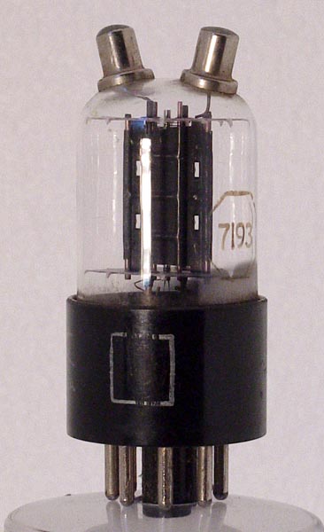

I don't know where you found that info, but I have never seen that issue. I use them in my preamp and they are dead quiet. In fact, they are much less microphonic than the 6SN7s they replaced. Hum is usually due to a poor power supply, improper wire routing or a grounding issue in my experience. Did I add that the 2C22 are also dirt cheap - I've picked up dozens for around $3-7 each for NOS WWII vintage RCA, Ken-Rad and NU.
The only drawback to the 7193 is that you have the grid and plate on top, so if they are exposed and you have kids around or curious pets they might get a jolt. I actually think they look very cool sticking out of my preamp - kind of mad-doctorish.

Thanks, I should have added that some were saying they too had replaced 6AN7's with them.
I tend to agree with the cool look, certainly more intriguing than a Philips Miniwatt!
