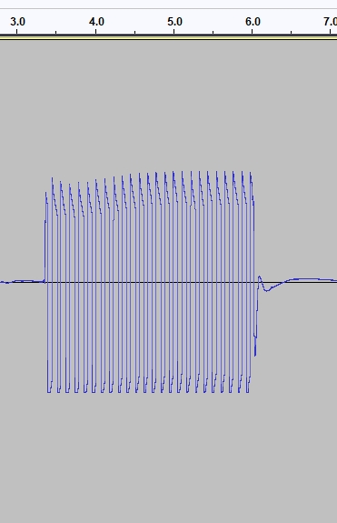

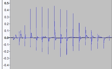

Story continues. Today opened unit again, resoldered the power plug connector from board, because it seemed to have some wiggle. Problem still persists. Here is what I can record with a mic, this is me tapping gently on the microphone.
There is significant hiss if I put on direct monitoring and turn the mic input volumes higher. Turned all the way up it starts a feedback loop. Also sometimes when I turn the phantom 48V power off/on there is a loud high pitched whistle audible.
System sounds still work normally. Can't get over the fact that this started with software update. Could this be a driver thing? Can the input channels be configured somehow wrong in Windows? Any help much appreciated still!

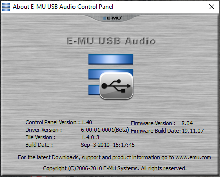

Installed the 1.4 beta package to a fresh 64-bit W10 (.1903) as seen in attached image.
No issues here so, it might be that your
- W10 build is newer (they dropped support for some audio devices already in this 1903 release)
- firmware upgrade/update proces was not complete (if ASIO not working properly with inputs)

I have the same info what your attached image shows (different date and version of course) and Driver Details says: "no driver files are required or have been loaded for this device ... . I have an old Audigy 2 card installed too and it has the same info there... .
