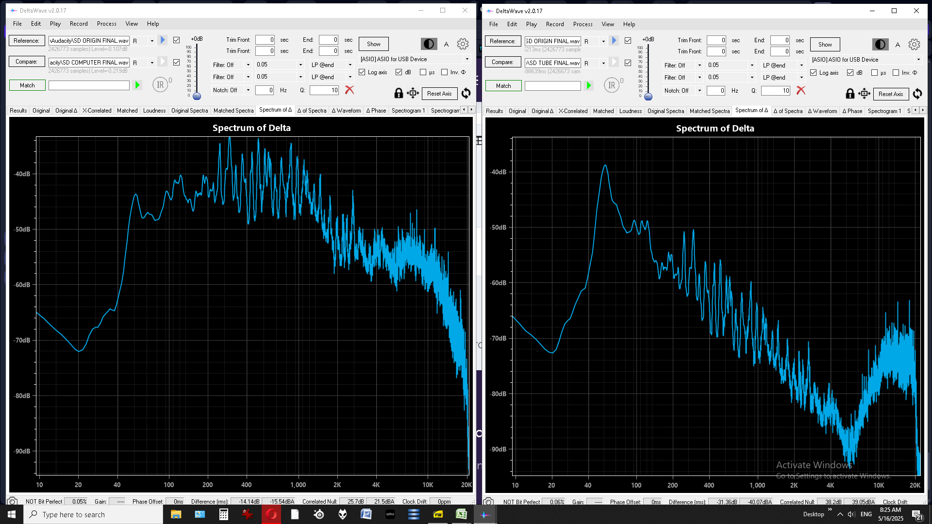

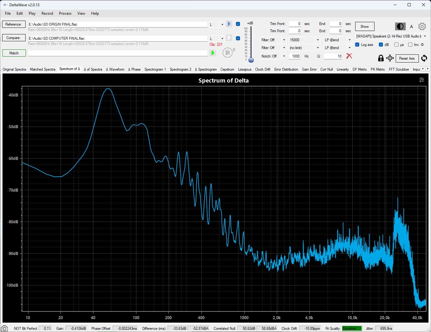

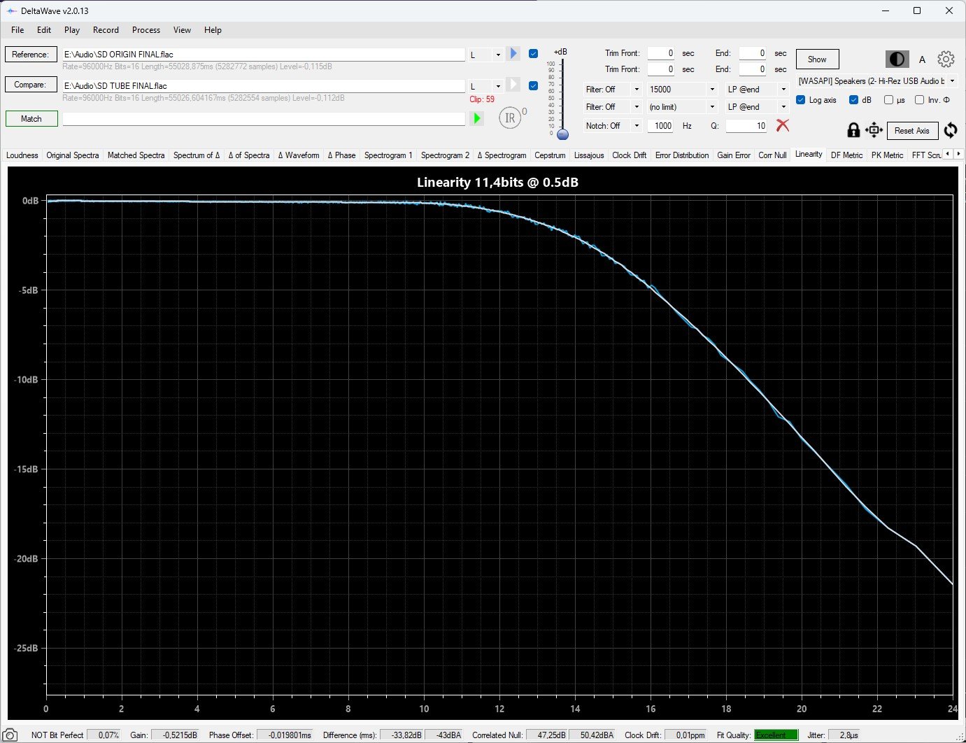

I listened to the 'difference'

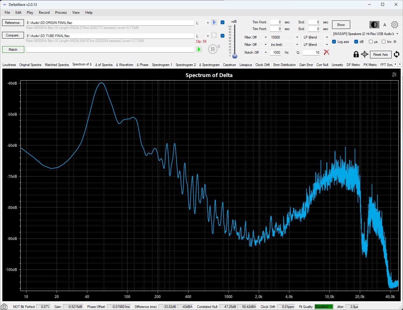

In the tube dac the difference is a few orders of magnitude lower and it sounds quite close to the original...
Bass is a bit bloated just a little, the mid frequencies are attenuated and the high have a little bit of high pitch distortion and a raised frequency response, as it can be seen in the graphics...
On the contrary the difference with the SS dac is quite annoying to hear it has way more distortion and is very loud enough.
The bass is missing but the midrange is very distorted and extremely aggressive and bad sounding.

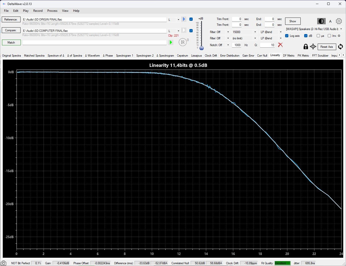

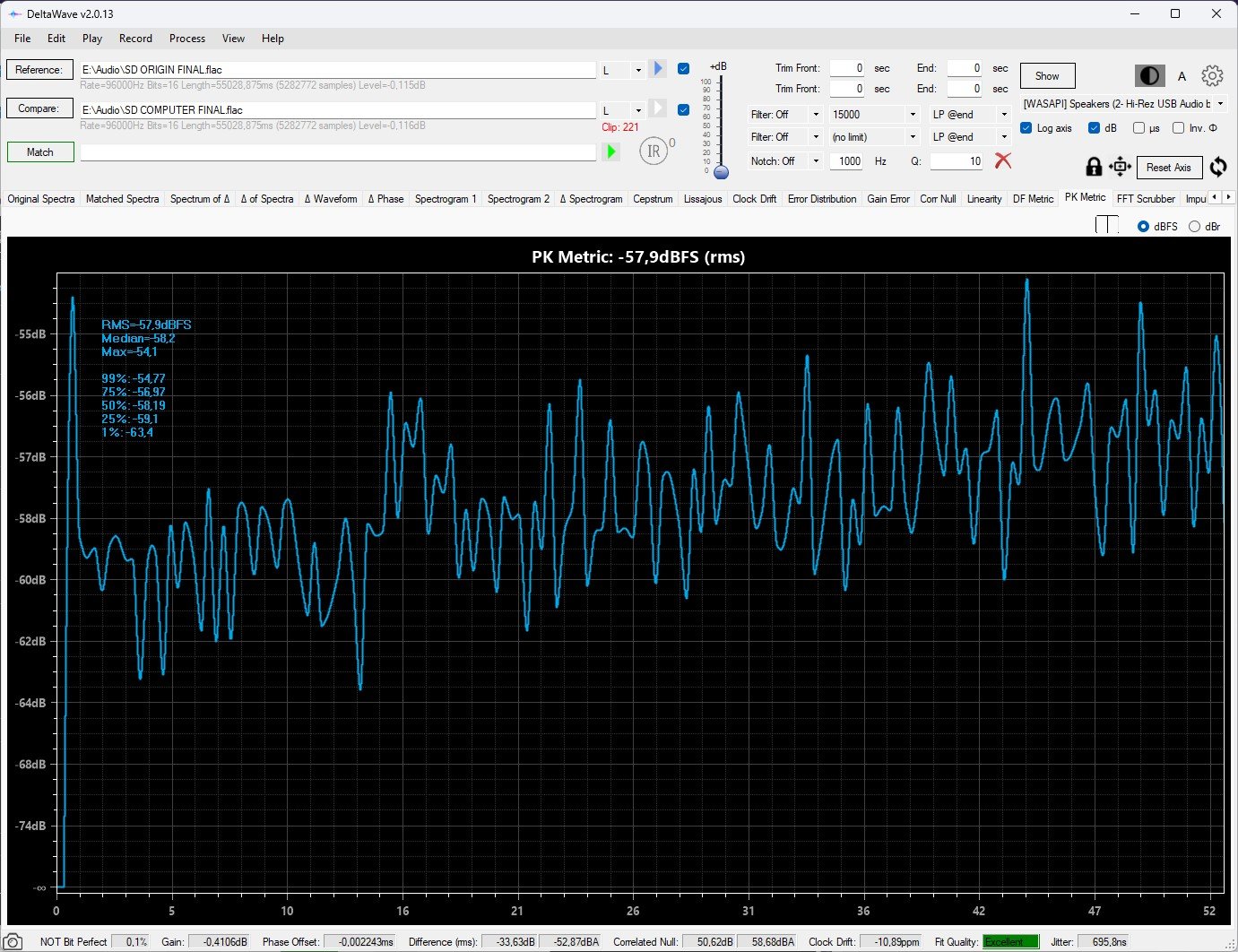

For some reason I get quite different results with DeltaWave. Computer seems to be closer to original.

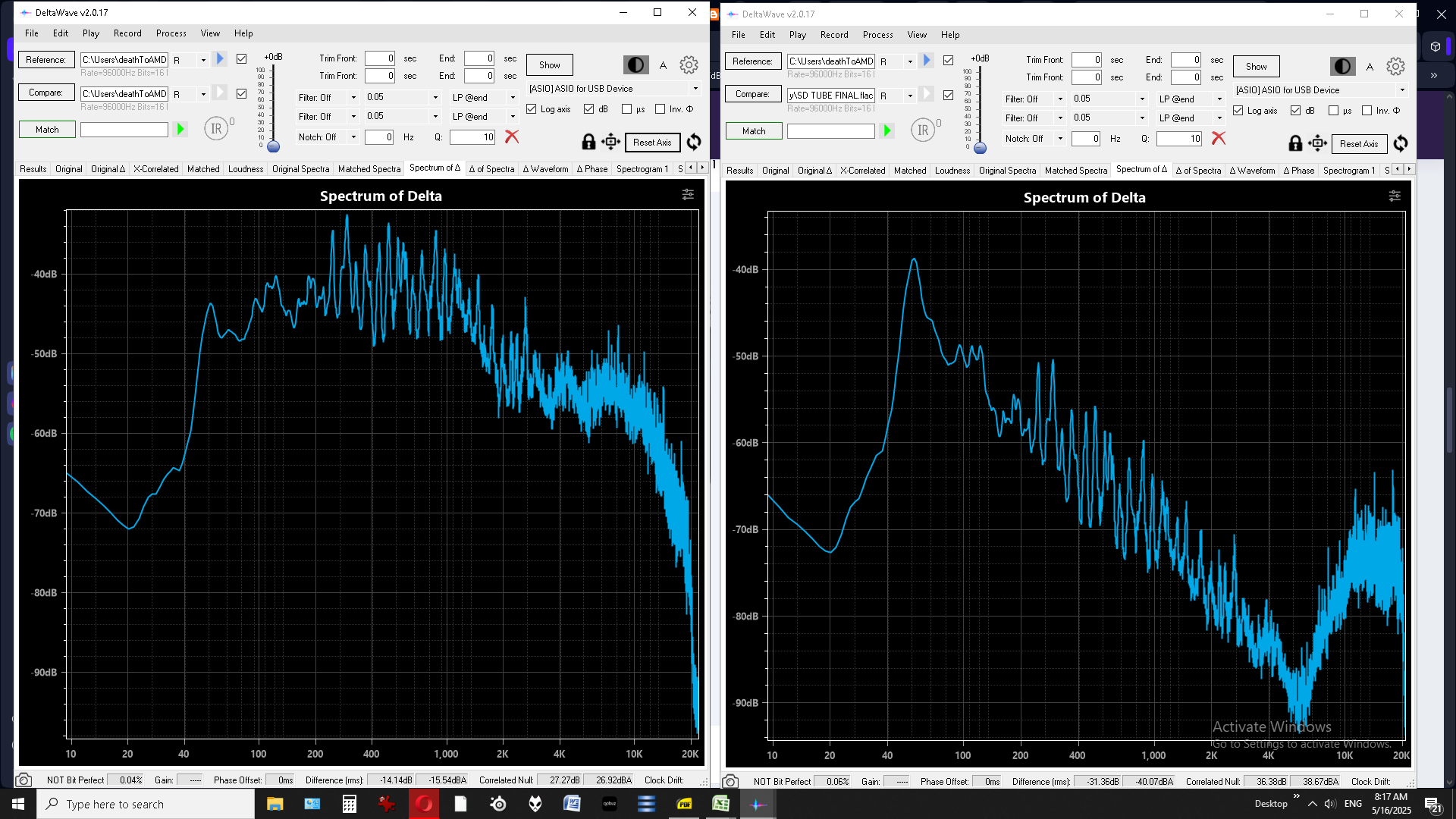

I rechecked the fine synch, it is spot on bit per bit, and length is the same.
The bottom point is that when I listen to the difference the distortion result is very horrible with the computer dac. The EMU with tube output sound very nice.
I don't know which other test I should make, I have the pcm58 which I could test too to hear some of the THD pattern that it has...
Listening to the difference is not the best way to judge the DeltaWave results. Small differences in matching (especially timing) will be heard in transients. And since you are listening to the difference the better it sounds the more is lost compared to the original. As an extreme example difference of original and silence sounds just like the original.
The graphs I showed in post #46 are better indicators.

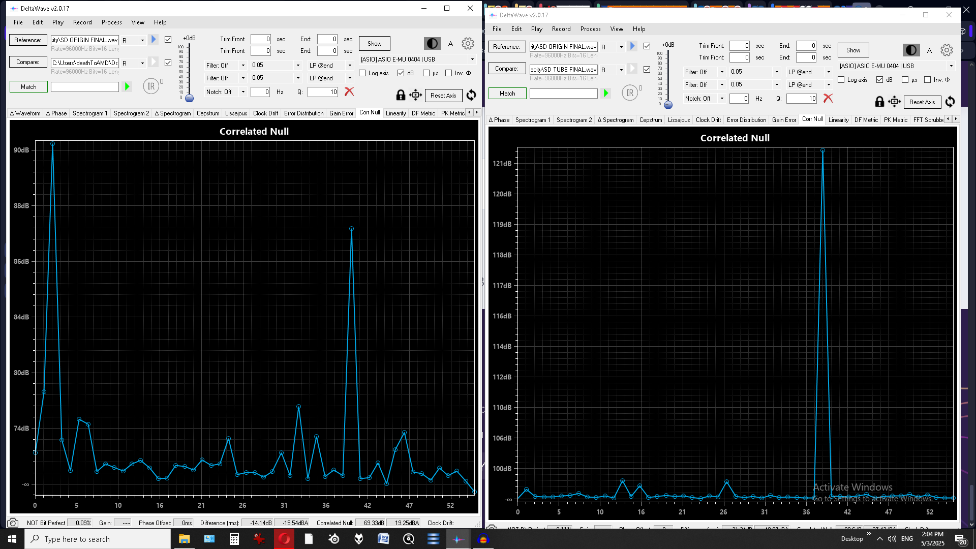

That is what it gives me which makes a lot more sense, this is what I am hearing...
You should do it with the Right channel only , it is in mono, but what I used in the Right channel to mono. The left channel might have been altered from the only right channel to mono, idk.
