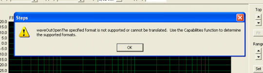

I picked up the 0202 and it works with audiotester with the occasional crash. Arta keeps giving me this error unless i go to the 48K sample rate.
any ideas?

I still get crashes with audiotester (running parallels on a mac) but when it is working the sweep function is sweet. I was unable to get ARTA to work at anything other than the 48K sample rate and the sweep i ran was painfully slow.
