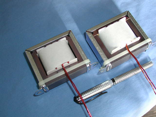

Hi Tony,
How are you doing with those trafos?
I'll be buying EI 150 to do some 500 and 750VA power trafos for a couple of amp projects.
Since I'm bringing in some material I can make gapped coils for CLC supplies if there is enough interest. What I can do right out of my hand are 5 mH 8 Amps and 15 mH 4 Amps or there abouts on EI-100, hand wound, perfect layering, varnished and super low Re. Other values are possible. Just for the record, this is not a business (well, so far).
You wont find this type of compact coils ready made on the market as far as I know.
Some examples of what I've done...
