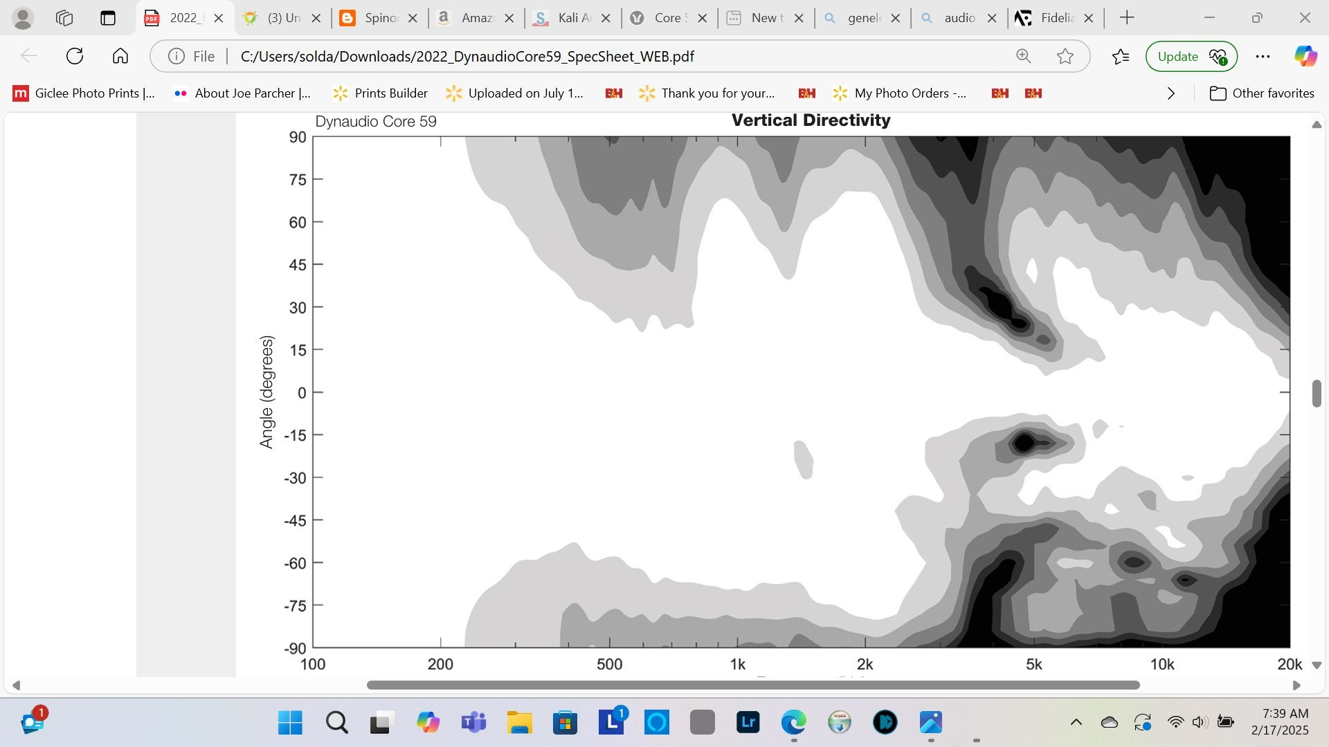

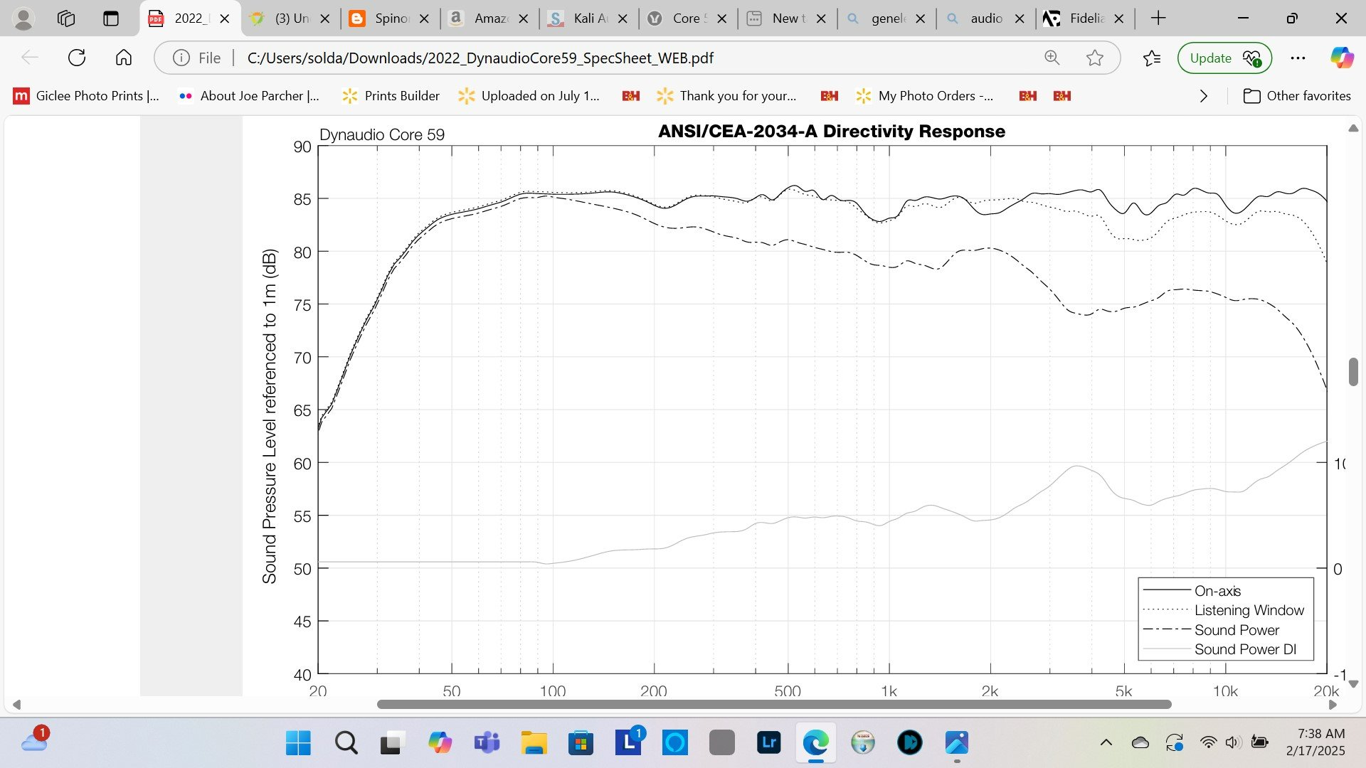

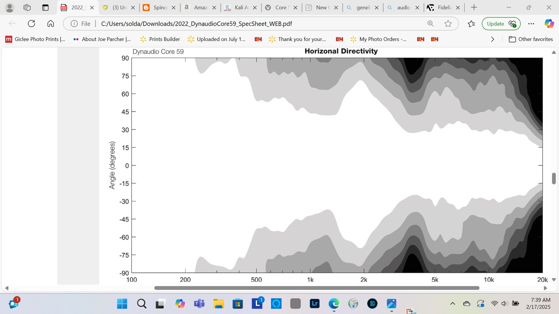

I am wanting to lower my crossover point for M & T . The factory points are 385 & 5k. I don't like the 5k crossover point as directivity is bad in these which surely doesn't help when trying to EQ. There is a USB service port on the plate amp. I know it uses Analog devices 64 bit dsp engine but would be nice to just do it thru existing dsp with software etc.. The plate amp is Pascal. 500-500-150. Dynaudio surely doesn't want me doing this so no help. If I can't find a way to get into the existing dsp Any ideas how to get into that dsp system to change settings ? Below is the issue. The design is poor for 9' listening distance in non treated room. I run direct in using AES3 .
