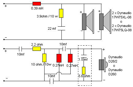

asking myself what peak & amplitude is notched with the bass drivers notch filter? Does it not tame some dynamic behavior as a bad consequence ?
What is the device in the right corner of the schematic please ? Fuse ? polyswitch ? else ? Strange impedance correction... i assume it's for the midle driver resonance padding at driver Fs ?
hum 10 uf + 6.8 uf on the tweeter with Jantzen Superior is not cheap... for an upgrade !
Anyway it is for the 2 , we don't know the Mk I owner shematic , nore the exact reference rivers he has vs the MK II... sure it is not a more difficult Kef 107 ref or a Kef 104 ref filters or a big Spendor...

In the Netherlands a lot of people liked the diy double 17.
You can also use the car units like md130 and 2 mw160.
Just need to change the filter for two series mw160 woofers.
replace coil 0,39 for 0,82mh, resistor 3,9 for 8,2ohm and capacitor 22uf for 8,2uf and plce the woofers in serie.
They sound better then the contour.
