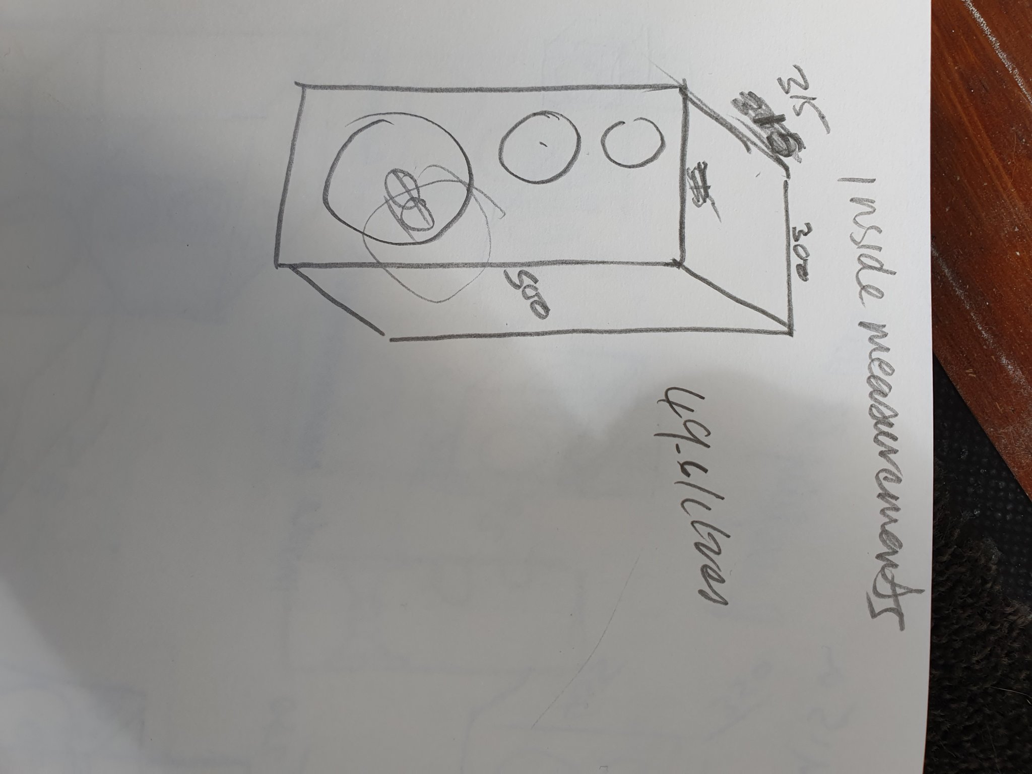

I'm not sure about the layout . I want to keep the drivers as close as possible but I don't want it to look weird if I chamfer all the sides away from the drivers I don't see any reason why I can't run them up the center of the cabinet rather than off to one side .anyway ...
