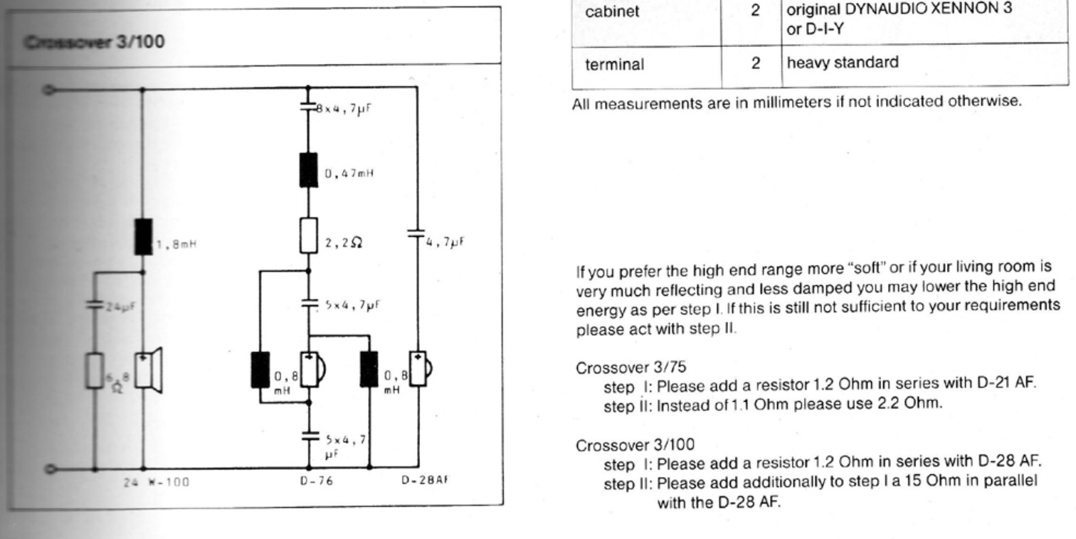

Hello I'm looking for some advice. I was looming at getting the below drivers for a 3wat design but I'm finishing it impossible so find them.
Dynaudio 24w 100 / df 76 / d28-af
Can anyone recommend where to find these? If not does anyone have any alternative driver and crossover combinations that will give similar if not better results.
boom0789,
From what you ask, you are not being very explicit, you want a speaker with a dome mid driver. There are plenty of comparable speakers and designs/kits. You have to mention your level of aptitude to deal with crossover design and measurements/simulations or ineptitude to make it yourself and working only with finished and tested designs.
The drivers you mention are referenced here with this design for the Dynaudio Xennon3 speaker/crossover (see pic below). Woofer, Mid and Tweeter and kit:

To have a similar setup you can either choose a more conventional speaker like one for home/hifi use or another more pro-sound/PA/studio professional type application. For the second type there's a lot of builds with the ATC SM75-150 Midrange be either the pro ""S"" version or the other one. Examples and links here.

A fantastic 3" dome that would be the closest in size to the Dynaudio would be the Tang Band 75-1558SE.
Tang Band 75-1558SE 3" Textile Dome Midrange 264-857
3-WAY DIY kit using Peerless Exclusive 830884, Tang Band 75-1558SE, and SEAS 22TFF here.
