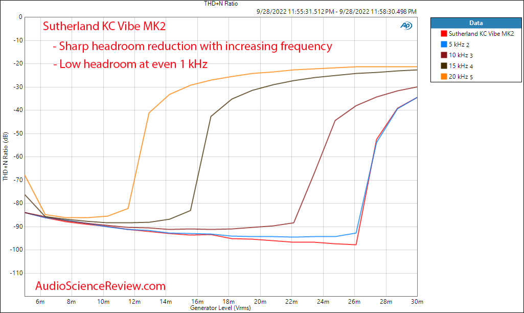

If the pic below is representative maybe a pretty good chance of it being a fast high frequency clipper though. 16 mV @ 10 kHz is 10 dB above 5 mV.There is close to zero chance a phono stage becomes a dynamic compressor unintentionally.
AFAIK compressor does not produce significant rise of THD as a mere clipper would do. It changes the signal anvelope without clipping it.If the pic below is representative maybe a pretty good chance of it being a fast high frequency clipper though. 16 mV @ 10 kHz is 10 dB above 5 mV.![]()
Depending on the compression curve that's probably the case. For HF clipping much of the distortion falls at the very top of the audible spectrum and, judging from too many years tuning over-the-air broadcast processors, often also manifests as a blunting of the sense of dynamics. Not very different from the perceptions reported by 7Crankshaft above. Wondering if tube phone stages do better in this regard.
