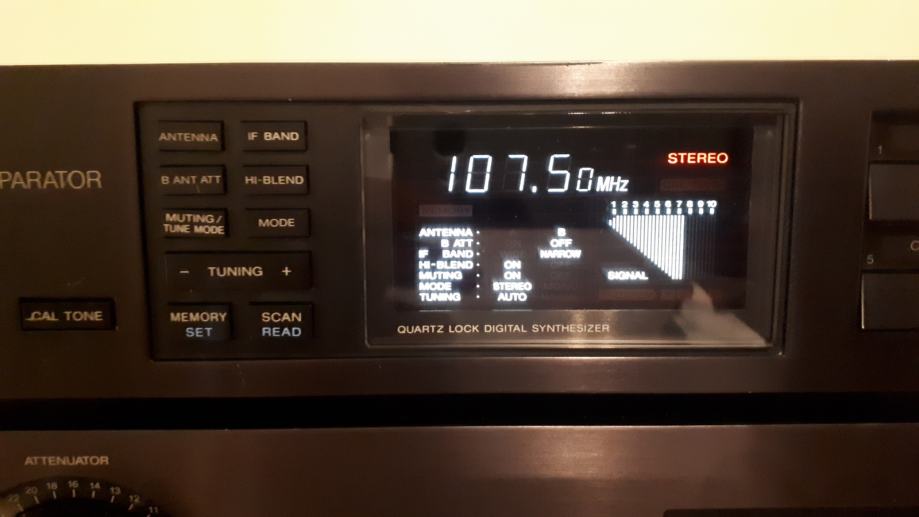

Sony st-s555es has two antena inputs, one with selectable attenuator. Pretty standard feature.
One other usefull feature of this sony tuner is that setting stations to memory remembers all the other settings, like narrow/wide, which antena, attenuator if used, automatic mono/stereo.

With more than 90dB signal to noise, and 0.03% distortion, sound on good stations is identical to cd. Never felt the need for any dynamic range enhacer. Did opamp and cap upgrades though.

The Sony ST-SB920 also stores the antenna input, attenuator, IF narrow/wide and mono/stereo settings for each preset (after you switch off the routine that automatically selects the wrong settings, but you only need to do that once). As a volunteer at a local radio station, features I particularly like are the fact that it can display the RDS PI code (which is actually not meant for the listeners, but for the RDS firmware) and the signal strength indicator with 1 dB resolution.

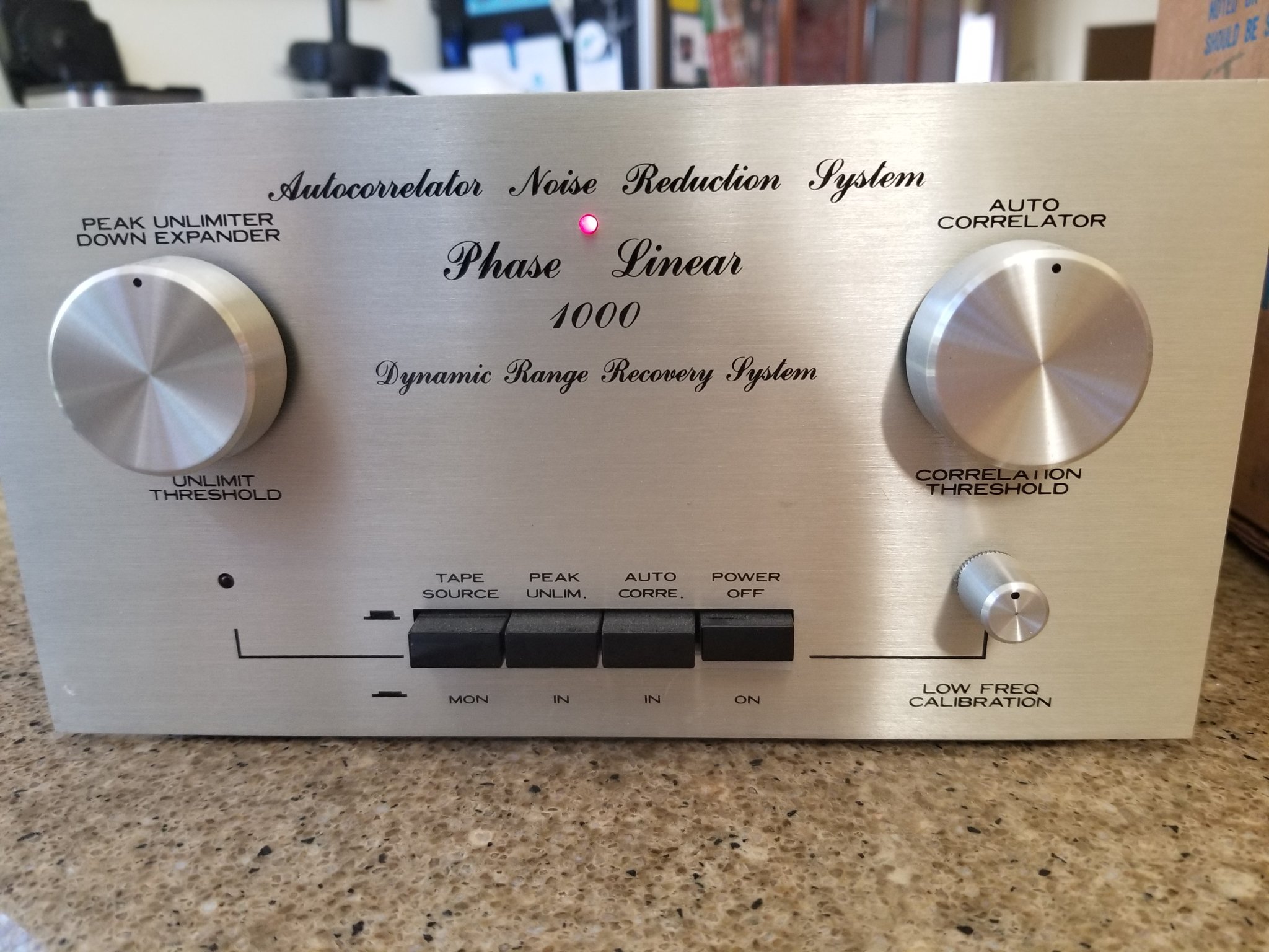

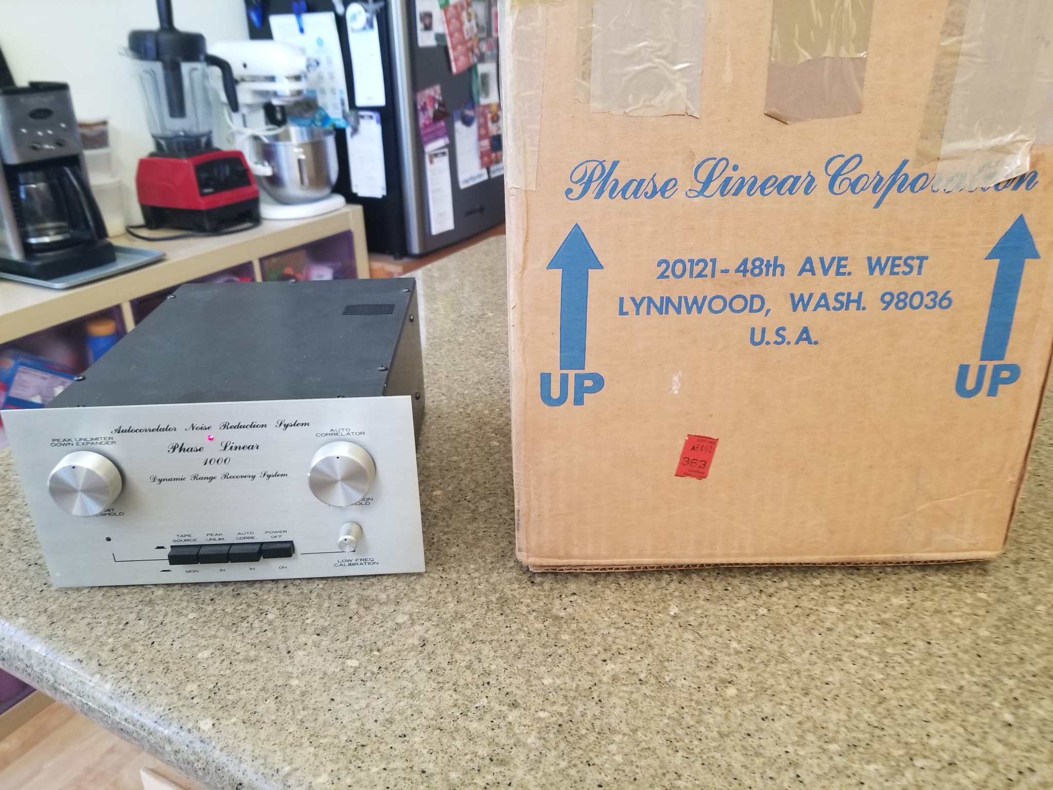

OK, so I got something today... the Phase Linear 1000. The seller claimed it was a estate sale and it looks like it. It looks like it was stored, indoors, in its box for decades. It powered up but I got no signal... after playing with it a little and reading the manuals ( user's and repair ) it dawned on me the front switches were likely the culprit. So after cycling through 300+ times, I got music through but not quite reliably through the processing circuits... so tomorrow I'd use deoxit.
I paid about 125 all inclusive in eBay. The seller is not an "audio" seller but handles states, so he seemed honest... and he was.

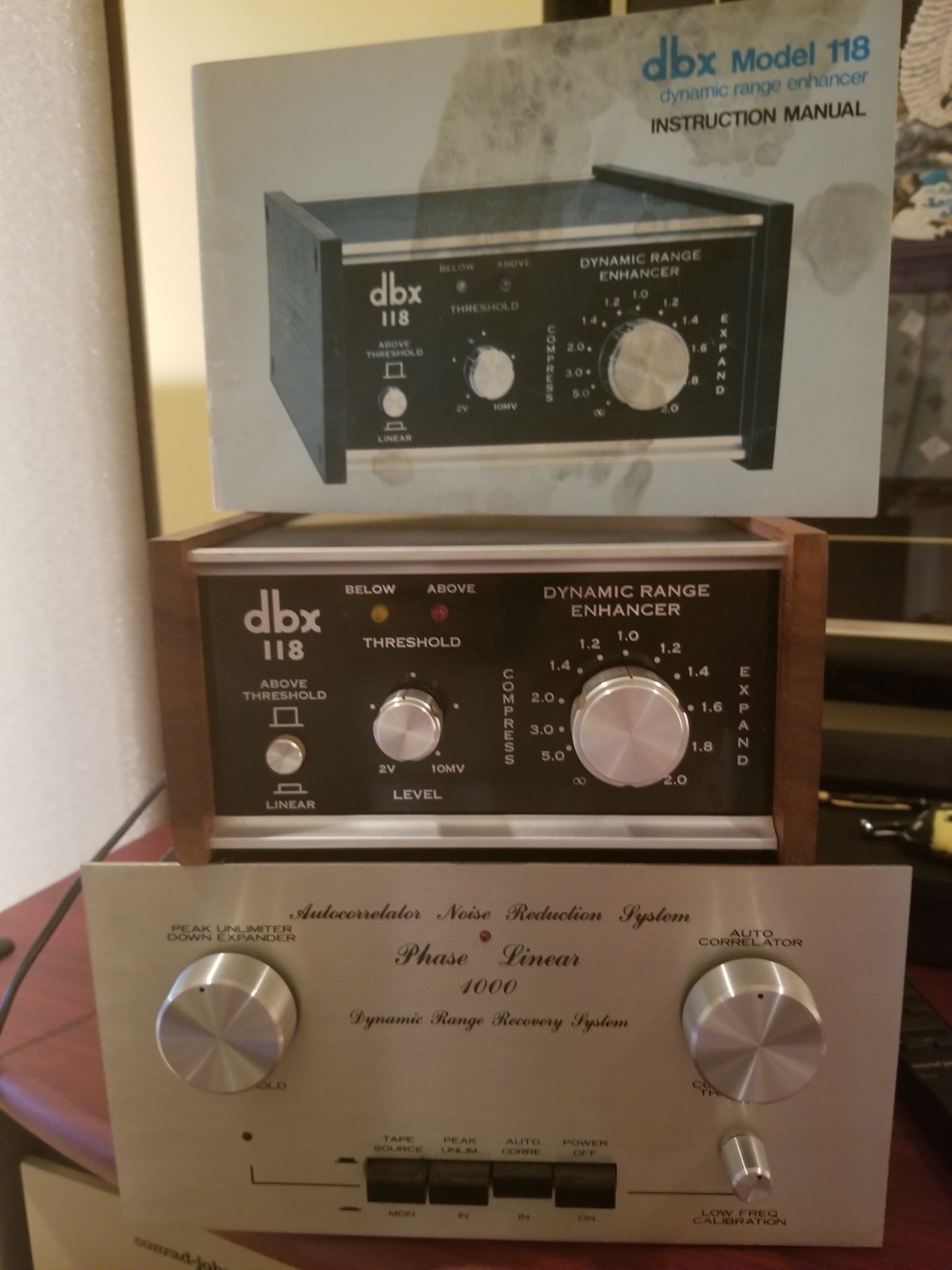

Now then, a dbx 118 is coming in tomorrow from @Dave R for shipping and beer money. THANKS. Next time I go to the PNW I might have to see if I can show up at their Audio Group... bring the Bose "stereo nowhere" hat.
So now, looking at the RG models.. I guess the Pioneers and RG are the same... after the first gen. So, I'll look for one of them.

It may need more than deoxit to sound decent. All the electrolytic caps should be replaced. Do not give up on it.
Stumbled upon a bunch of info on your new box; https://www.kenrockwell.com/audio/phase-linear/autocorrelator.htm
There's a link in there about restoring / modifying it. Worth a look IMHO

Interestingly, those black-push button switches started giving me trouble as well. (poor manufacture/design)
Definitely a job for Deoxit. I didn't have that back then and WD-40 didn't work 100% totally perfect.

Awesome info folks. I hooked it up to the EPL ( tape ) loop of my preamp using good quality Audioquest interconnects.
After lots of using the pushbutton switches ( I was up at midnight having a rum nightcap and pushing those darn things ).... the tape/source works well, the autocorrelator is a bit noisy but it works, the expander only outputs something from the right speaker and at a lower level.
It's likely that the switches are working but there's an issue with the circuit... who knows at this point. It's just the beginning.
Yes, recapping it is in the works.
And yes, I'm looing into the RG units as well.

And the beat goes on.... I got a hold of my 70's expert, he will work on them... worth every penny. I want them fully rebuilt and I'm not about to mess with the interior of these babies....
Thanks to our fearless Viking in the PNW.... A big Uffda to @Dave R
With a manual no less...
You know, it's funny, the juxtaposition of eras.. I got the Burson DAC just to the right of these units and a Chromebook just off...
