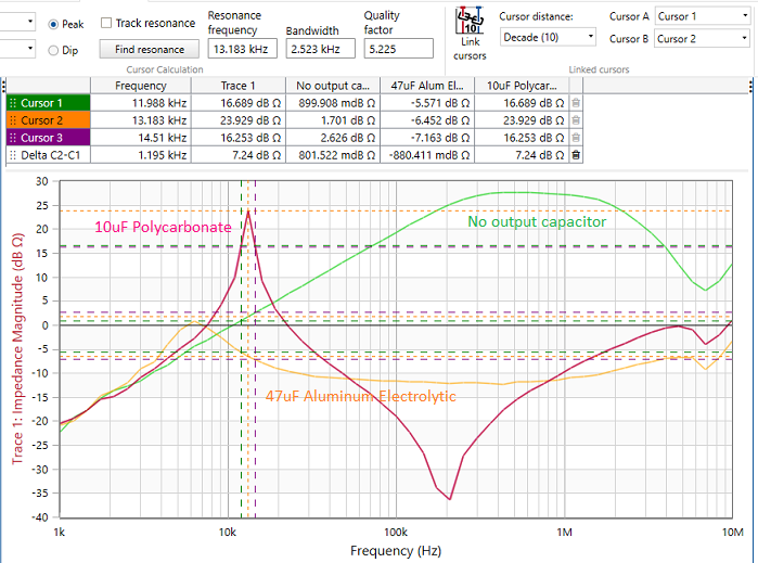

I've been experimenting with DMOS since SY got me started with "His Majesty's Noise" RIAA preamplifier.
It seemed to me that one could self-bias a DMOS and use it as a current sink. Sweeping from 10Hz to 10MHz and measuring group delay, you can quickly determine whether the power supply/regulator is stable.
The IXYS IXTU02N50D has Ciss of 120pF. The gain plot uses IXTU02N50D, not the DN2540 shown which is 200pF.

Here's an example, if a bit extreme -- an LM317 for which the DMOS current sink is drawing 24mA. A 47uF Panasonic Aluminum Electrolytic on the output pin (brown-orange trace) is close to being stable but a 10uF polycarbonate (violet trace) isn't.
Q is over 5! No output cap on the LM317, it's stable but the impedance stinks.
I used an ancient Tek P6022 current probe with 134 amplifier for the current measurement. The 6022 falls off below 2kHz so the curve was standardized to a 1 ohm non-inductive resistor.
Well, I think it's pretty neat!
In principle, you do not need to pass the stimulus through the current sink: normally, a VNA is sufficiently sensitive to make the measurement directly (unless you venture into the sub-milliohm region).
You can then use a "dumb" current sink, eliminating issues of bandwidth, linearity, etc.
Of course, the ports of the VNA need to be properly protected.....
