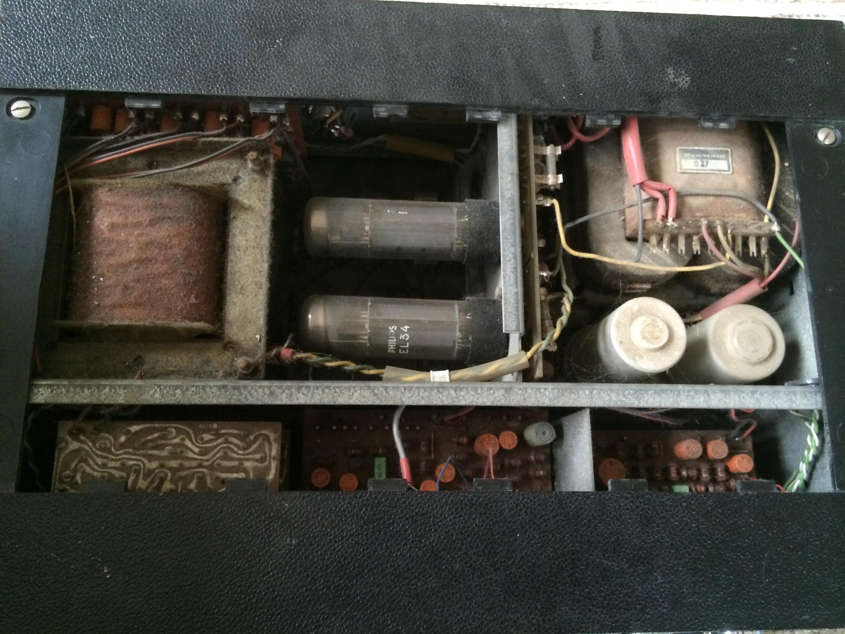

The seller told me he had bought the amp from a church five years ago, and according to him and his knowledge concerning the amp´s history it still has the original power tubes in. Said they´re pretty noisy too so I´m guessing it would be better to throw in a new set of caps too? It´s like few generations of spiders had been living there. No one´s been in for a while so I wouldn´t be surprised if those tubes were in a need of a change.
And I was planning to replace these tubes with a pair of 6CA7's too and make it as much as a same toned as the one I have now. I´m currently trying to get a deal on some 15" Eminence speakers from the 70´s to get that nice vintage vibe on my other cab with this head.
Be sure the tubes can withstand the high voltage found in the Eminent.
Most new tubes will blow...
JJ is a good choice. I use them in all my Dynacord repairs and amps with high anode voltages.
They last...
It's not because a tube is old it has to be replaced.
Caps and resistors, they are the first source of noise in these old amps that have been stored for a long time.
As said; Fix nr one and then begin nr two.

The Eminent 2T has a lot more electrolytic caps to be changed: look at all the orange parts in the preamp section. It also uses stabilzed voltages in the power supply - again full of electrolytic caps.
But first and beforemost the tube section must be restored. Electrolytic caps as mentioned (btw: Jan Wüsten's 100µ+100µ works well in the position of the 100µ+50µ and is cheaper (larger capacity is better unless it is too large)).
One of the caps is isolated. That isolation must be retained: the cap is on a base potential of about 400 V, and that's the voltage of its outer surface against ground!!
The small electrolytic cap C401 at the ECC81 also needs to be changed.
Use "upright" Piher PT15 trim pots to replace the flakey original trim pots. A small defect my destroy not only the EL34s but also the output transformer. And that is a part of 100 € (Welter electronics has them). If there is a fuse of .125 mA installed in the bias circuitry - that one needs to be removed and bridged. A loss of contact/break of the fuse will have the same effect as both bias pots breaking at the same moment!
Biasing: the 25 mA (0.3 V at the cathode resistors of the EL34) is a bit too hot for EL34s at those voltages. I bias these amps at 0.21 V, and they still sound good. If there is flashing in the tubes of an otherwise restored amplifier clean the sockets (after unloading the electrolytic caps through a 47 kOHm/11W resistor)

Done and done, man! Well actually just done, since I still have the other model to go through. And that one is somewhat different from the inside.
In this 1967 model I set up brand spanking new set of JJ 6CA7´s. Pulled out the electrolytic caps in the output and ECC81/power tube department and replaced them with F&T caps with proper voltage ratings. Also changed the bias trimpots and the cathode resistors to pair of new matched ones. In the circuit they measure 12.6 Ohms and 13.6 Ohms. So I did my math and got the bias to about 17.4mA per tube. I went by the book on that one and set it pretty close to the 70% of max plate dissipation.
Also I got pretty close readings in reference to the schematics when I measured around the OT and the tube sockets and after consulting a guy that knows about these amps got the information that the big filter caps weren´t actually original and leakage measure ok, so I didn´t have to change them just now to get the amp running again. But I will change them when I get the money.
