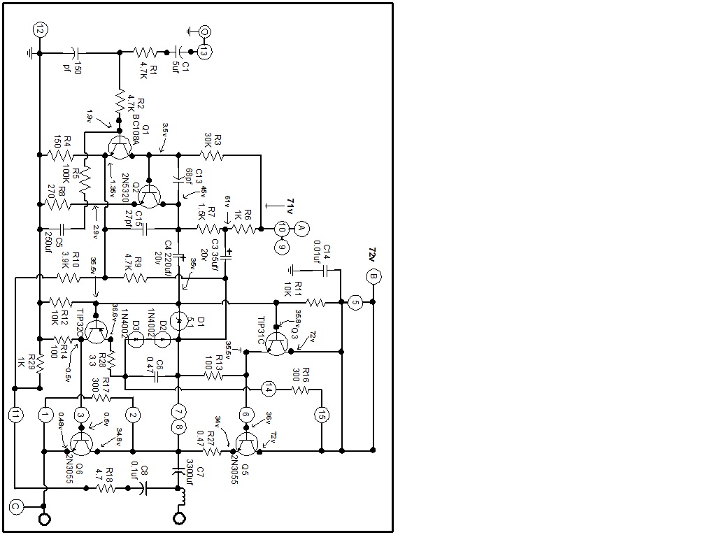

C8 and R18...if either opens up, the amp won't be stable, although it may only show up when driven hard...the ultrasonic oscillation causes simultaneous conduction, and the amp eats itself. A sure hint is it R18 has burned open!
Also...the big 300 Ohm 5W (7W?) resistors often eventually open up...

First things to check...voltage across C12...should be 72 Volts.
Voltage on positive terminal of C7 (both) should be about 36 volts.
If both are far wrong, then you've got a good place to start.

Just in case that it may help any one fixing Dynaco 120 amplifiers attached it is the schematic of the Dynaco 120 driver board showing all the reading voltages from a good working amplifier. Also for you information you can replace the 2N3055 with the 2N3442G transistor. It is a 140 volts and the sound it is as good or better than the original 2N3055. Hoped this information can be useful for those repairing Dynaco 120 amplifiers.
Also attached it is one of my Dynaco 120 rebuilt.
