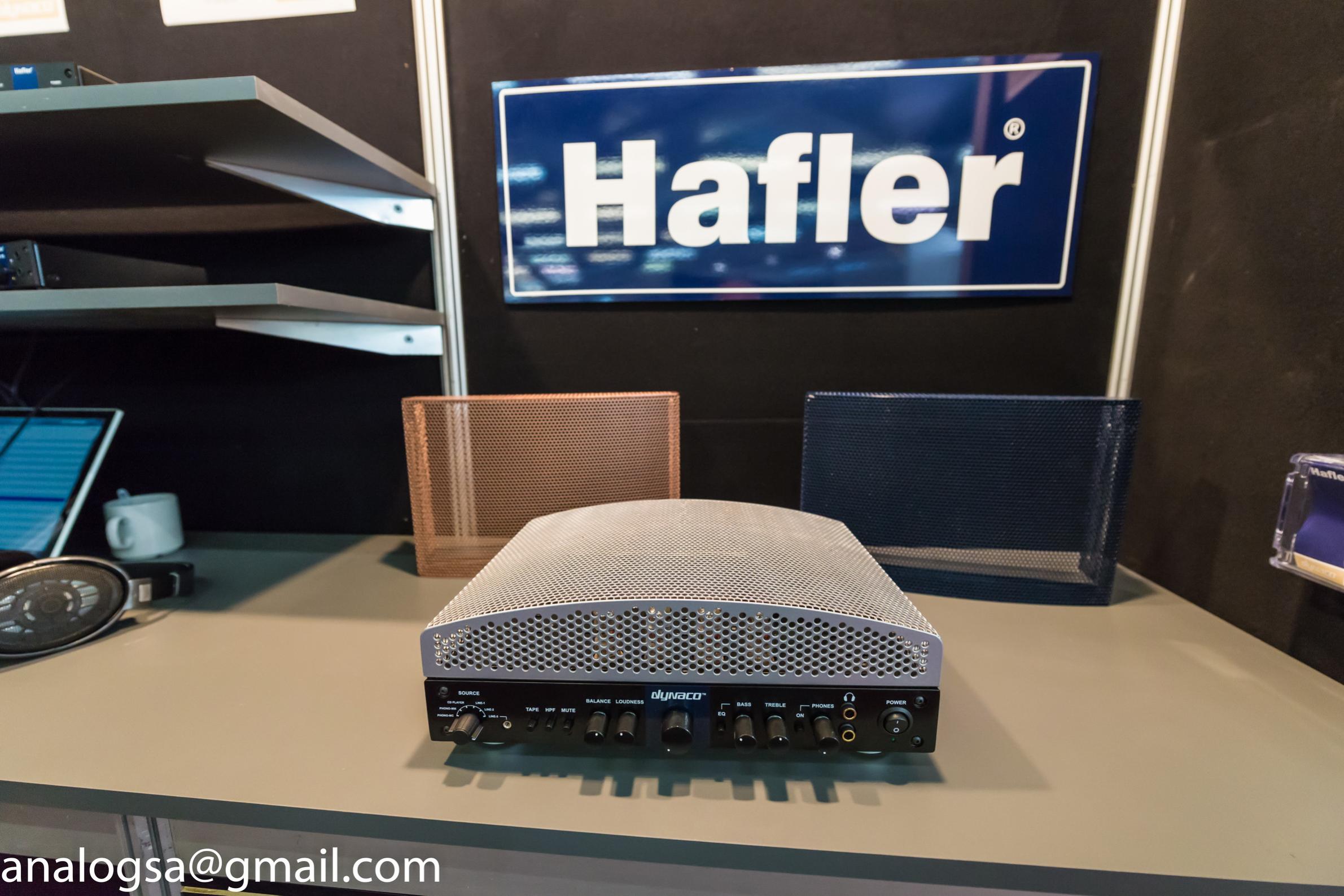

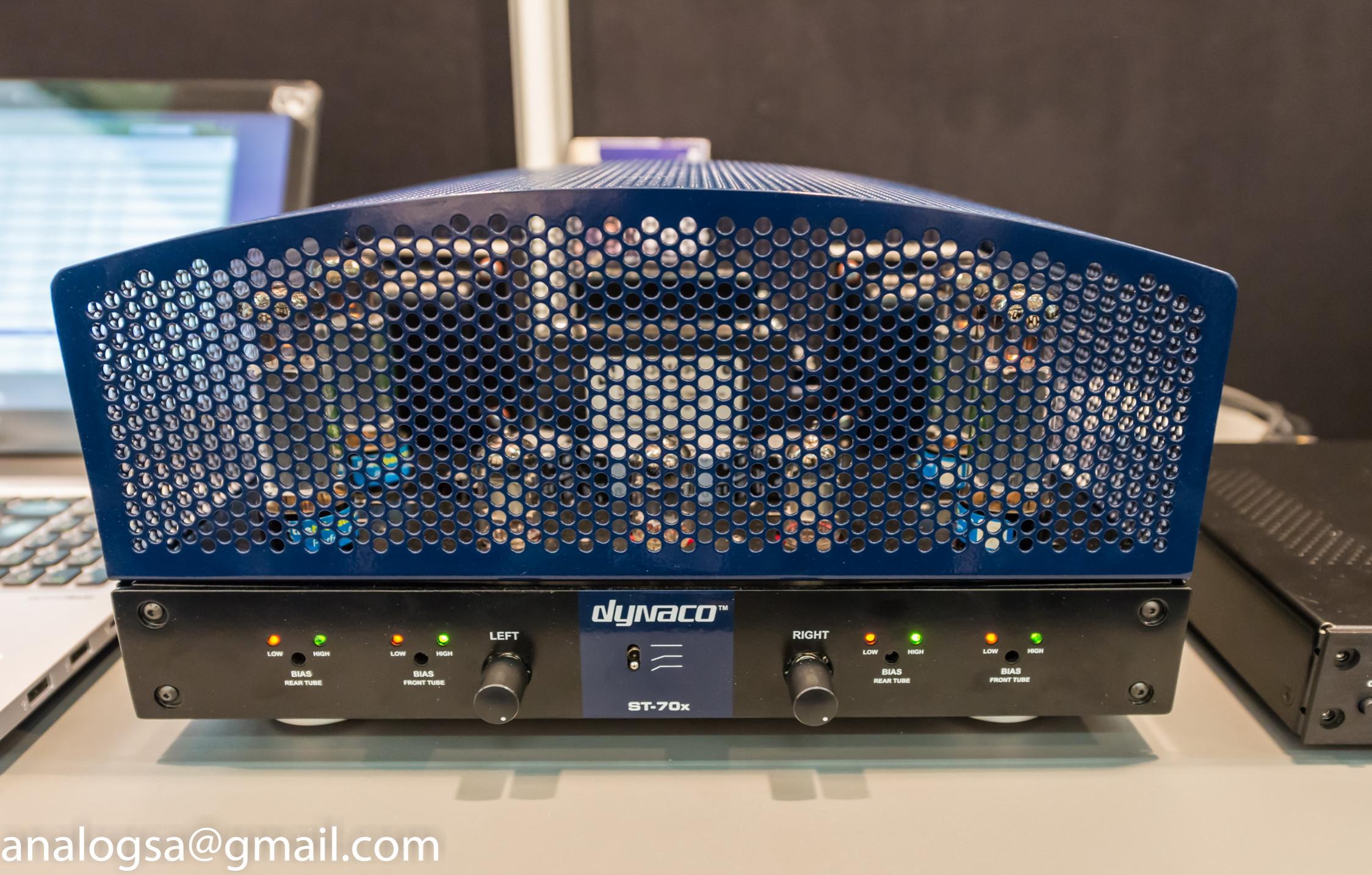

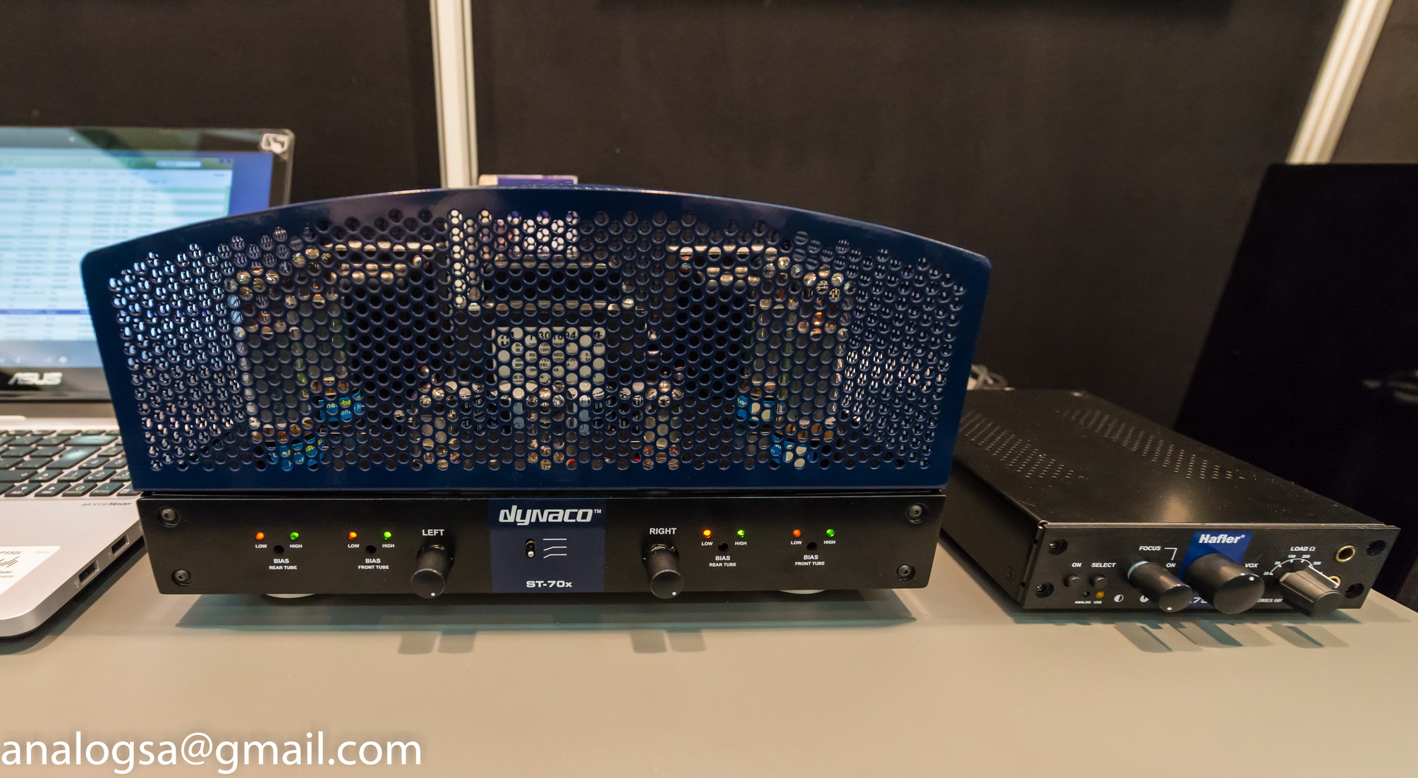

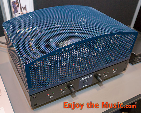

World Premiere! Hands-On Review Of The Dynaco ST-70 And ST-1 -- HIGH END 2016 Munich Audiophile Show Report
-> Radial Engineering Ltd.
Radial Engineering Ltd., which is the parent company that owns both the Hafler and Dynaco nameplates, is no stranger to audio. Have been keeping an eye on them for quite some time within the professional audio mags i read. They have been producing pro audio products for quite some time and is now (finally) concentrating their efforts to such classics as the Dynaco Stereo 70 vacuum tube amplifier...
