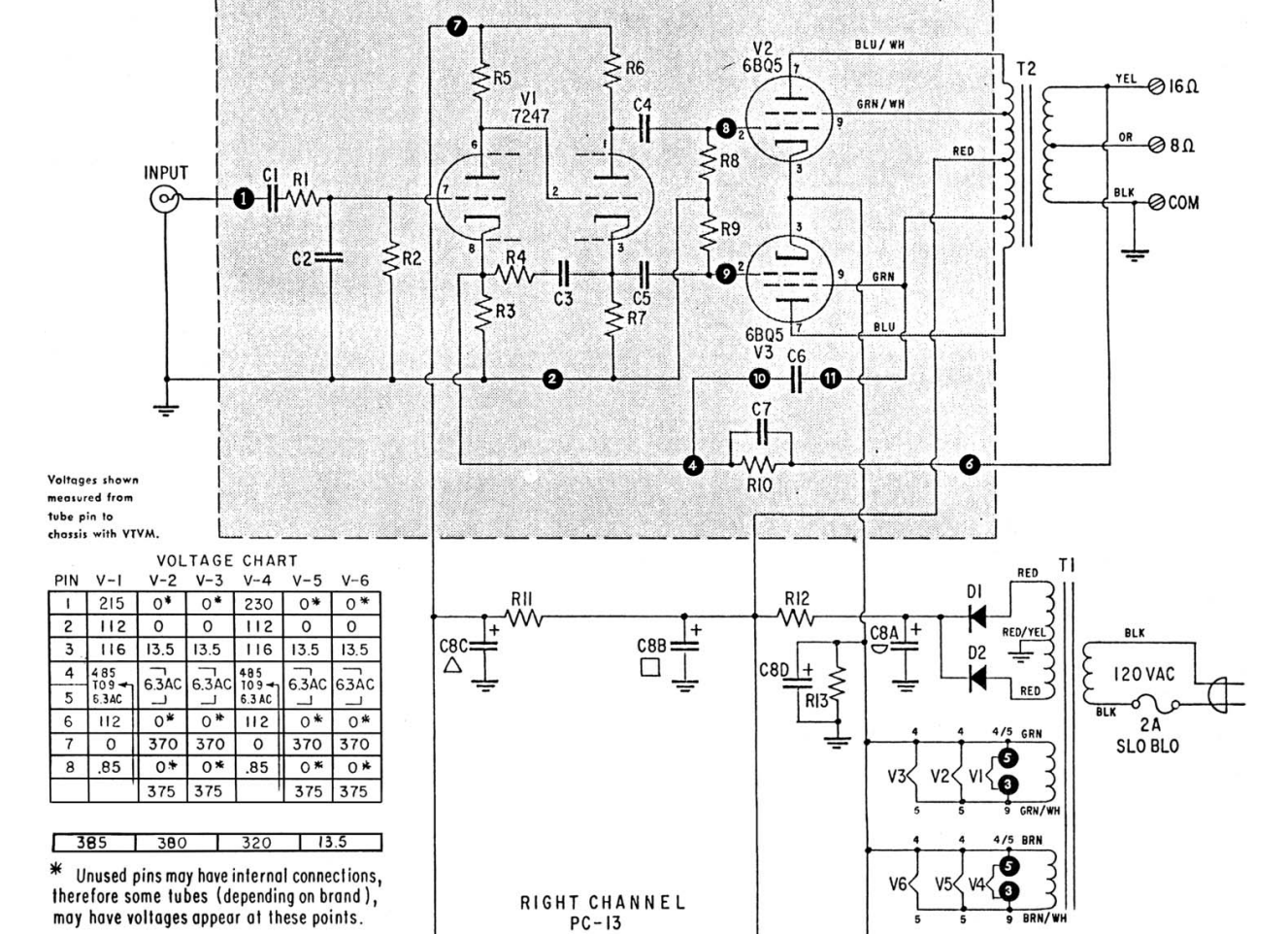

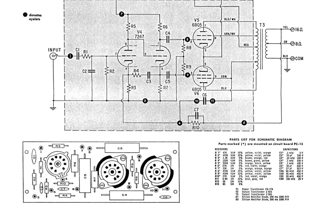

Hello guys. I had the opportunity of listen to one of these amps the other day and loved the sound. I want to build one and have the output and power transformers as well as some new EL84 that I can use.
I assume everybody is familiar with the schematic but I include it here for quick reference.
My question is: I want to use an ECC83 in lieu of the 7247 because I have several Ecc83 and 7247 is hard to come by and expensive in my neck of the woods.
I am aware of the second triode of the 7247 having a gain of 20 as opposed to the 12AX7 triode which would be 100.. It is safe for me to assume that I can adapt R6 and R7 to lower the gain? What other changes will you recommend?

There is no way you can replace the 7247 with ECC83.
But, 7247 is a selected variant of 12dw7, and those are in no way scarce. In
addition there is also new production : ECC832 from JJ.
As you will spend quite some money on other parts , don't sneak out on one of the cheapest part of the amp !

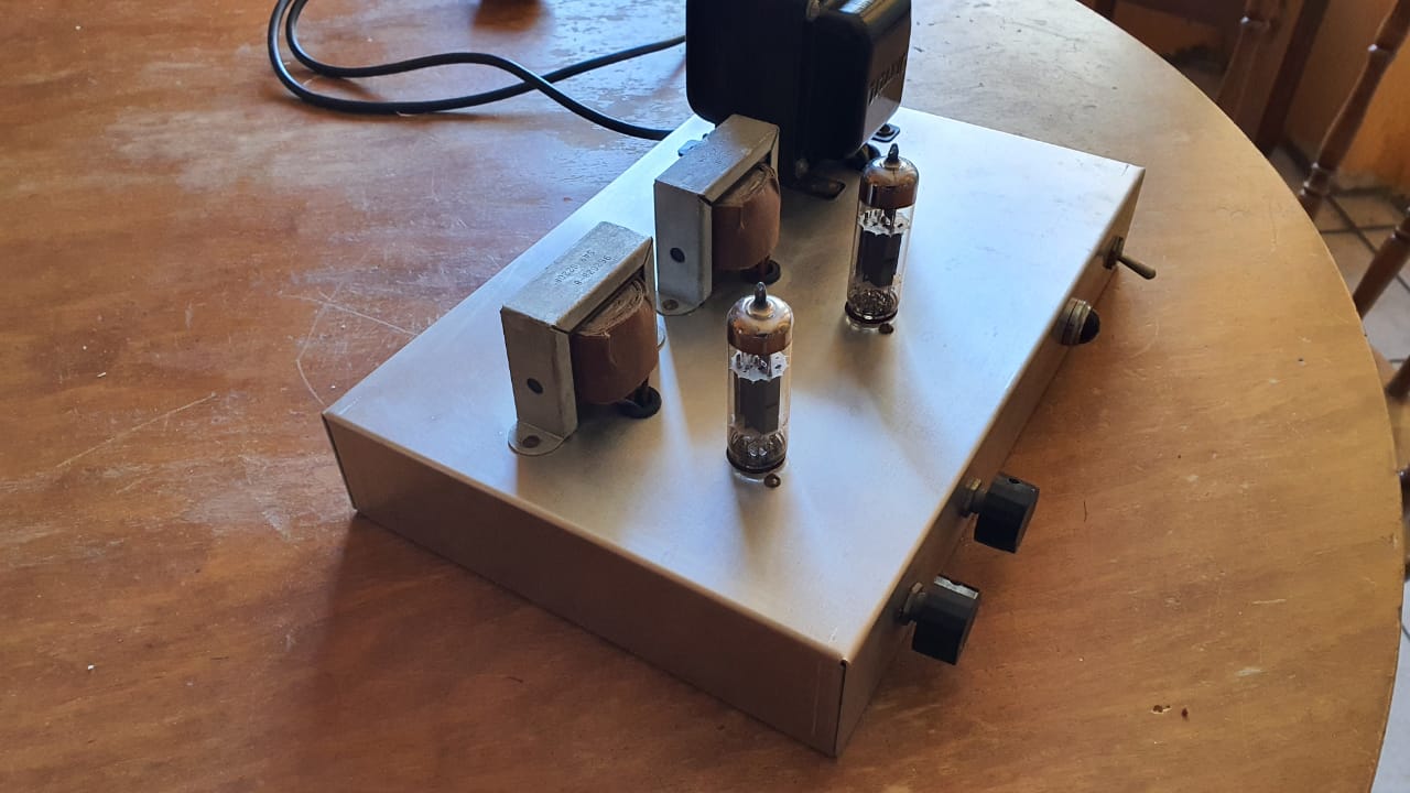

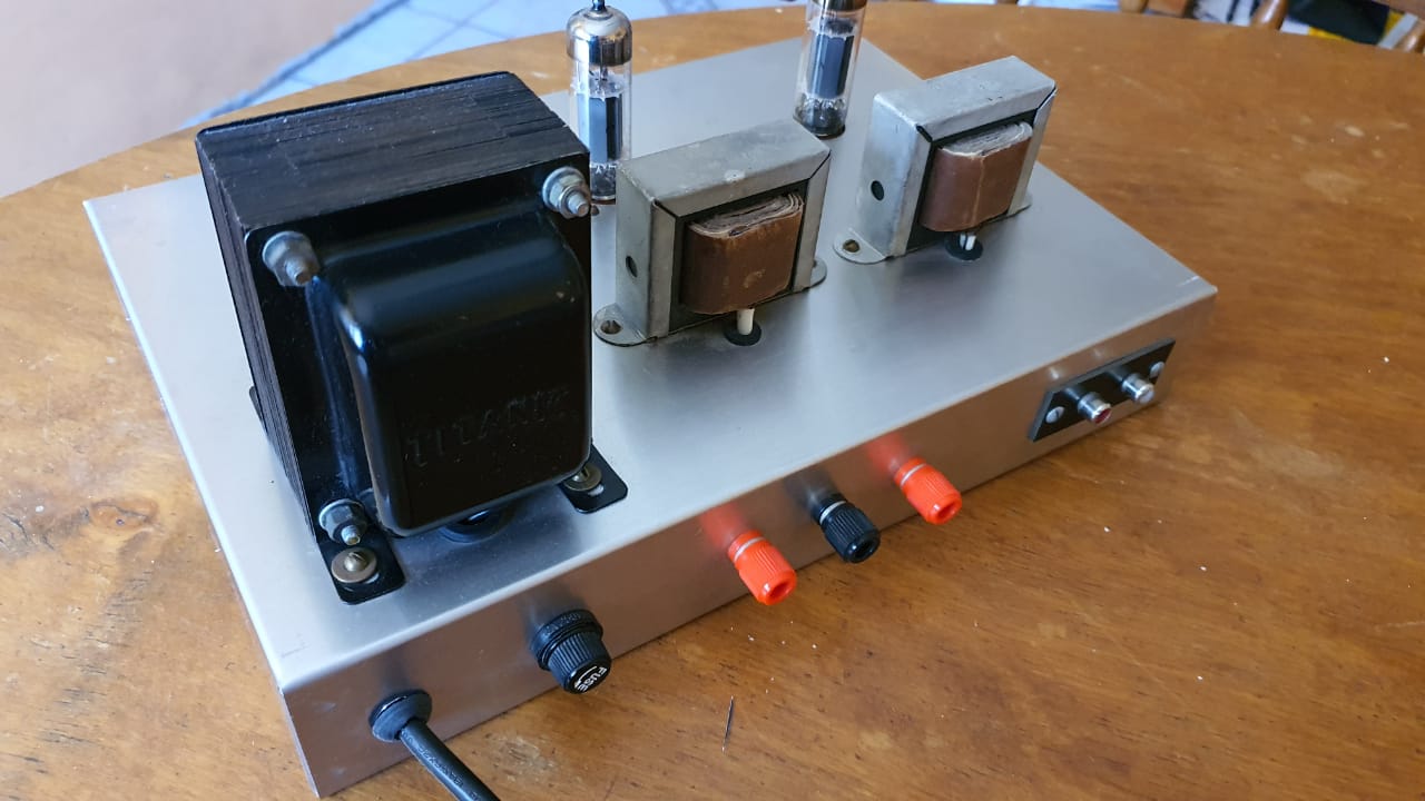

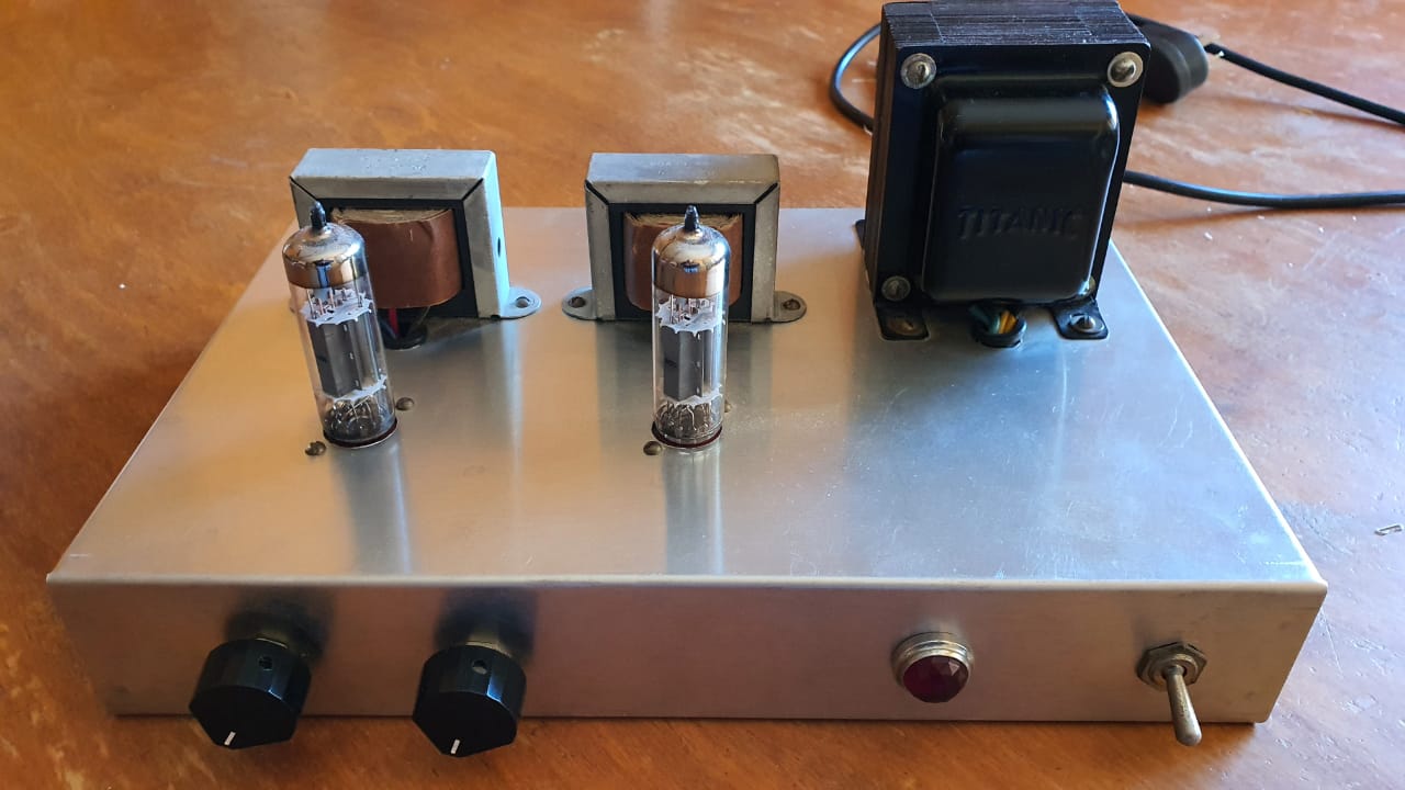

Thank you 6A3summer, here are some pics of the second tube amp I built, it is stereo with the ECL82 tube and uses a couple of Hammond Organ transformers with hum taps that I bought from the late Gary Schneider.
This is a fantastic sounding amp. I used the typical schmatic for record players and it sounds great. This amp was a birthday present for my nephew who is also an electronics enthusiast.
Now onto the PP EL84!!

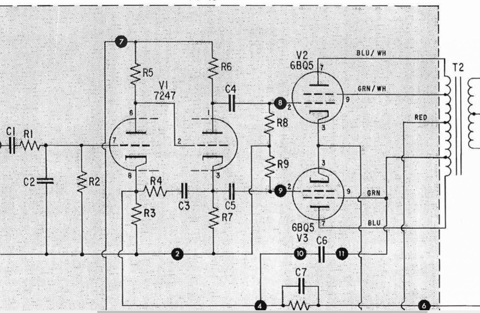

I see this circuit runs with +370V on the plates, 375 on the screens due to the UL taps. Isn't this too much for the Electroharmonix and JJ EL84? Manufacturer of course mentions 300 as limiting values but I am never sure whether this is for designers or if actually affects tube life.
As you can see on the circuit, Vk is noted to be 13.5V which for a 95 ohm resistor comes out at 142 mA total for both channels (all 4 tubes), so if I do 35.5 mA for the plate voltage which is 370 volts, I end up with a 13.1 Watts for the plate dissipation, or slightly above the maximum dissipation of 12W... I can't make sense of this..
I have no reference on this circuit on tube life, and since I have a 180V tap on the power transformer, I can also try to lower B+ to under 300 (changing some components) if worth the effort? This amplifier I am building it for my brother and will be used for weekend audiophile listening.
Any feeback is appreciated. Thanks in advance
Mario

Yes, you can put a 12AX7 in that hole. No changes. The driver stage runs unity gain. The 12AX7 is hot enough to pull two 30k loads series.
Yes, you can run EL84/6BQ5 considerably past the 330V and 12W in the specs, unless they are very expensive or hard to replace (dog-sled to the north pole radar station). Who wants to live forever?
That's what I suspected since this circuit has been around for such a long time. I was concerned that newer tubes are not so resilient, thanks for the good info.
The plate to cathode voltage is not 370V and the plate current is not 35.5mA.
There is screen current.
There is cathode voltage.
Oh yes, right! Thanks, doing the calculation with 356V and 30mA I have 11 Watts and less than 1W for the g2
