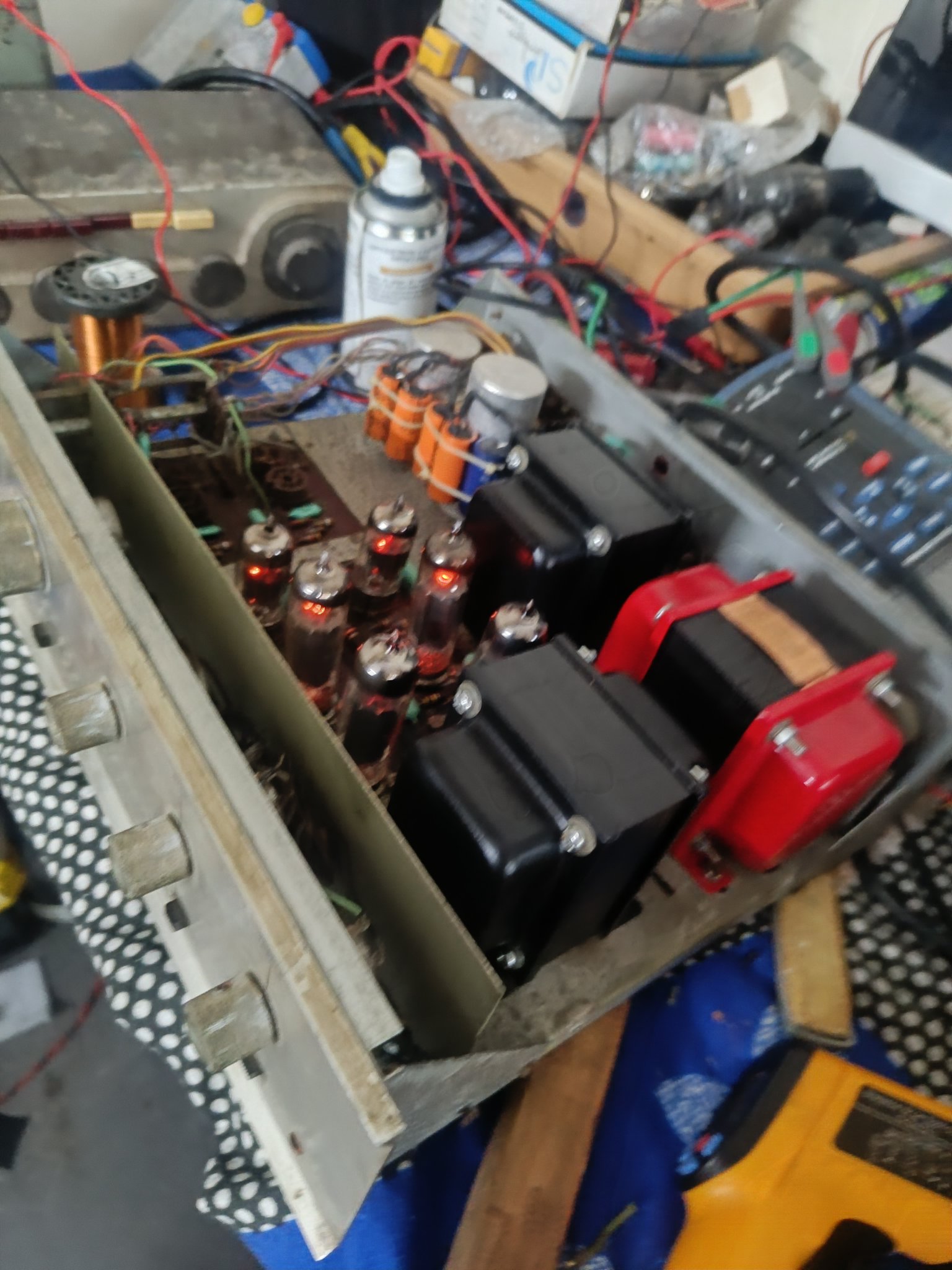

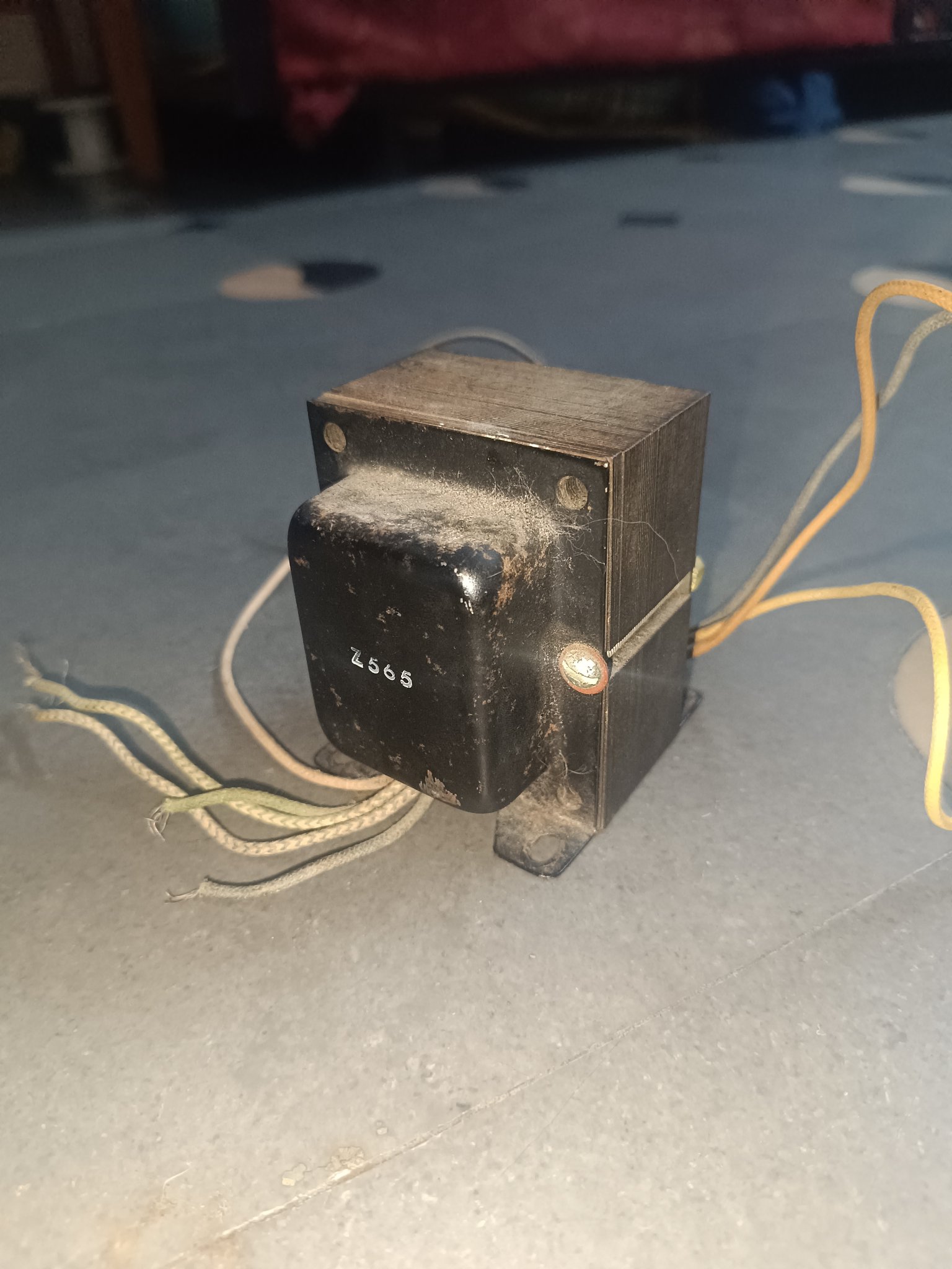

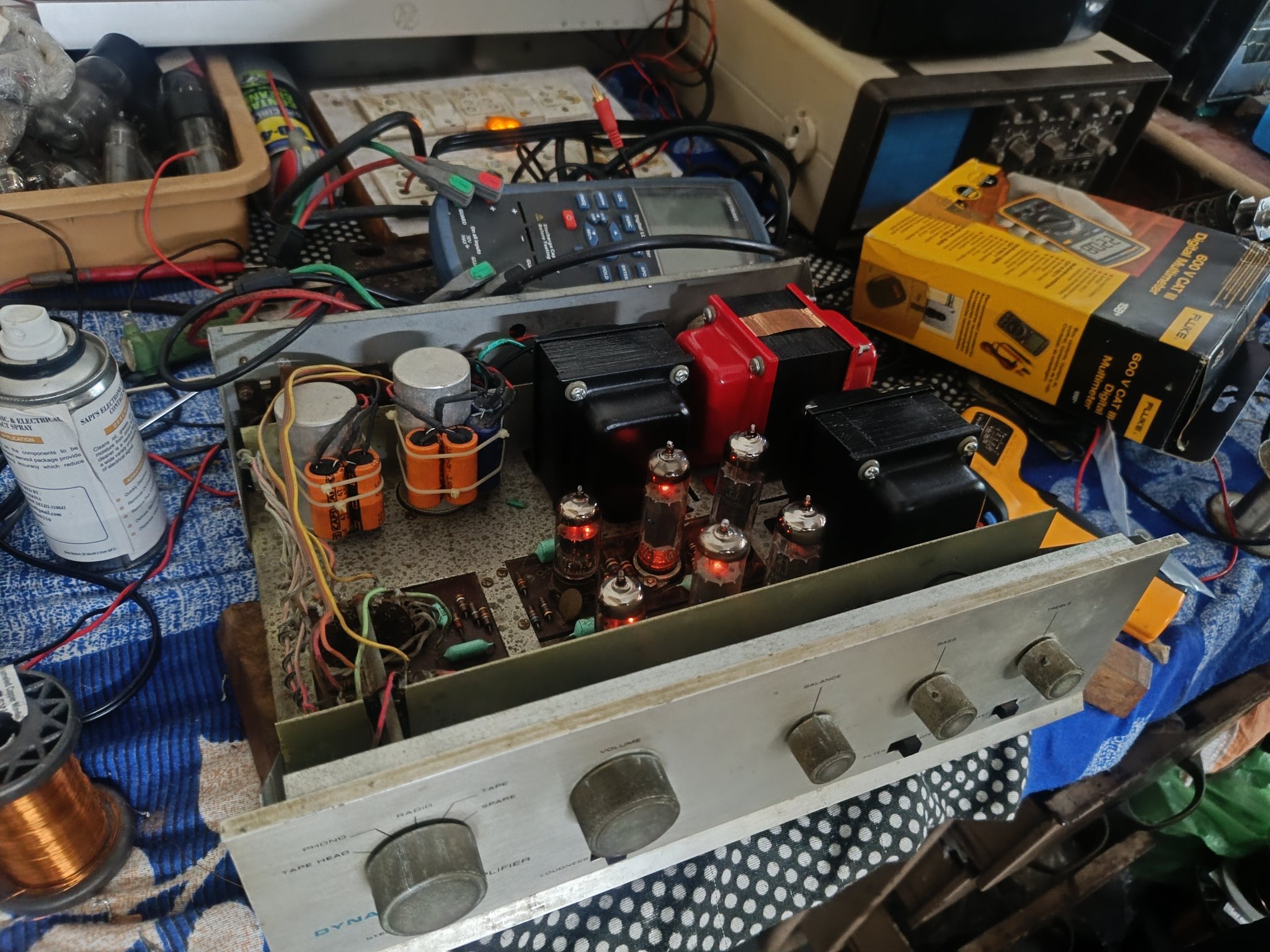

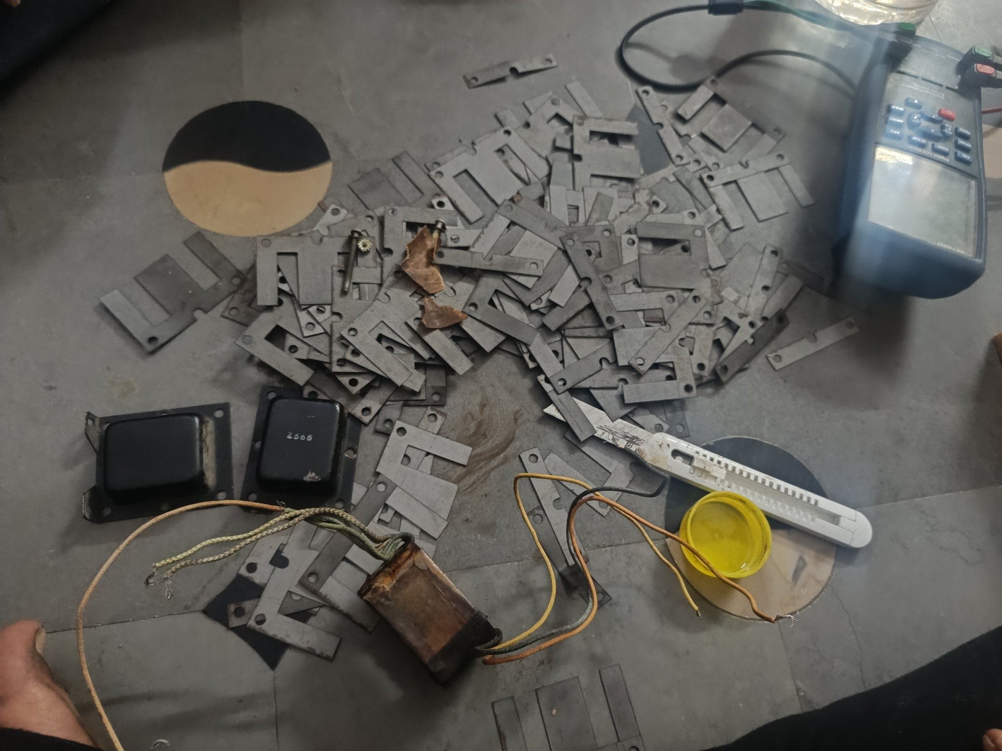

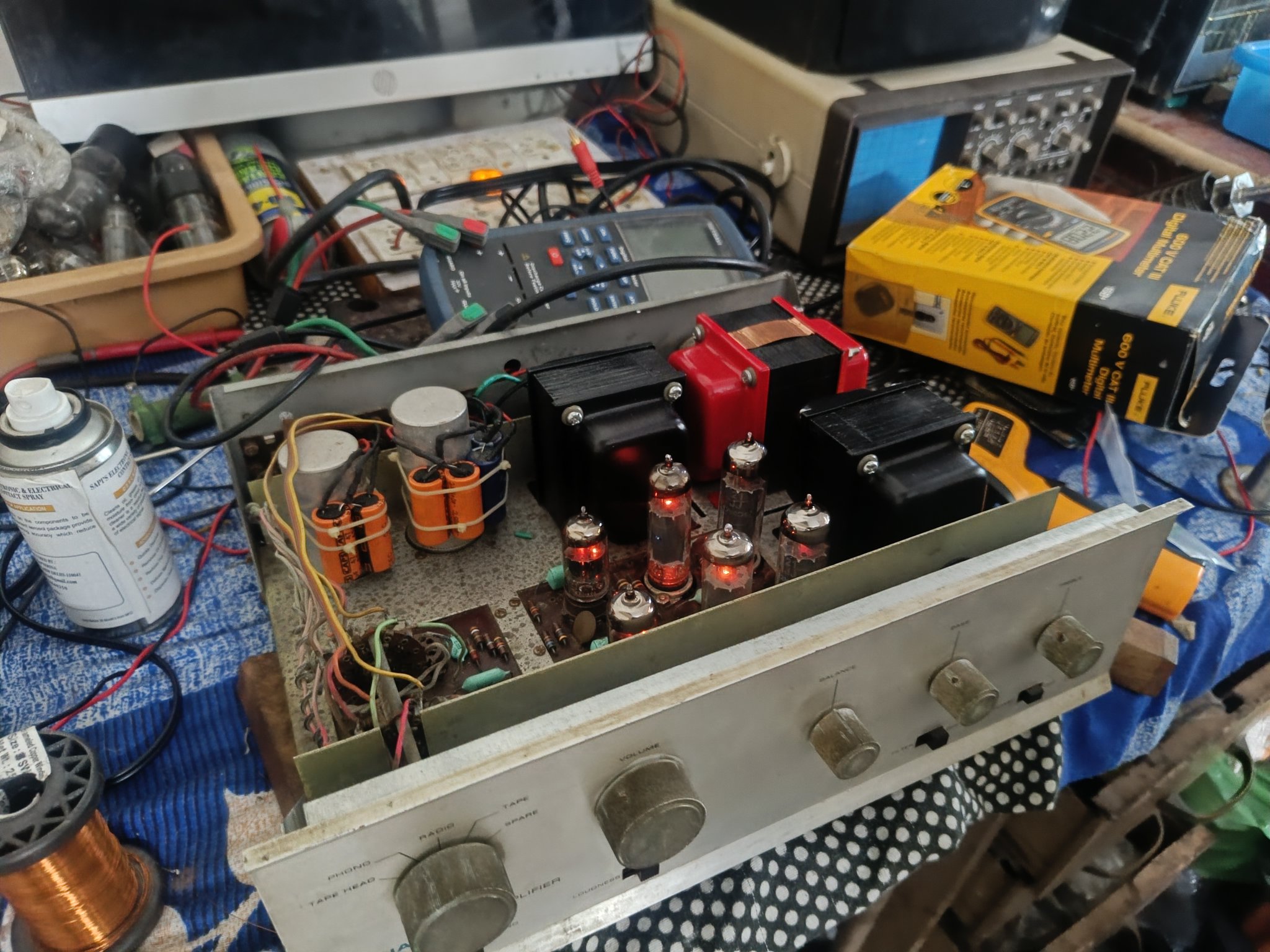

Hello.

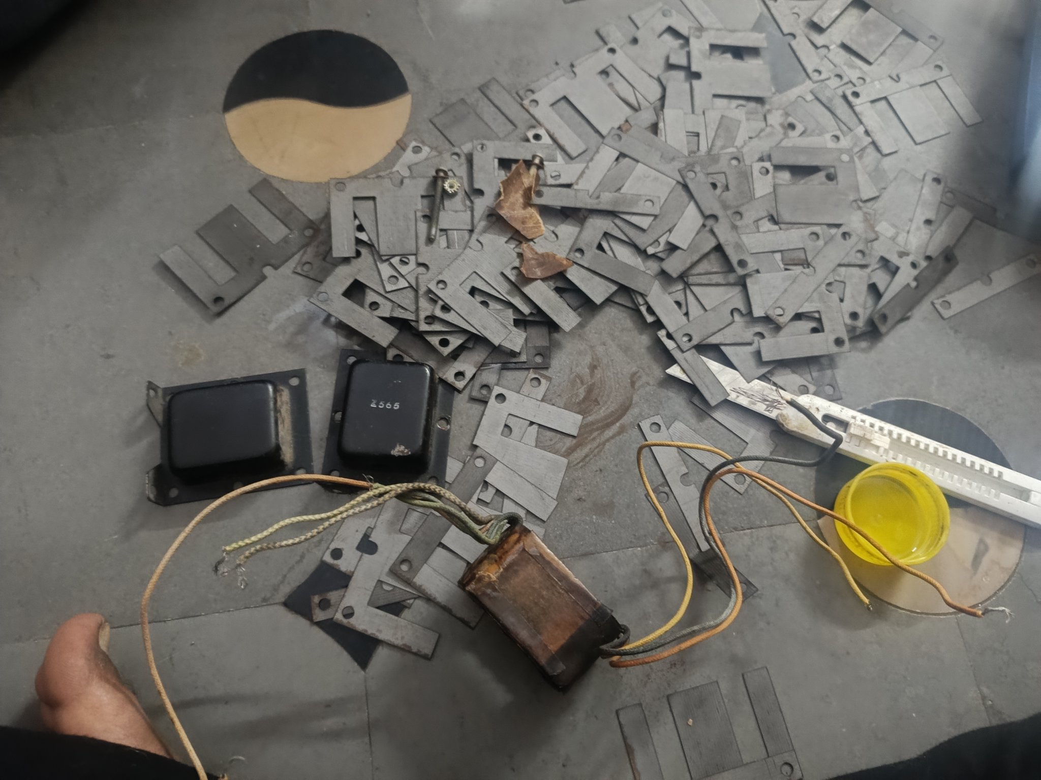

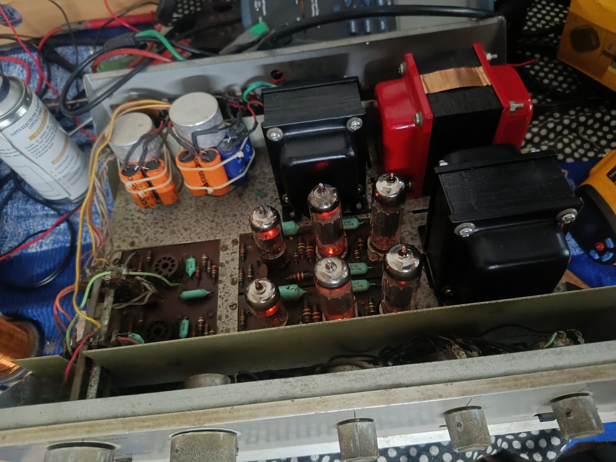

Last week I got one dynaco sca35 amp for restoration from my uncle @analogadikt
One opt was open he requested me to make a drop in replacement for this amp and i was also interested to make dyanaco opt z565 clones I opened the orignal opt and got all the geometry of winding the the amplifier was in working condition but one channel was not working because the output transformer was bad and then I made a pair of opt for this amp .as we make output transformer under the guidance of eletraprint audio(jack elliano sir) and( bud purvine sir) of o-netics they both are my guiders and big supporters i always thanks for them .
So finally after researching a lot for z565 i made exactly z565 opts the winding was really interesting and complicated too and now amp is working perfectly.all photos i have attached here thanks.

Great work, Asnain.
For the sake of documenting at one place , here are the other similar efforts containing some great information on the Z565's unique winding, by Richard Hughes (retailer/familyguy) and Stanko - also look at David Hafler's patents

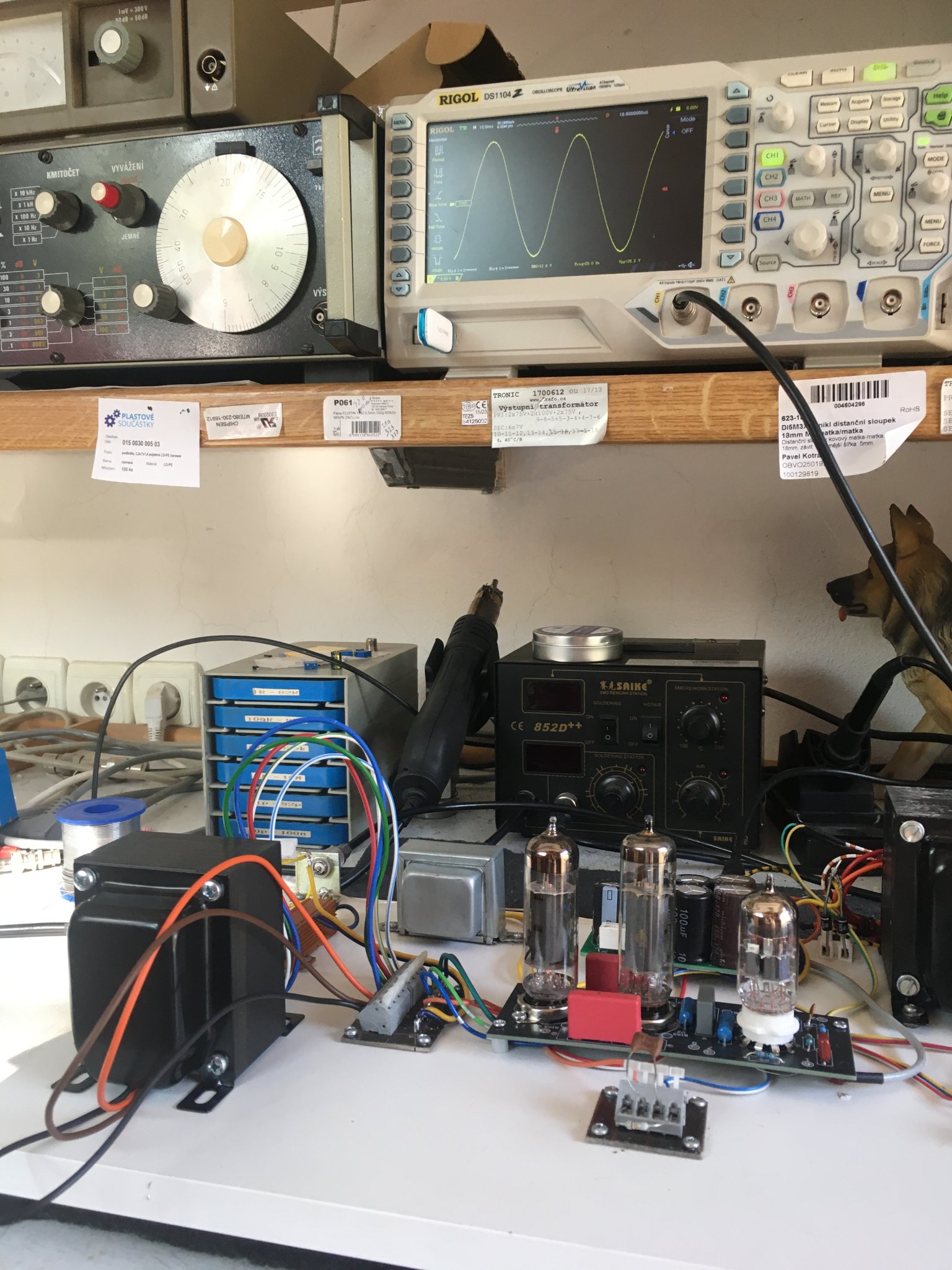

Let's create this thread with the same purpose as the tube photo gallery thread, but about transformers. We can show off pictures, measurements, explanations, etc, mostly for fun and potential sharing of knowledge.
I'm starting with my most recent project of freshly wound coils, that are specially made for SE high Rp output stages with Rp ranging from 10k to 24k in series primaries and 2,5k to 6k with paralleled primaries.

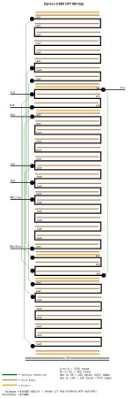

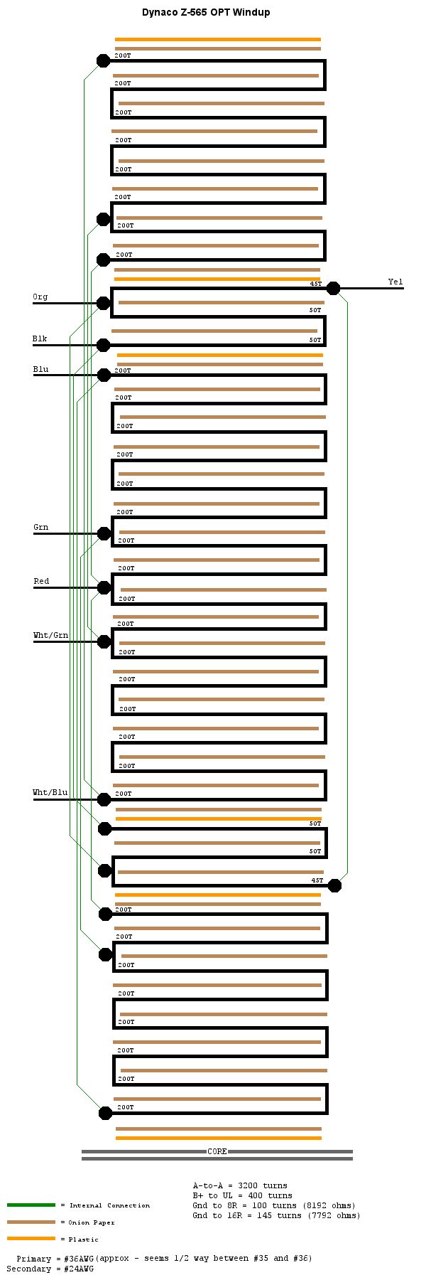

Do have a winding diagram of the Z565 OPT, as you unwound it - I would be interested in seeing it.
Yes that is the one that has been around for quite some time - just wondering what forum member Kolarkar found when he unwound one, was it the same ?

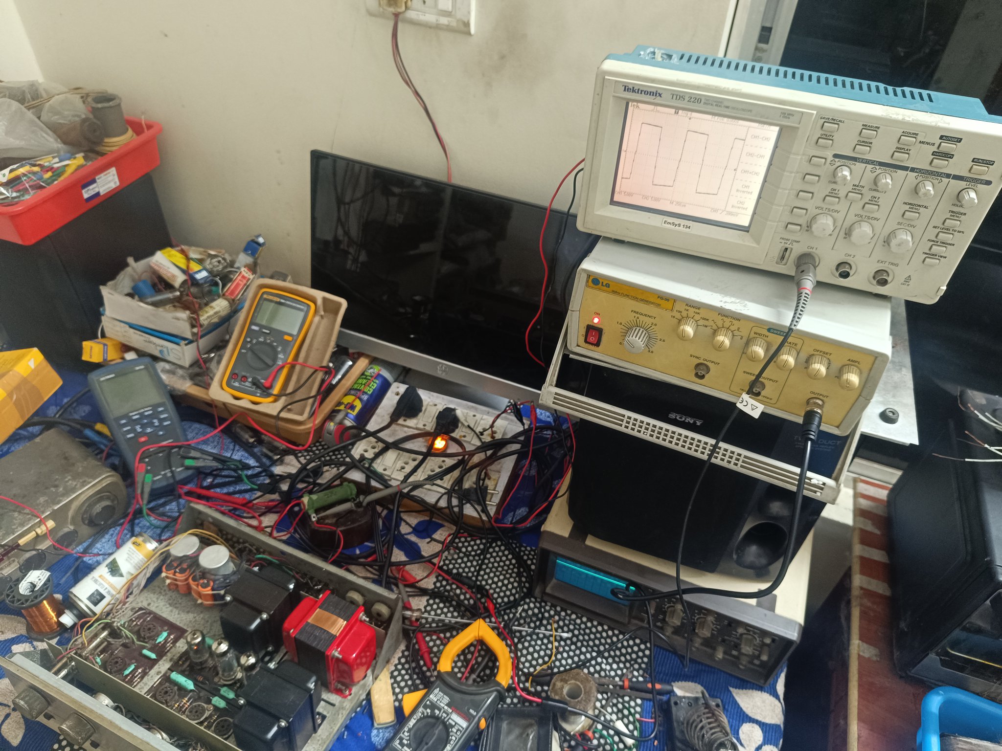

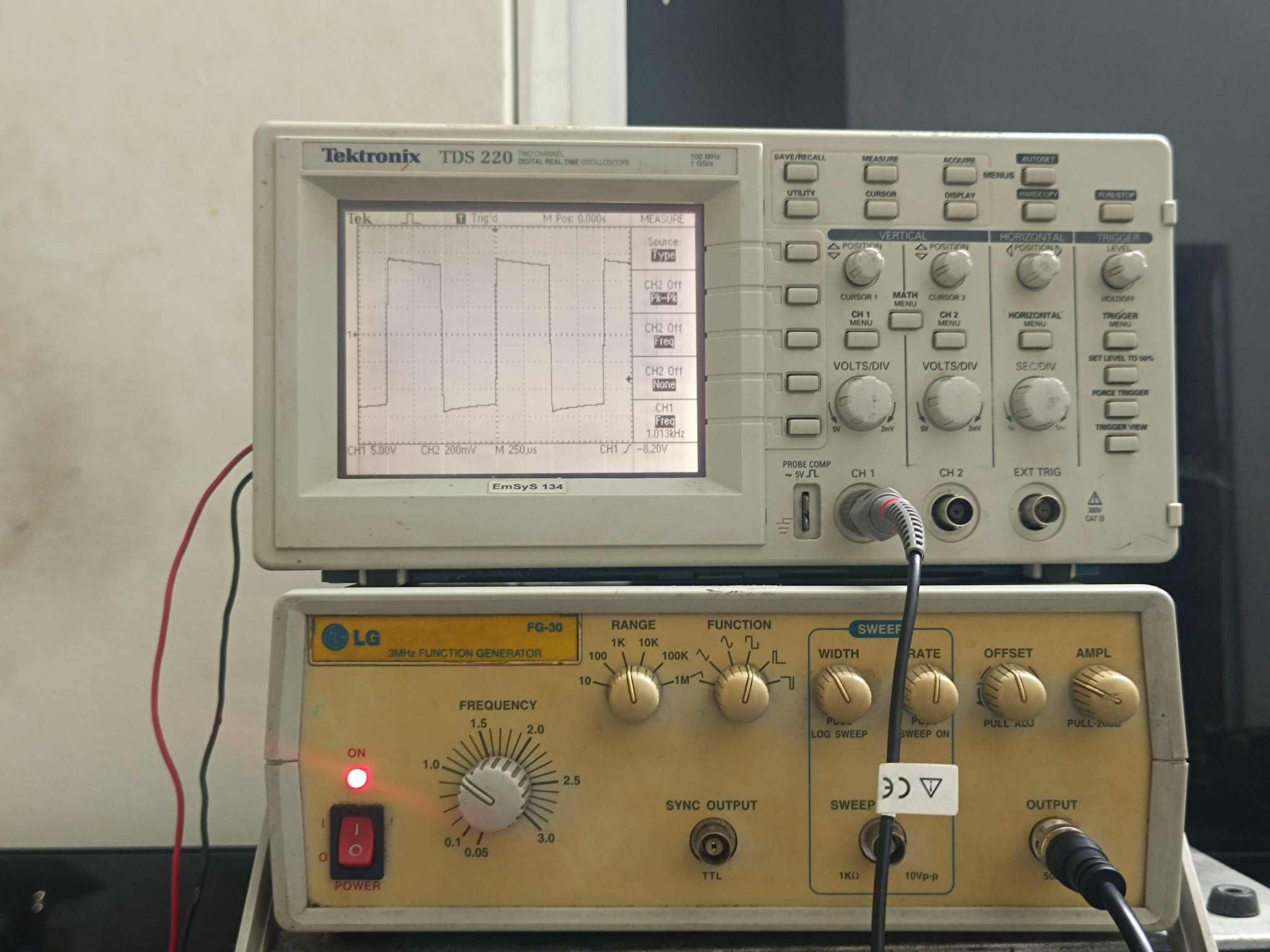

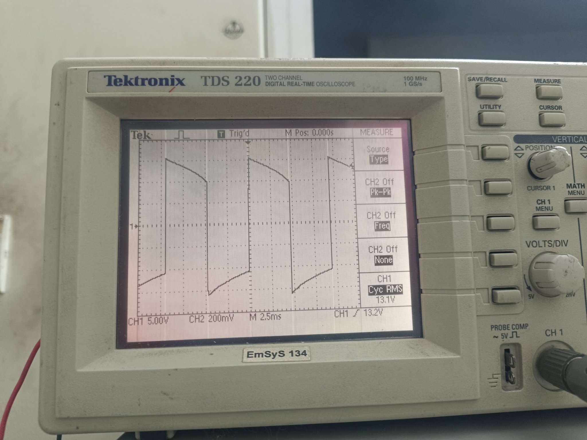

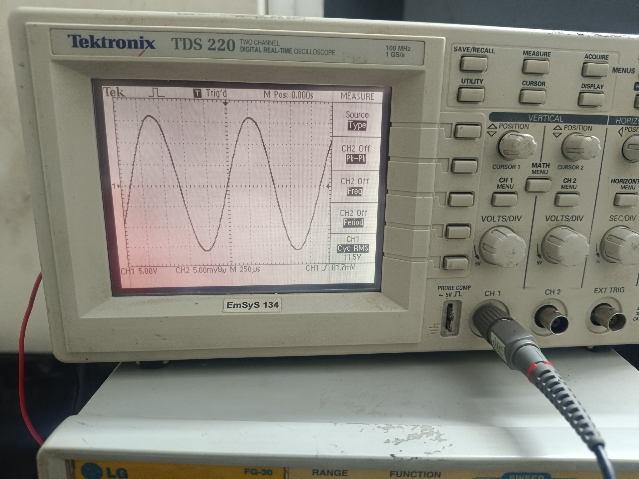

Done some testing of my newly made z565 clones .... Here are the results
Yes the digram is perfect i used same turns same winding arrangements just did some on work leakage capacitance and inductance to match the orignal.... specs using nomex 418 insulation....Yes that is the one that has been around for quite some time - just wondering what forum member Kolarkar found when he unwound one, was it the same ?
