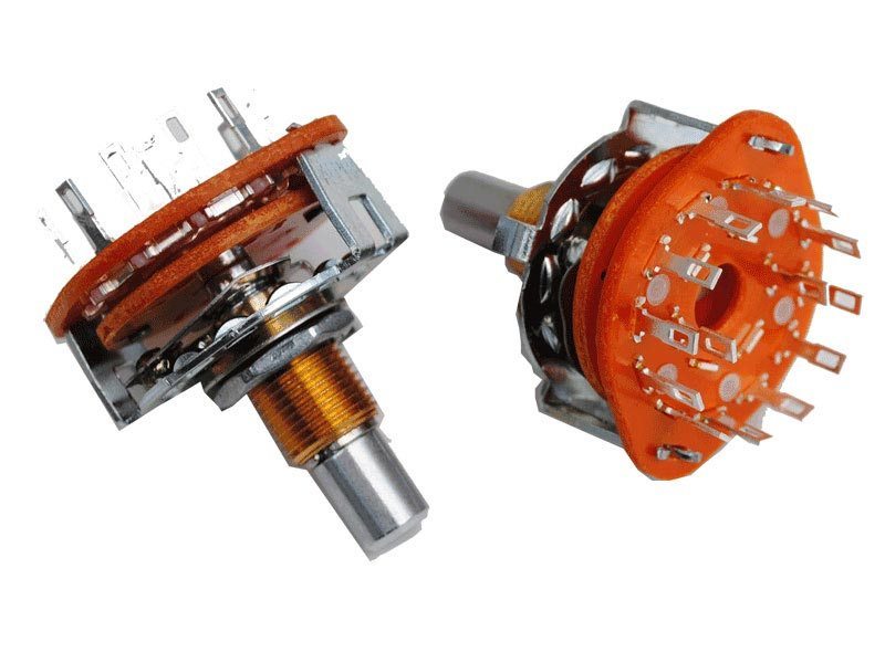

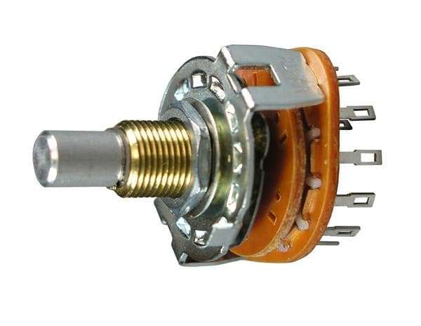

after removing the pc boards and selector switch from the pre-amp, I now see what everyone has been saying about the quality of the PAS components. The chassis is extremely thin metal, it flexes with very little finger pressure. The 6 position rotary selector switch is so fragile, all of the "ears" that make contact with the plates on the wafers are loose.
There's not much I can do about the chassis, (maybe add some stiffeners?) but the rotary switch needs to be replaced. I don't feel comfortable rewiring the entire preamp only to have the selector switch fail at some point. There are ALOT of wires soldered to it.
So I'm looking for a replacement.
Dynakit Parts has this one for $7.00
