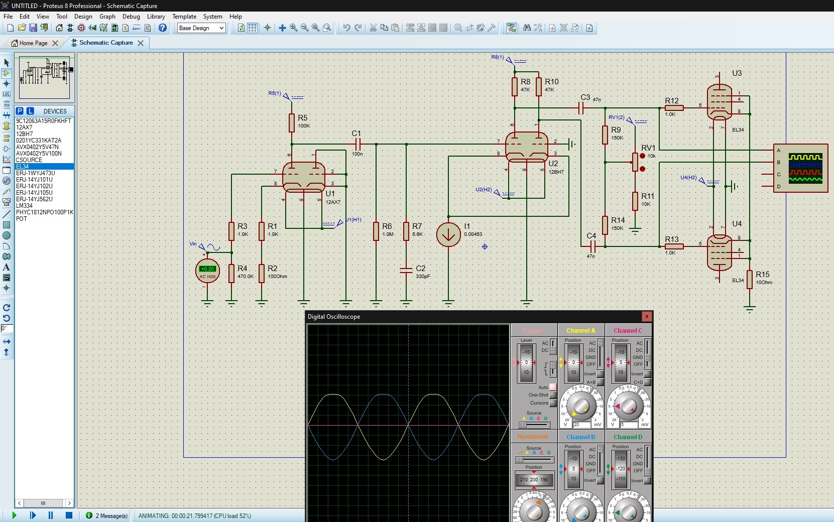

Something wierd. I tried to simulate this circuit in proteus, just for a test. Does it has big gain? Bacuse when I set input level ~200mV rms, it starts clipping.
I posted the same in #65 😉
In this ST70 driver, do I really need DC balances? (500K pot with 1M to ground). Maybe can I tie cathodes together, use one cathode resistor and make a led right bias indicator as in ST70 Series 2?
If we are talking about Dynaco, there is no need for DC balance as Dynaco uses a concertina phase splitter
The above uses a LTP which is inherently AC unbalanded ( usually compensated with AC balande pot)
DC balance is most likely taken care of with the ccs in the cathode circuit.
So an LTP with a CCS is AC balanced as the delta current going up one leg is the negative of the other as no current goes flow though the grids. The DC balance may be off as the valves are not matched. The can be corrected with a trim pot in the cathodes. Degenerating the cathodes also reduces gains if you have too much.
You mentioned connecting the EL34 cathodes together. It better to have separate cathode resistors so you can measure bias current in each. It's also important they are not too watty. You want them to blow and go open if the valve develops a short rather than damaging the OPT. It also better to have separate bias pots as these valves are often not as well matched as you might hope. This can affect the 2'nd harmonic distorsion.
AC balance is off since amplification ( mu ) is not infinite.
It is with a resistor tail, but with a CCS the delta current in one arm is exactly the opposite of the other as the total has to be equal to the CCS. No current goes to the grids so if the plate resistors are equal the delta voltages also balance.
That DC balance pot is for balancing the current in the output tubes, not the phase splitter.
