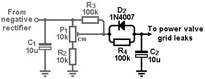

Be sure to check the value of the 6550 g1 resistors.
For fixed bias, the g1 return is supposed to be 50k Ohms or less.
I once had a red-plated 6550. It was caused by fixed bias, and the unusually large resistance of the g1 return resistor.
Changing the resistor to 50k fixed the problem.
No problems with bias as I have implemented in many different tube amps with this bias charge mod.
Idea came from: The Valve Wizard
I have a Fisher and Heathkit 6L6GC based amp with this bias scheme, even a Rogue Magnum 120 that was cathode bias id modded this way...
stereohifi,
That is a good bias network . . . except that it is about 100k to ground.
The 6550 g1 sees > 100k from the bias network, and then you have to add to that the g1 grid leak resistor.
If the g1 grid leak resistor is 100k, then g1 sees 100k + 100k (200k to ground).
That is 4X more than g1 requires . . . 50k to ground.
Your tube mileage may vary.
6L6 max g1 resistor is 100k, 6550 max g1 resistor is 50k.
Those bias network values do not meet the requirements, because nobody uses 1 Ohm grid leak resistors (no driver wants to drive that).
If your driver stage can only drive higher resistance g1 grid leak resistors, then use cathode self bias on the output tubes.
That raises the max g1 grid leak resistance up to lots more than fixed bias max g1 resistor.
> it is more than 100k to ground.
When diode conducts it only adds a few K ohm. And on first glance, any "dangerous" shift of grid voltage will forward-bias the diode. So Merlin suggests.
There's also no clear reason the 100k can't be 10k.
That added network may be more relevant in Guitar Amplifier. It catches a sudden turn-off/on sequence. That does happen on stage as cords get tripped; maybe not so much in domestic hi-fi.

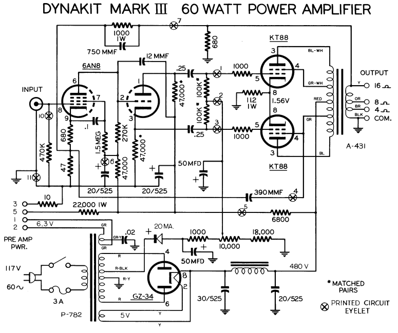

Dynaco MK III
If we look at a Dynaco Mk3 grid of 6550-KT88 is DC seeing 100Kohms + 1Kohms + 10Kohms pot. and 18Kohms to ground, to the bias supply.
Potentiometer might be in half position, so let's say 5KOhms
Still grid of the 6550 seeing 124Kohms.
With the bias circuit of tube wizard, yes the added 100Kohms if applied in this circuit, which I did, one for each tube in fact, is yes a bit to much.

Another P782 blows!?
Yes upon testing and bring power with a variac, saw the main 4A s.b. flashed, primary is short.:hypno1:
second one now.
Mind you both of my amps work with another close spec power tranformer, a standcor 710vac c.t. for tests purpose only.
So no big short circuit in my design.
Thinking of replacing with new P782 from Dynakit 😱
or Hammond 378X that I know are very reliable?🙂
