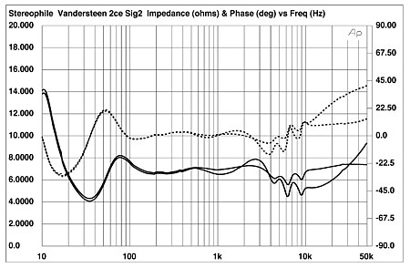

And 6a3, I definitely plan on trying the 4ohm tap on the vandersteen ‘s, just to see what they sound like. Gonna order the parts too to hear these amps in triode.
Definitely try the 4 ohm taps. Bass response will improve.

Tried the 4 ohm taps, and I don’t think I would call it an improvement. Big difference, tightened up the bass for sure, but at the expense of tightening everything else up also -
Sounded like I had run everything through a compressor. Now compression certainly has its benefits, but this sounded like less dynamics, smaller soundstage. Some areas were positive, but it just effects too much. Put it back on 8 and preferred that. Bass is looser,
But the “air” is back with this setting.
I think the negative feedback is the thing I want to adjust , although just very slightly.
The dynaco has 20db nf, and moving the nfb connection to the 8 ohm tap supposedly
Lowers it by 3db. I tried that and it’s too much. I’d like to be able to adjust about 0-3 dB worth. With a pot, but am not sure if this wouldn’t have some adverse effects to the circuit-
Don’t want to damage anything.

I've run Vandersteen 2C's on modded Dynaco's, here's what I learned.
Dynaco 70 with VTA old style 12at7 board: I never could get this to
sound right. Better 12at7's helped, but I think the problem was this
circuit uses less feedback than stock or the other mods I tried, and
the upper midrange was too harsh (there's a bit of a treble peak in
the 2C's)
70 with stock circuit with caps replaced, main power cap at 200uF,
resistors checked and matched: Not bad, but the bass and high treble
lose something. Midrange very nice.
Van Alstine 70 "Ultimate" board: This sounded good, clean to the
high/low extremes. This is a pentode-triode circuit similar to the
original but with simple regulation of the input and driver stages,
and all the time constants redone.
KTA 6SL7/6SN7 circuit with Mark II/III output transformers, and large
brute-force power supply. This was very nice, it had a sense of calm
in the presentation, absence of listening fatigue? This could have
been due to the power supply (several times higher capacity than my
other builds, big choke and power transformer) and/or the input
circuit itself (regulated 380V supply too.)
I'd reckon the Van Alstine and KTA were close, but each with different
strengths. Difficult to really compare because of the power
difference, and I never got fresh power tubes in the KTA circuit. When
I moved I tore that down because it was massive, and the power
transformer had a bad mechanical hum. May still rebuild as monos.
I also tried 4/8 ohm taps, and slightly preferred 8 for similar
reasons as 60cycle.
I expect any of the "Geek/Classic valve" circuits would be good
candidates too.
For a tube amp for these speakers I would want these things:
Power: at least push-pull KT88s
At least 20db feedback for damping and low distortion
Improved power supply significantly over the original Dynaco
-jgf

Yeah the st-70 is probably not quite optimal for the 2c speakers. I think minimum vandersteen recommends is 40wpc. Although, that’s close enough it should still sound decent, but not as good as more wpc would sound. Did you keep the 2c’s? And what are you running through them if you did? The mk iii should be fine with them , 60wpc. My other power amp was 50-55wpc with kt88’s and it sounded really good with them.
Thanks for the driver board comparison with them, I’ll look up the kta and van alstine and see what they’ve done. I read van alstine talking about the feedback circuit and he was adding an input bandwidth and changing a feedback resistor value in one his mods to the dyna, saying it really helped.
This mk iii is stock and sounds pretty good, great separation , but just a little thin in a few places. Most of the resistors have been changed on the inside, and some on the board , but some of the ones for the nfb circuit are original. I haven’t disconnected them, but have tested them with power off of course, and they check out ok. I may change them anyhow .
I’ve read a lot about the nfb circuit, but haven’t found any real good instruction or tests on it. Most of the replacement boards seem to lower it, but they mostly seem pretty radical in changing the whole driver circuit, so lots of variables, hard to nail down any one thing that effects the sound. I very well may change out the entire board, that’s a whole different can of worms there, with so many to choose from. But first I’m going to work with the stock circuit and see if I can’t figure out these small changes I’d like to get.
The feedback has a huge effect- just slightly lowering it, brings out the mids tremendously. Gain goes up super fast too, which is why I just want to make a very small adjustment. Just not sure what would be the best part of the nfb loop to mess with . When I adjusted it right at the 16ohm tap, it had the huge changes I just mentioned, but there may be a more subtle place to attempt to adjust. I saw the 47r resistor going to the 6AN8 mentioned, but no idea which way to go on it , or how much.
