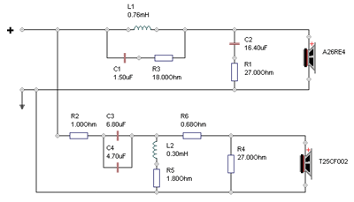

This is the final crossover for WD25a EX, that´s the model with Millennium tweeter (T25CF002).
The question is, how much would this have to change to accommodate Exotic T35?

I have decided upon building two pairs of almost identical cabinets. The first pair will have a hole to fit a SEAS Prestige tweeter. The second pair, however, will be able to accommodate the Exotic T35 tweeter (but also the Excel line, with the help of a felt ring, if needed).
These cabinets will be based on a25/WD25a, and I´m building them with a friend who also wants a pair. I´m also keen to try out a build based on a35/WD25t (volume from the latter), but that will have to be a project for another time.
