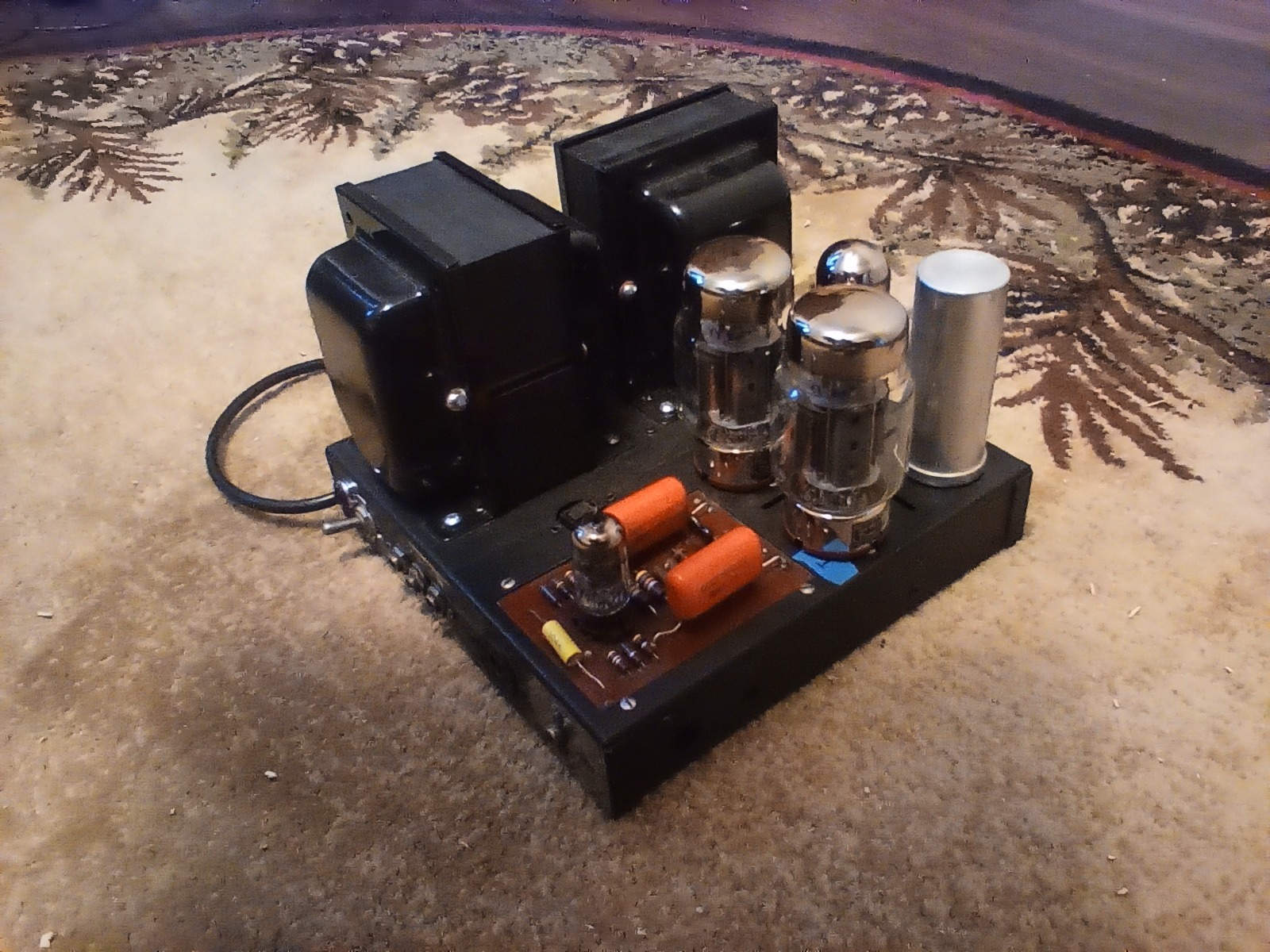

Well, I had all the tubes tested and they were all good, I reset the bias which was about 1 volt too high, brought it up slow and no fuse blow. I'm running it at 110VAC for now to make sure it is healthy. I still intend to replace the selenium rectifier and make the "yellow sheet" mods suggested by Rayna. But for now, I'm back in business. Thanks to all for your input.
Do those one at a time, just in case.
You'll have to rebias after replacing the diode.
You may want to check the value of the bias resistor, sometimes they get off.
Thanks, will do. I was also meaning to ask.....I wanted to install a VU meter. Where would that go? I saw a vid on that once, but now I can't find it. Between the preamp output and the Dyna input, maybe?
