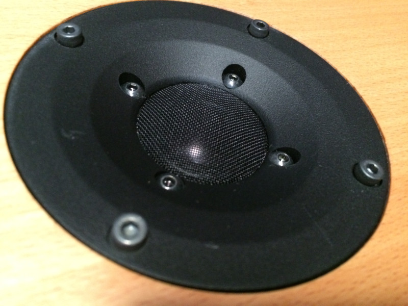

Then I discovered the directivity control of the DXT tweeter and was quite amazed how good the directivity control was for such a small wave guide. Besides that I found it really fascinating how diffraction could be used constructively instead of doing harm. That's when I started to try and copy the SEAS DXT design.
I understand your feelings about the looks. That's why I prefer the smaller Visaton over the Monacor. The Visaton actually looks nice when paired with an 8" or larger driver. Good luck on your endeavor!

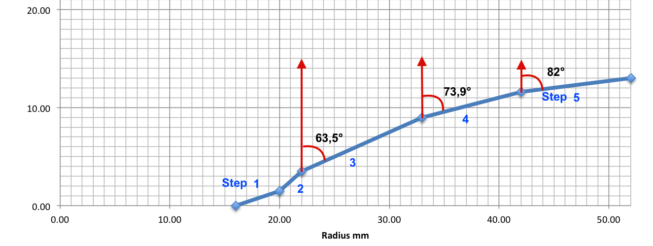

As the simulations of the DXT presented in the German DIY-forum have been mentioned here, I'll post the most important images from the Waveguide Thread on the DXT here.
Post #205 gives the profile of the DXT (buest guess, i.e. measurement taken from a DXT).
The profile is given as 'Steps 1-5'.

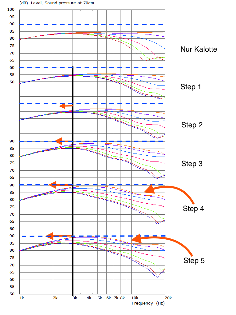

The next image gives the impact of the 5 'Steps' - one after each other - on the directivity of the dome tweeter, starting with the dome only (Nur Kalotte):
You can easily see, what the addition of the single steps do to the directivity (0-90°, 15°-steps if I remember correctly). The vertical help-line at 3kHz is given to show how the additional steps shift the directivity control to lower frequencies. Please note that these simulations have been done in an infnite baffle. Directivity control below 3kHz will be affected as well by the applied baffle width...
The horizontal line at 90dB is given to show th SPL increase between roughly 2 to 10kHz with addition of the single 'Steps' of the DXT waveguide.
For some tweeters you can remove the faceplate and directly mount your tweeter of interest to a waveguide... I do not know about the D3004/66400 though.
If you intend to simulate/construct your own DXT-related WG for the D3004/66400 you do not have to go for ABEC as soon as your WG is round, i.e. axisymmetric. You can use AxiDriver instead, which is relatively easy to use (at least compared to AEBC).

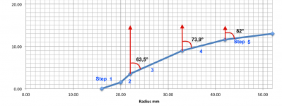

Please note that the WG-profile at the WG-throat has a hughe impact on the directivity at high frequencies, i.e. you have to carefully check, how the dome of a tweeter is mounted in its faceplate and how this 'profile contributes to directivity control. Most tweeter domes are not exactly placed on top of the faceplate, but somehow recessed, introducing a 'step' around 1-3mm already. This 'step' has a hughe impact on directivity at very high frequencies already and should be considered when mounting the tweeter to a waveguide.A tweeter that has caught my eye is the SEAS H1499-06 27TBCD/GB-DXT. After some research I am quite fascinated by the use of constructive diffraction (instead of destructive). I want to use this wave guide, but I don't like the tweeter itself. I'd prefer to use a beryllium dome (I currently have my eye on the Scanspeak Illuminator D3004/66400).

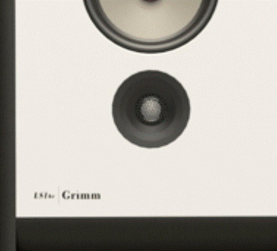

Seas produces a DXT with Be dome for the Grimm LS1. I think they use the dome from this tweeter:
E0058-06 T29B001
Faceplatemounting screws is also changed from front to back:
E0058-06 T29B001
Most models of SEAS have interchangeable parts, eg. coil with copper pole piece, fluid, dome material, dustcap, frontplate etc.. SEAS uses this to serve loudspeaker manufacturers just what they want. Finnish Gradient is a loyal customer.

This is one of my favorite loudspeakers. I quite admire their design philosophy as well. I am not very certain if it is the same tweeter as the E0058-06 T29B001. Grimm's website states that they have co-developed the tweeter with SEAS. Though it could be that they just designed a new waveguide for it.
I intend to mount the tweeter in a similar way as the Grimm LS1 Be.
