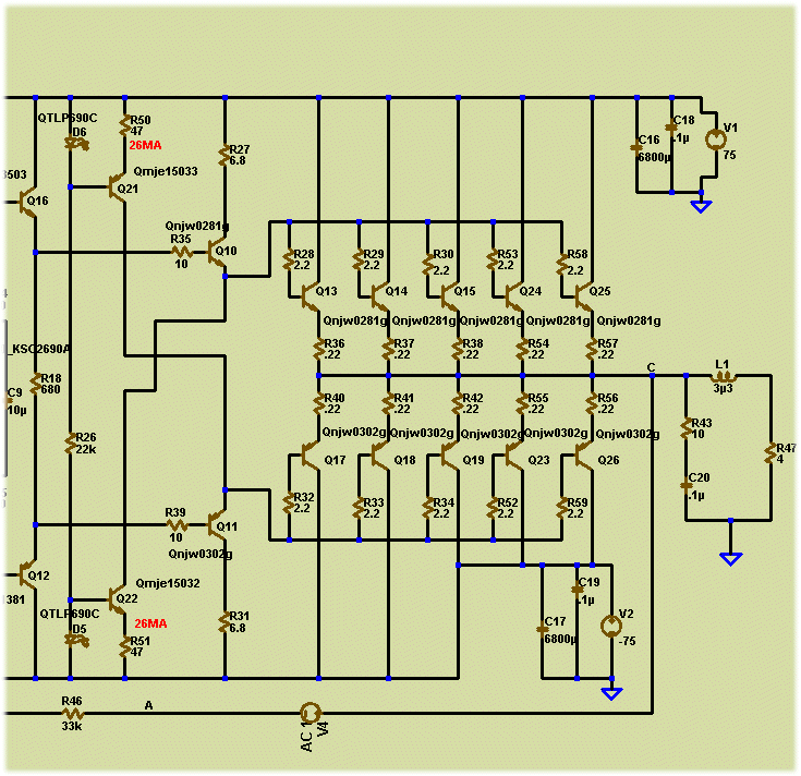

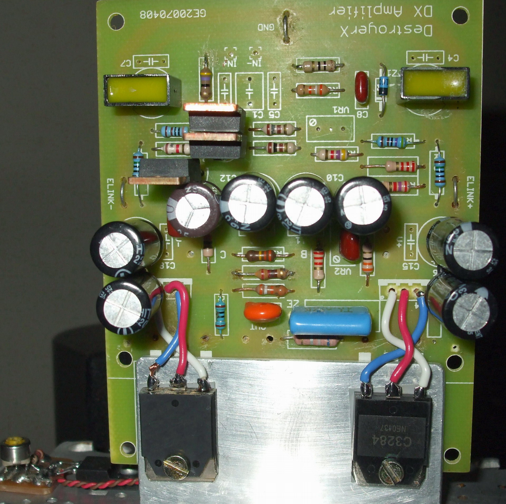

I willl modify, very soon, a Dx Amplifier Standard to work with 90 plus 90 volts..it will be modified and prepared to work as a sub amplifier to a three amplifiers system..three amplifiers to each channel.
All them will be Dx amplifier customized, because simple, cheap and reliable.
This is just the first thougth using simulator..you see that the "frame"..the basic amplifier is the standard..nothing special on that..only the feedback capacitors and some adjustments.
This was not assembled..but it will be, and very soon, and for sure will work fine..adjustments and modifications may be made, including an input filter.
Power goes to 780 watts RMS into 4 ohms easy..distortion is high into 200 hertz... for a while, full power goes to 1 percent, and i will reduce that soon.
The amplifier will operate from 1 cicle to 300 cicles.... loosing almost 3 decibels into 300 cicles...the mid unit will start into 300 cicles and -3dB too.
All them will be made using Dx standard.... midrange will operate with 50 volts and treble will operate from 25 volts simetrical separated supplies...one supply to each amplifier...three supplies each channel.
Input will have passive filters and volume pots.
This way you will not worry, anymore, with speaker ballance, also room acoustics....you will need to run a cable from the speaker... 6 wires... one pait to bass, other pair to midranges and the third pair to the tweeter.
Thank you Dudainc to stimulate me to do this way..for a while passive, but Duda wants active.... will do that also.... for the future.
This one was not assembled...it is a son of a simulator...do not assemble for a while..let me debug.... those things into simulator sometimes results not fine...wait a little, please.
Transistors are the ones i have.... the input does not need big transistors, of course....those are the ones i have to work with high voltage...will try others too.
Into 8 ohms, around 435 watts RMS into the threshold of clipping...but this depends on the supply.... bad supply will turn that 200 watts or even less..all depends on the supply power..good supply results good power..bad supply results weak continuous results and interesting peak results.

Go ahead and try a small signal transistor model in the input stage - the simulator doesn't care if you run it past its ratings. That will give you better distortion numbers, and a better simulation than using a model for a part that doesn't have anywhere near the right characteristics. I'm sure you can find something suitable in your parts stash somewhere when you go to build it. MPSA92?
I've never seen an LTP using MJ15023's - but I have seen them used in a VAS. It was in a 300 watt Gallien-Kreuger bass guitar amp.

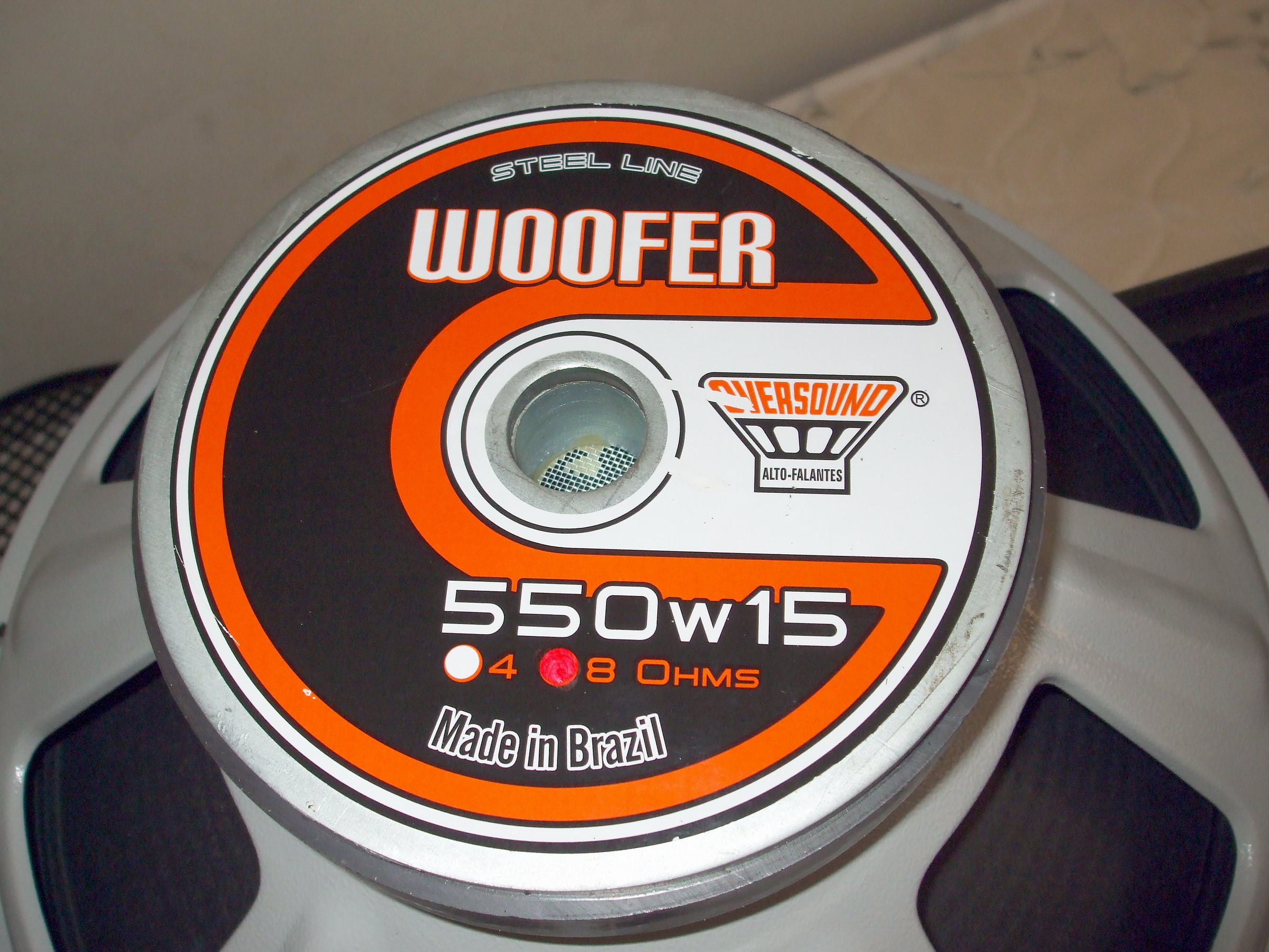

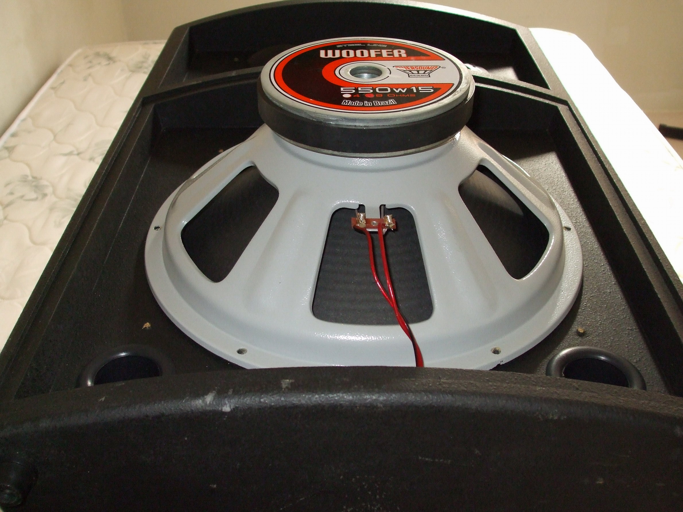

I have one speaker that can hold all that power... at least can hold the volts and amperes.... i do not know how much will distort when receiving high power levels...the coil can hold all that power...i do not know how will perform.....i am pumping 150 watts now a days and it is asking for more.... we gonna know how will perform with 400 watts and more (8 ohms).
Problem here is to find capacitors to face all that voltage...the supply voltage is very high to my capacitors and electrolitic condensers....for a while i will have to arrange some of them in series, to face more voltage...but this is for s while, as Sakis has send me huge ones that may arrive in November...they are with Dudainc..he may travel to Brazil soon..if not November will be Christmas.
I have no small transistors to that voltage...i will have to use those folks...at least to start some test.... this will not impeach me to do something..if not with the perfect parts will be with non perfect parts for a while.

That 550w woofer there would become toast
with a true 300watt amp , much less a 500w+ one ! With twice the magnet and twice the voice coil , a real subwoofer ...
http://www.parts-express.com/pe/pshowdetl.cfm?&DID=7&Partnumber=297-608&ctab=1#Tabs
will "tap" (bottom out ) even in a sealed enclosure at 300w. I know you don't like leach amps or triple outputs , Carlos .. but for subwoofer purposes and a woofer that will occasionally require 2 ohm loads , it is the only way.

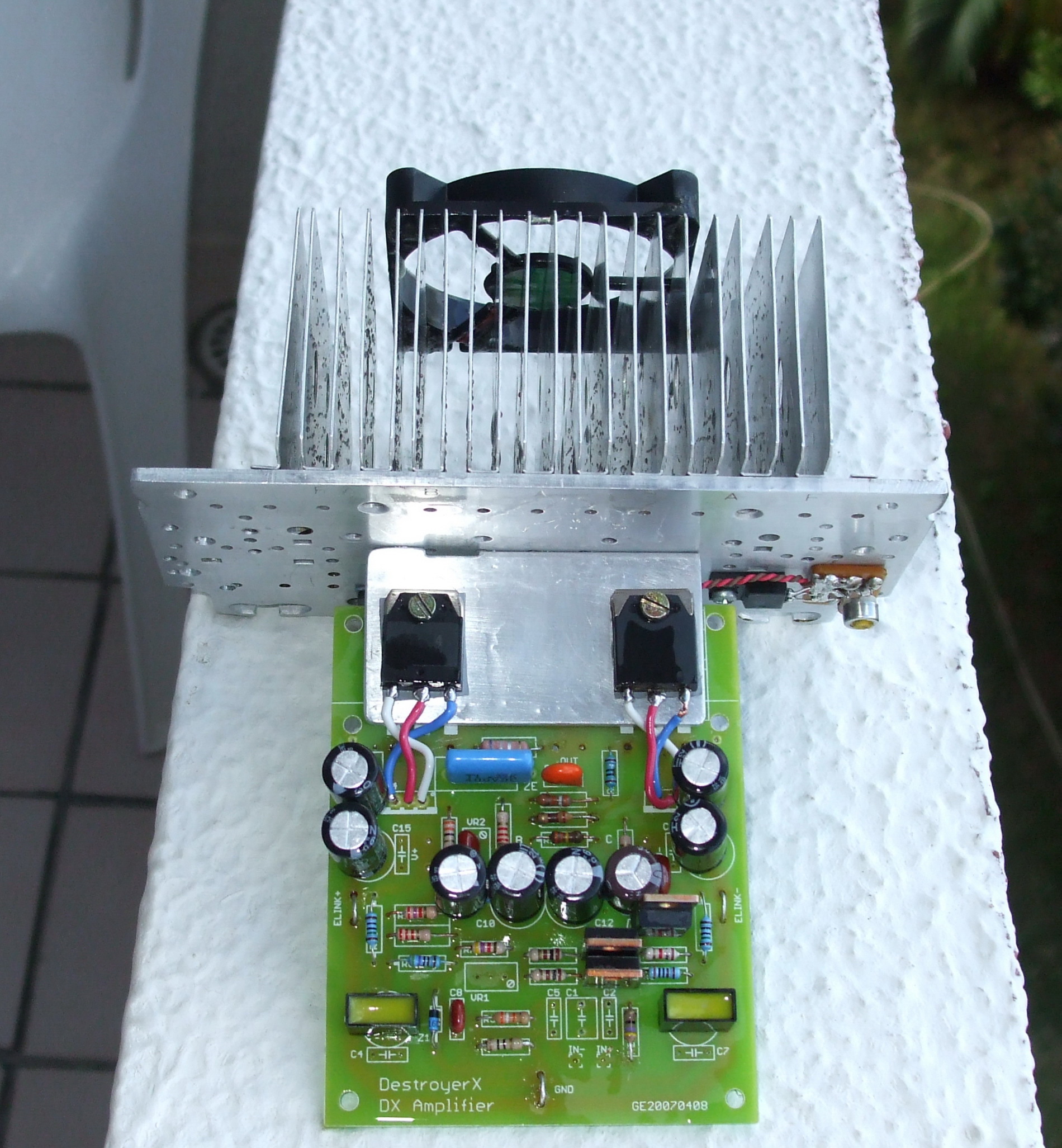

This circuit will be tested tomorrow.... the supply voltage is more realistic
as my supply will drop to 82 volts under load.
I am using the Dx Standard schematic, to use the same board..this will turn more simple to builders..no special board.
Power now will drop to 340 watts into 8 ohms, and this is more reasonable to use 4 transistors...this will be more safe.... if people want more power, then include the fourth power transistor and connect 4 ohms speakers.
The input filter is in place...passive filter.... -3dB at 400 hertz..no losses into 5 hertz.
Sensitivity was adjusted and condensers are also more realistic, to save some money, and to reduce condensers size.
This gonna be tested tomorrow...wish me luck.

That looks interesting Carlos - I will certainly follow this tread closely.
Given the design parameters you described, it seems you are on the verge of creating the DXzilla - a monster that will smoke lots of Brazilian drivers. 😱
This will certainly resonate with the "powerholics" as you call them. 😀

Thank you, Greg Erskine (Gerskine at our forum) by your kind cooperation

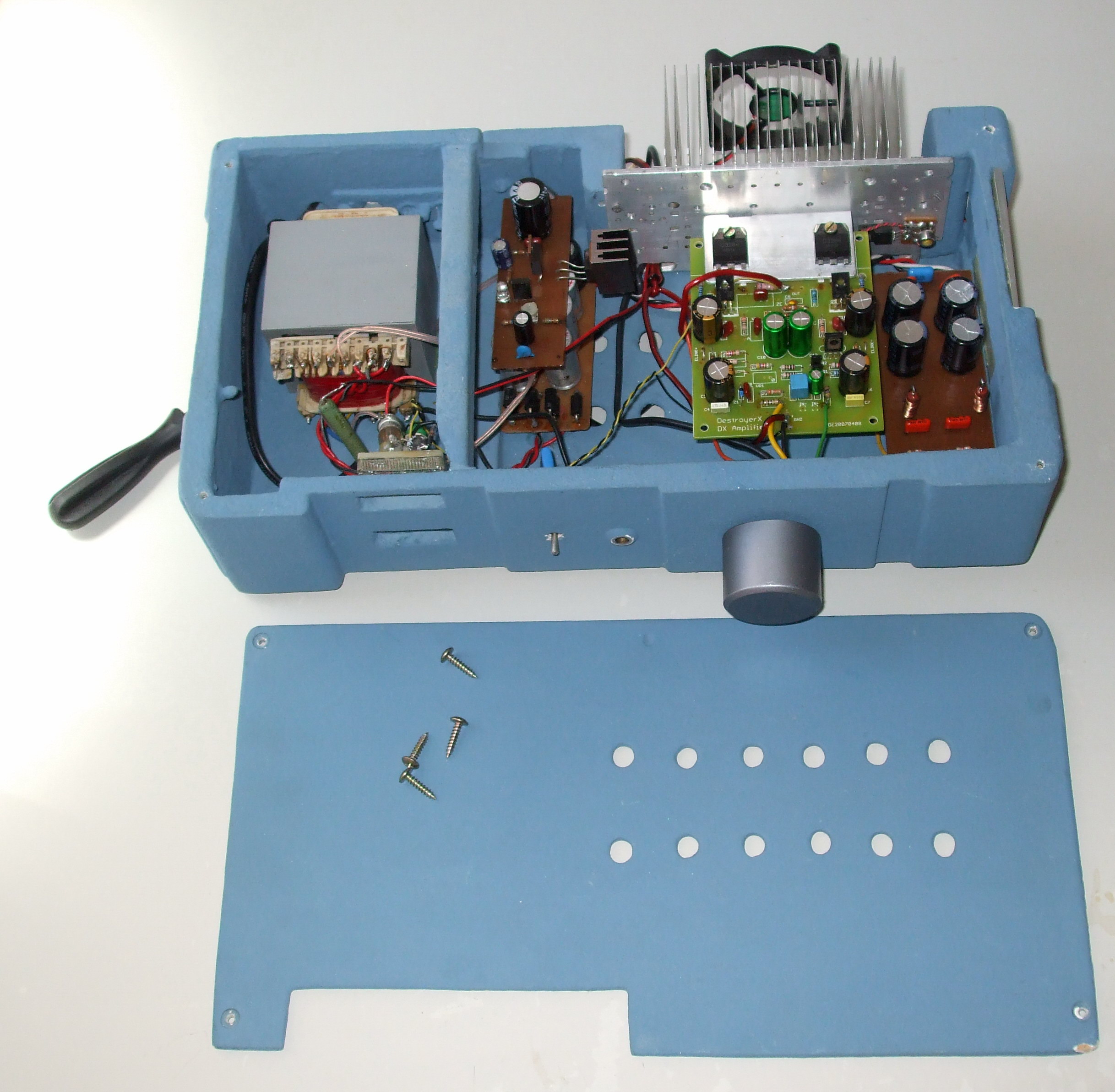

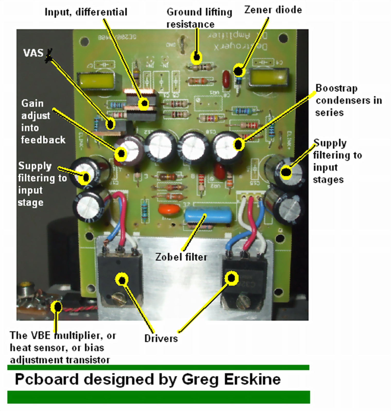

Board was made by Greg.
I have installed the output transistors bellow the board, attached to the heatsink and connected to the board using 2 inches long wires... non parallel wires.
regards,
Carlos
regards,
Carlos

I have never seen that driver you showed on the first posts - I remember Novik, Bravox and Selenium (the last two are still in business).
Please keep in mind that most drivers (I am aware of) available in Brazil are very inefficient just like most drivers intended for the MI guys (cheap and inefficient by design).
97dB sound efficient to me. The RMS rating on that driver is shown as 250W and the peak power is shown as 500W. Here is a link to the spec sheet.
http://www.oversound.com.br/index.php?lingua=&pag=../loja/loja_produto&cat=126&pro=3372
Thanks Steve - I never heard of this manufacturer before...
Based on my experience with speaker manufacturers in Brazil for the last 20+ years, I have a hard time to believe the published specs.
Based on my experience with speaker manufacturers in Brazil for the last 20+ years, I have a hard time to believe the published specs.![]()
It's common practice for all manufacturers to use average SPL over the whole "ueasble" range for SPL 1M/1W. That includes the breakup peaks, which can be +10dB. Half-space reference sensitivity is easily calculated from T/S paramteters, and usually ends up some 3dB down from what's claimed based on average. It's probably about 94 dB, the same as similar drivers.
Some of the junk they put in "white van DJ speakers" can be really low efficiency - 88dB or even less and can have Qts over 1.0. Most of them are made in China. They also can be had for $20 for a 15" (so if you blow it it's no big loss). The ones Carlos is using aren't that bad - they're something like an Eminence Beta 15 or a bit up from that.
