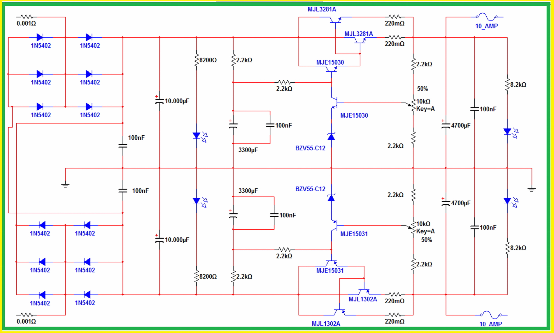

Are those vertically mounted resistors of 2watter rating?..and what is the rating of BZV55-C12 zener, I have been consulting datasheets but it seems it was of SMD type.😕
any 12V 1/2W Zener like 1N4742A will do and for the resistors I guess 1/4 or 1/2W will suffice!

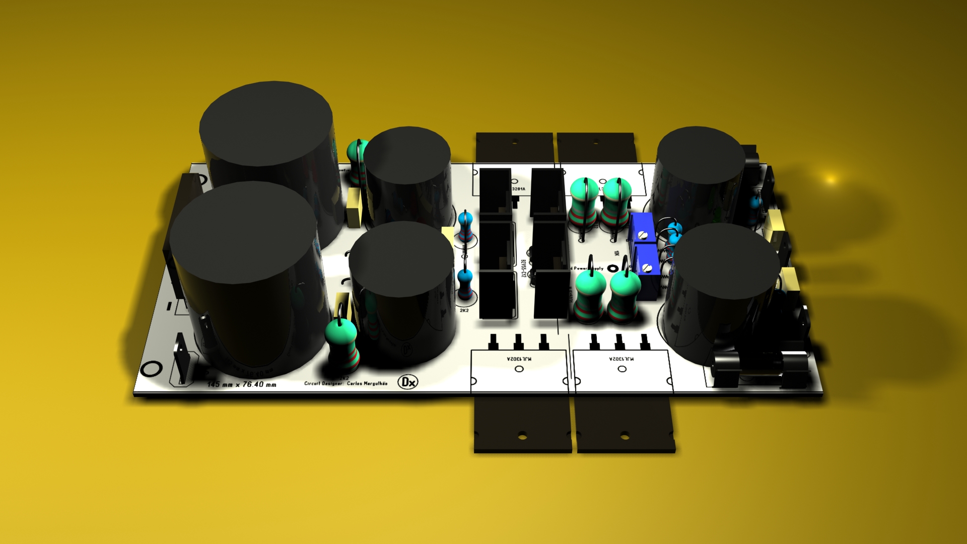

@wiljj78,

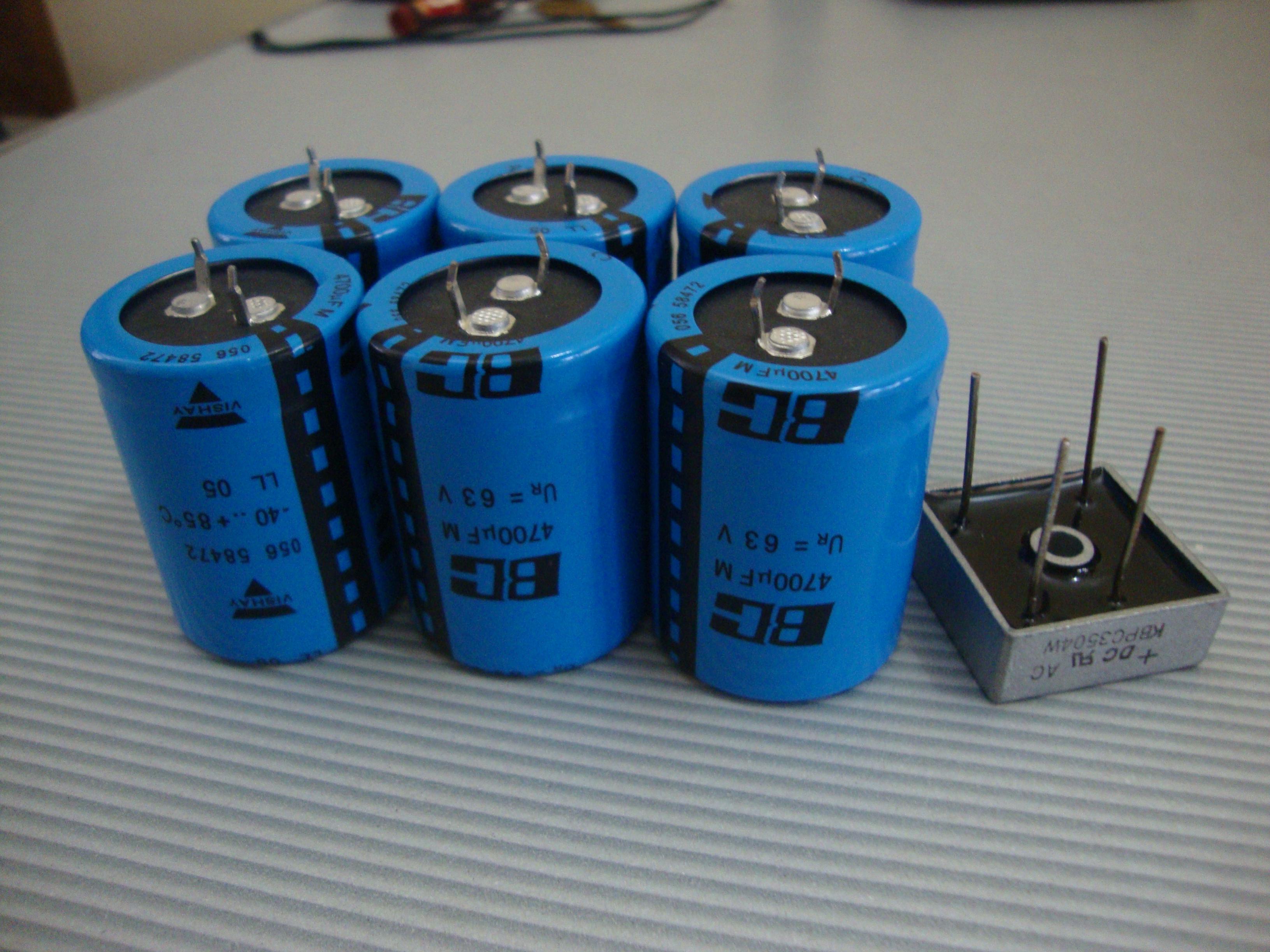

Can I ask a favor from you and include in your new lay-out a version to accomodate Vishay 63v 4,700uf (low profile) they are about the same footprint of a 50v 10,000uf ecaps. I plan to use 2 pairs in parallel as the main filter caps and still use the same type of caps for the smoothing capacitors. My PC failed last Sunday and I can't do CAD, this may take a while..it was a hard disk failure

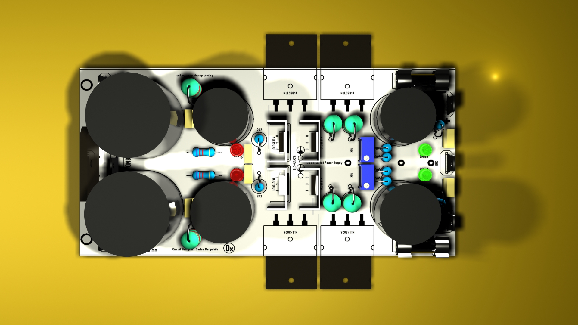

Use the layout Bruno Carcass made...but i have not build, so, not tested
Do it under your own risk.
Usually we do not have layout problems in DC to DC regulators....no oscilations happens there..so, the layout is not critical, only large tracks were you have large currents are needed.
I will not ask Juan to increase because i have asked him to decrease the pcboard size...so...he already have worked twice, first he made a version that was giant, alike a Moby Dick married with a Hinderburg ballon...then i asked him to reduce even if he needed to make some sacrifices related the capacitance..and he did.
No way to ask him to produce another layout, also because this one was tested, was built and approved..... this is now something from the past.... work done....made.
Bruno from Portugal is also asking this because he has huge red condensers he wants to use...then you should ask him to test his board first and then it is up to you to use it...there's no obligation to use Juan pcboards, people can do by themselves, despite the ones made by Juan are official pcboards, tested units, i have build and asked Juan to do the same.
After some tests we could figure out that a single regulator would not be good enougth to powerholics...people that may want to use 2 ohms and to push the amplifier to the limit.... a single regulator cannot do that...so, the idea is to use two regulators, one to each channel, and to do that they must be small or no way to find room inside a standard sized enclosure.
If you read the text about power, the one i have commented these power details, you gonna see that one Dx Supply will be good for 4 ohms operation and two channels..but no good for 2 ohms operation... forcing the guy to build a second regulator power supply.

Juan have made a first layout that was giant...i said no
And i have asked him to reduce...maybe he want to share that first layout that may fit your needs (it is possible)
So, it is up to Juan to offer, you should go to him and ask him if he want to share.
I do not mind..but as the big one is not official, i would like you to contact him by email not to have the huge one posted here.
