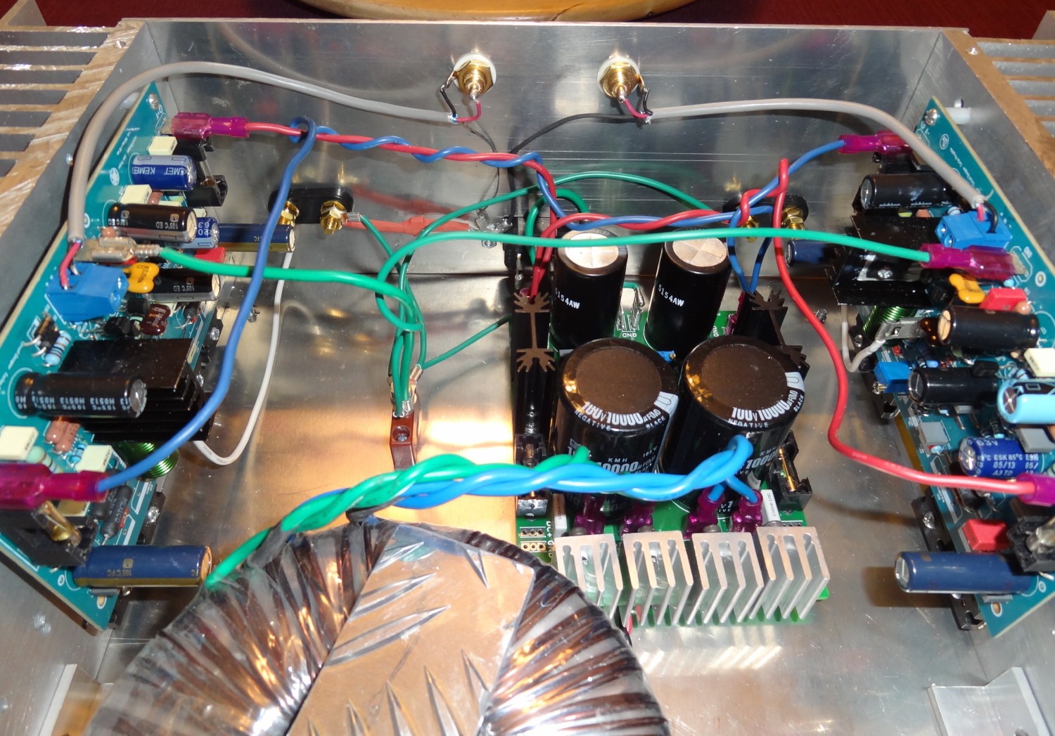

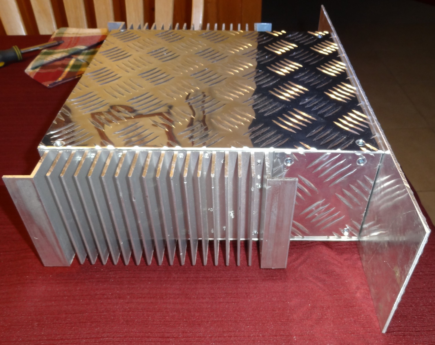

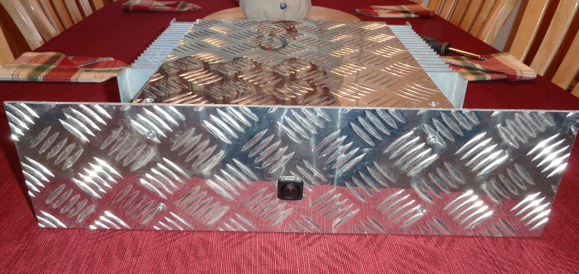

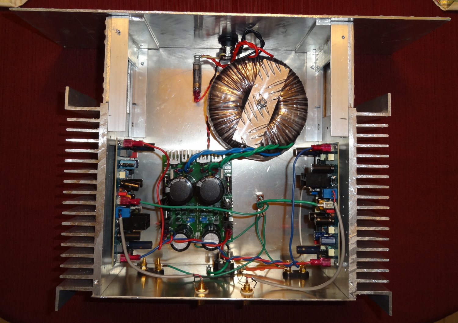

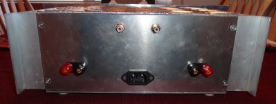

Hi Guys,
Well I finished the Super A. Been playing it most of the morning. Sounds very nice. I have it biased at 200mA per rail and the heatsinks are barely warm. I'm going to leave it there for a while and let everything burn in. I used a Mr Evil/PMI Cap Multiplier for the PSU as I am using the DX power supply for another amp that needs higher voltage. Using a 25-0-25vac Antek transformer and with a one volt drop for the regulator the rails are +/-38.4Vdc.
Here are some pics of the finished amp.
Blessings, Terry
Blessings, Terry
