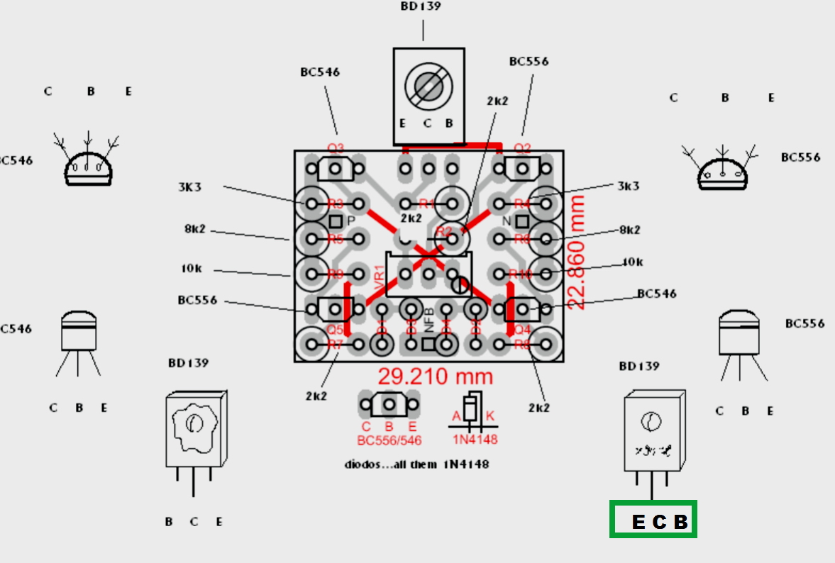

post19 pic3
The rightmost BD139 is shown with leadouts of ebc This cannot be correct.
All To126 devices have the reverse lead outs of To220. The lead outs are as shown for the left most BD139 bce (viewed from back face) , or when viewed from the front (printed) face ecb.
No problem..he did the way i have asked him to do.
He is a good friend...but he dislike to put components in vertical...this is our main fight and this heheheh is because i knew he would not like it.... the hehehehe is a little bit sadic and a little bit shy....he knows what not a real laugh.
Communications using words are not perfect, reason why i use audio messages and video messages to communicate better.... only typing letters is confused as people can understand in many different ways.
Yes, i could already see the mistake in the BD139 ....i just cannot fix that now because i am at work and i have no image editor available...latter i will correct that.
regards,
Carlos
Inside the green square there's an error fixed.

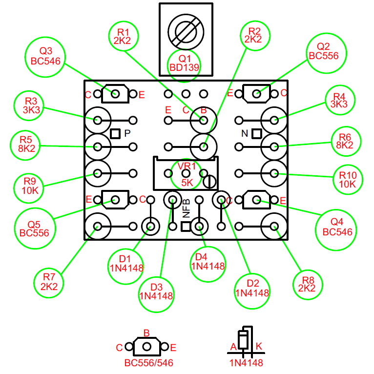

1 – Remove the BD139 bias transistor out from de Dx Blame ST
amplifier pcboard..
2 – Remove the bias trimpot from the Dx Blame ST amplifier
3 – Install the Dx Super A pcboard into the heatsink not forgetting
to place insulators to the BD139 transistor and also insulating
material (paper, plastic, cardboard or rubber) to avoid Super A
pcboard to make short against the heatsink.
4 – Into the Dx Super A pcboard run out wires from Q3 colector
(BC546), also run a wire from Q2 colector (BC556) and also
run a wire from the NFB point (joint spot of 1N4148 diodes)
5 – From the Dx Super A pcboard pick the wire that comes from
Q3 colector and solder the free extreme to the spot you had
previously, the Dx Blame ST original bais transistor collector
connection
6 – Pick the wire that comes from Q2 colector (Dx Super A board)
and solder it into the spot you had, previously, the Dx Blame
original bias transistor emitter.
7 – Adjust your Dx Super A bias trimpot to the suggested resistive
value o 1000 ohms
8 – Now install protective resistors into your power supply rails,
in series, and connect DC meters over the resistor’s extreme
leads in order to pick voltage drop that will be developed there
while bias current will be flowing through these resistors….If
you want a suggestion, then use 10 ohms/10 watts resistor….
despite almost any low value will fit…you have to divide the
Dc voltage you read by the resistor ohms value to obtain the
actual current.
9 – Now switch power on and measure the voltage drop, it should
from 2 to 3.5 volts … then re adjust in order to achieve the the
suggested that is 300 milliamperes.
10- Monitor your heatsink temperature, your heat will be in
between 14 to 24.5 watts, this represents, already, a good
ammount of heat… it is alike a 24.5 soldering iron heating
heatsinks… now push your amplifier hard playing it full
power in order to make it hot, then readjust your current while
your heatsink is hot (more than 55 degrées Celsius)
... to be continued.

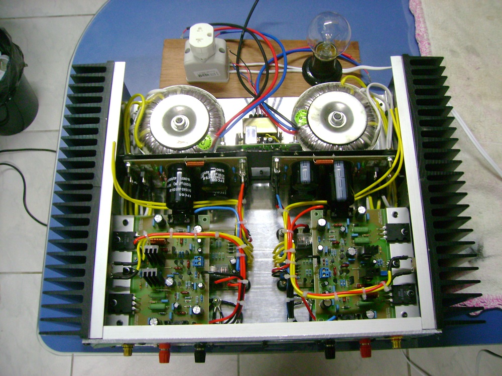

I have overheated the amplifier while using the Super A module
In this video you see the results:
Dx Super A operates hot - YouTube
Audio was cristal clear.... distortion is due to digital camera electret cartridge microphone saturation due to high levels of audio reaching it..almost 50 watts RMS at 1 meter distance.
