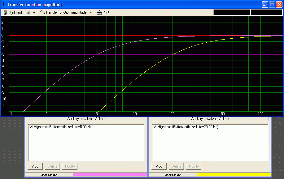

AndrewT said:
Taj,
what is the filter that you have posted the graphs for?
It appears to be more than a single pole passive filter.
It also appears to have a Q much high than Butterworth.
What have you posted?
eg. a Butterworth (Q=0.7) is approximately -1dB at twice F-3dB
and approximately -0.1dB at ~7times F-3dB.
You're right! I was half asleep. I was off by order of magnitude here and there. 🙄 Thanks Andrew. I thought it looked a little (a lot) extreme.
..Todd
Fixed.

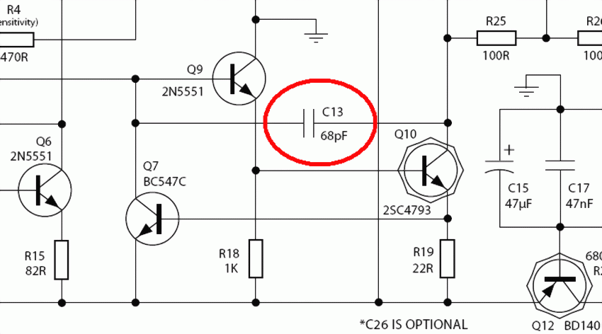

precision-I gets hot, need help.
This is about precision I. at first my amp was operating very well but this few days it’s showing me some abnormal Hot. Sometimes any one of the channel gets very hot, I have measured 106c was today. This problem is not having every time. Only sometime and suddenly without any reason. Sound still good as before. If I turn it off and on it again this will operate normal again but don’t know when will hot again. It’s not all time showing, only some times like two days later or may be next day.
Anyone can have comment on it.
Thank you
michael
It might be going into oscillation intermittently.
The phase margin may be too low.
The phase margin may change with varying PSU supply voltage (as the mains voltage changes).
The phase margin may change with changes in ambient or component temperature.
As a short term sticking plaster add a temperature switch to each heatsink and connect that to a warning lamp/LED.
Investigate the phase margins by doing more thorough testing.
Reduce your stand by current to a level you will measure
a very small voltage (1 milivolt) or something alike over the emitter resistances...into the power transistors.... do that with your input shorted and after 30 seconds of warm up..... do that fast, as the warm up may turn your adjustment wrong...if excess of bias, the transistors will warm very fast and you will be adjusting it warm.... this will result underbiased when cold.
Increase your Miller capacitor value to 100pf.
Have you measured AC voltage into the output, without audio signal entering?
It may be oscilation..... or the combined effect of thermal drift triggering oscilation.
Are those amplifiers exactly the same.... say.... where they built the same way...same kind of construction, same boards?
The differences you have may be the reason.... check that.... watching one board check the one is unstable... the differences you have into the unstable one should be modified.
regards,
Carlos
