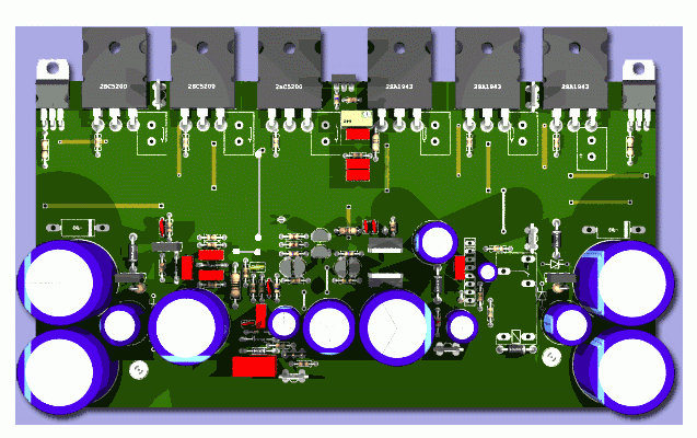

Hi the latest schematic is nicely drawn, but would you mind adding a protection diode for each of the cap multipliers...
Much to my Pain I realised that I had like a hundred things in the wrong places on the PCB... well technicaly it was OK, but FAR from optimal... Only noticed when I started getting funny connection lines when I tried to add the cap multipliers.
Think I have it 80% solved now... It is one very full PCB that!!!!!
12 Electrolytics, 19 transistors, 9 diodes, and much much more!!!!

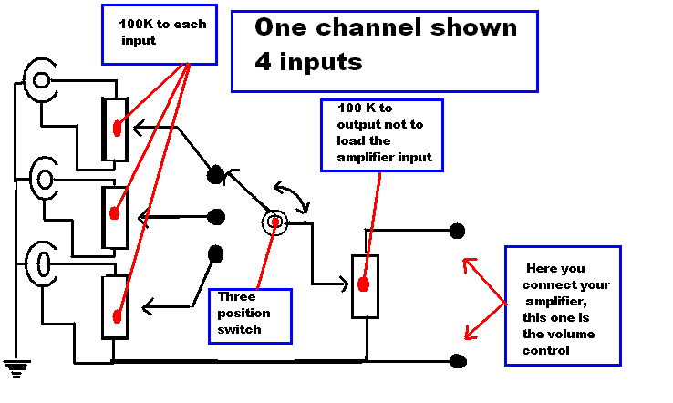

Dx Corporation, the one you called Dx Acoustics will not use pré amplifier, or, will not use active pré amplifier...only passive, only trimpots to reduce levels and to control volume.
We had the need of pré amplifier when we had the use of turntable....yes, good audiophiles (the ones have money for that) still use Vinyl discs, but this is not the majority.
Those turntables cartridges needed pré amplification, and also equalization....but...now a days, our audio sources are CDs, DVDs, Television Receivers, Satelite Receivers and very few people use FM Reception (Here they are awfull.... i cannot listen...too much bad, drive me crazy that awfull sound).
Because of that, we are adjusting the amplifier sensitivity to work with all sources...then you have only to use one trimpot to each source, switches if you have many sources or audio and the main potenciomenter into the amplifier input to adjust volume.
Each stage, active circuit, will produce amplification and will also include it's own distortions, so, removing things from your audio chain you will have always advantage.
The best possible sound is the "wire with gain"....no one have discovered that wire till now a days..... one single stage is the best idea, and Nelson Pass have explored that...the problem is that do not produce power enougth...so..... everybody had to include other stages, input differential, VAS, driver plus output.... called three stages..... not really, maybe three blocks.
We still have distortions.... you can see them into waveforms and also you perceive them very clear into listening.
Because of that, Dx Corporation (do not exist in the reality, it is just a dream to become true) decided to use as many auxiliary, periferic, surrounding parts as needed, as stabilizers, current sources, mirrors and all that stuff, but not to include any stage into the audio chain...because of those reasons, the pré amplifier you are dreaming may never exists into the Dx Acoustics as you said....i like the name Jeffry, maybe will be a Division for you country,an Indonesian subsidiary company with you as the President.
Some research on speakers are needed...i am thinking into a spark produced by ultrasonic...high voltage flowing from two points..and to modulate that thing with audio.....so.... ligth and sound will come together with a very nice effect.
Problem will be the interferences generated, the noise into radio receivers and many other systems, may disturb ultrasonic medicine instruments and so on...but may work, multidirectional, omnidirections, very powerfull and better than speakers.
Having current, in special high frequencies, having metal.... then you have electromagnetic waves travelling into space...this is the problem...but we can shield it inside a metal globe, grounded, having very small holes surrounding the metal ball.... 2 milimeters diameter holes may block the electromagnetic waves.
regards,
Carlos

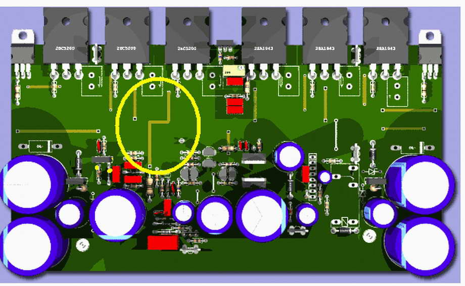

That curved one is a little bit strange, as everything is squared there
Please, remove it or put interrupted dots, or sequence of dots..and better to use straigth lines and 90 degrees angles into this "indication" to use wire links.
You board is too much pretty to have that curved line there, seems the one that have painted skid with the brush and painted a wrong curve in the place of a line.
Cannot use straigth jumper, split them into two jumpers, one to the horizontal position and other to the vertical position.
Also, people will prefer, if wire jumper, to put the wire under the board were nobody will see it.... so... the indication, the upper board indication to the wire jumper will loose the reason to exist and will be there just creating aesthetics problem.
My evaluation is 99.999..... the 0.001 lost is that curve there.

Well, I hate to disagree with you Carlos, :devilr: but I think the curved line looks classy and elegant compared to steps. A straight plumb jumper would be best obviously, but I think Nordic's solution looks very nice.
..Todd
