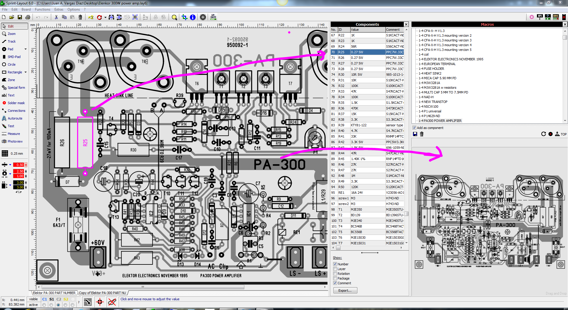

Has some seen this layout ? 🙂

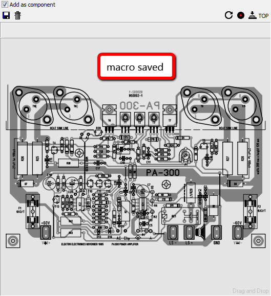

finally I got it 😀 I always want it to make a clone of this one 1995 Elektor

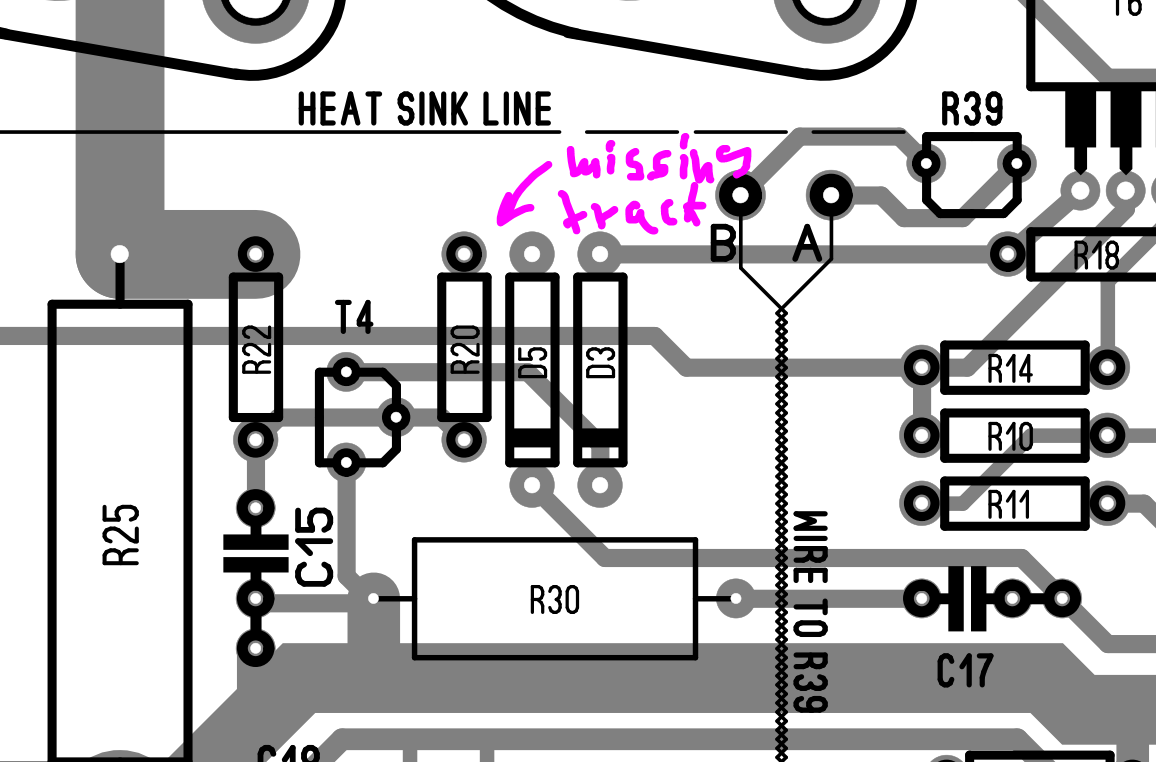

there is and "errata" on this Elektor PA-300 layout 😱 yes! I fix myself nobody is perfect lol 😛
Regards
Juan
Ok the "clone"is almost done

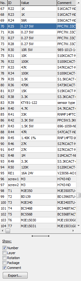

one thing I found out about Sprint Layout 6 is that makros=macros can be add a part number and the list can be seen to the right corner of the program, I be damn! why I didn't see that before ? lol and the good thing is when the component is selected it shows what part number and some other information that can be add it too, I have been practicing for a while and I want to share the best of what I know so other can learn this wonderful software.
Another thing I found out is that after layout is complete it can be save as a "big" macro that really save time sometimes 😀 I'm going to make a video to show you guys.

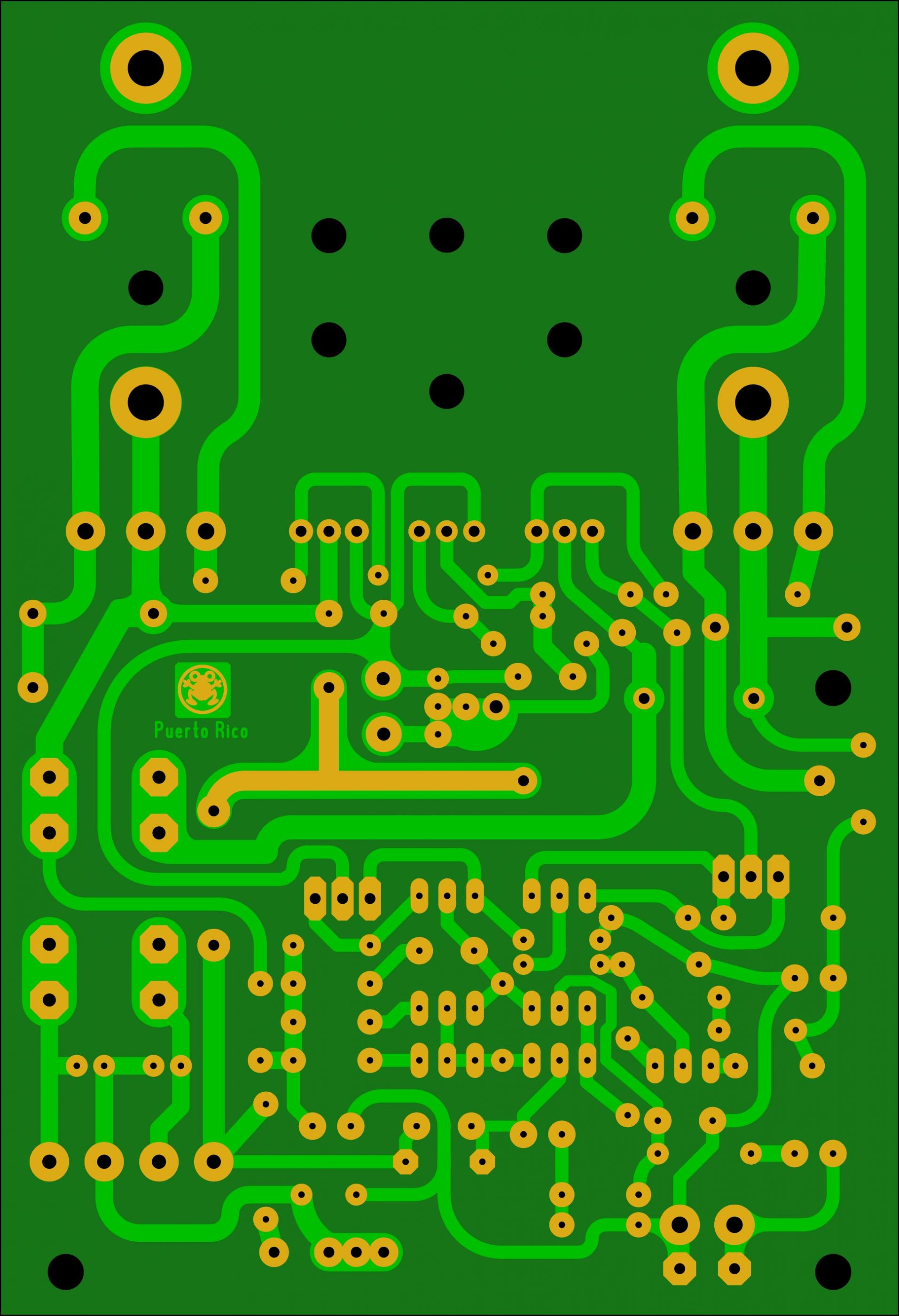

Here is another practice PCB and for the first time I use the top copper area of the board I'm not really use to make it that way, but I guess is ok I have the idea from mister OS "SLEWMASTER" layout style so I incorporate to see how it looks on Dx Super A I will continue to see if I can fix some other stuff 🙂
Regards
Juan

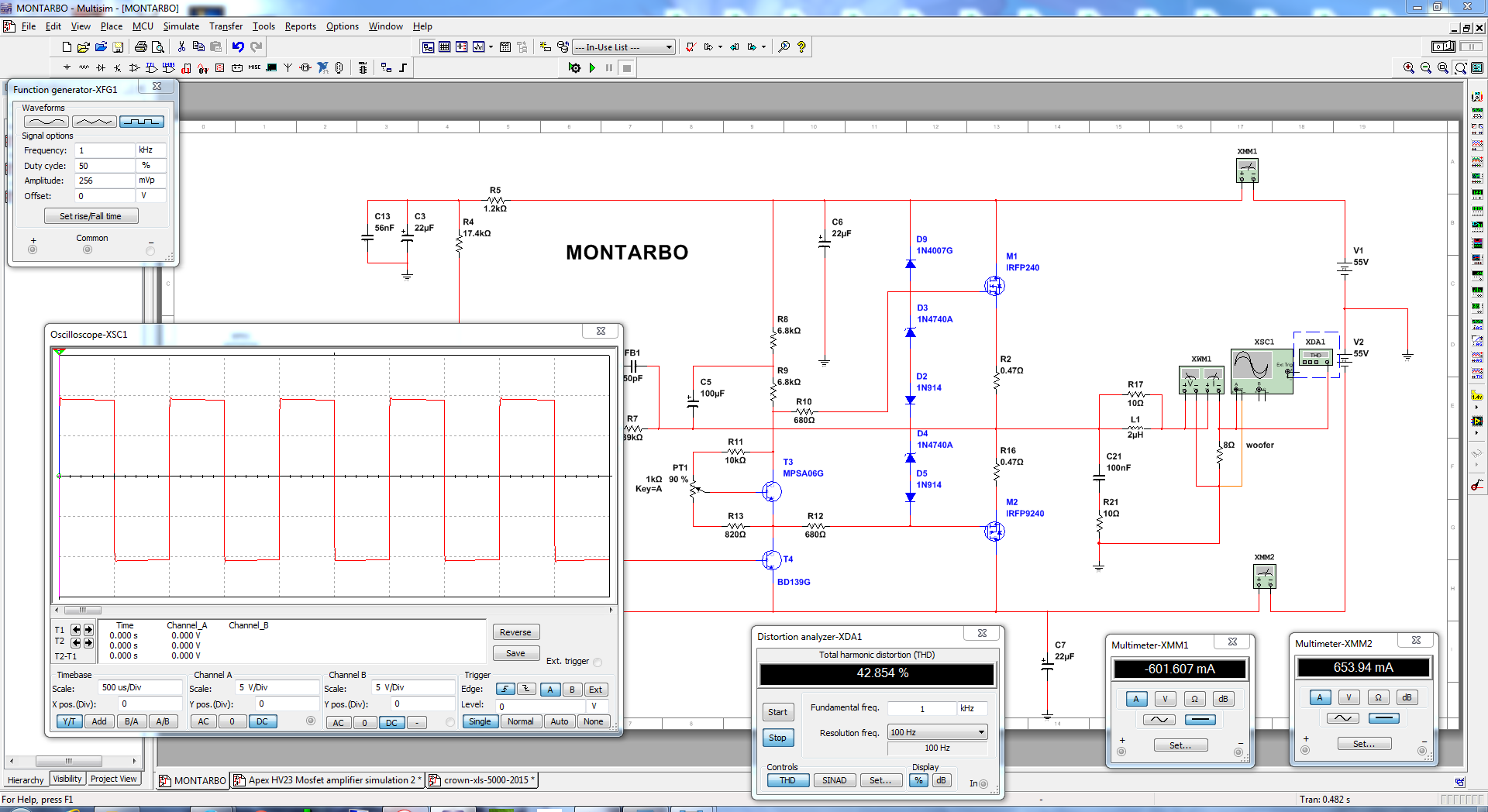

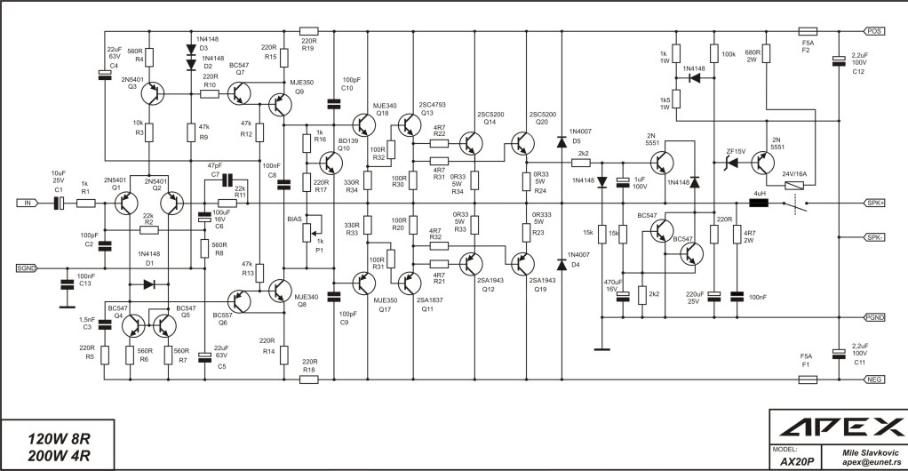

Hi Juan, can you draw a pcb for this amplifier?
this one has been already test it or simulated thimios ?
Regards
Juan

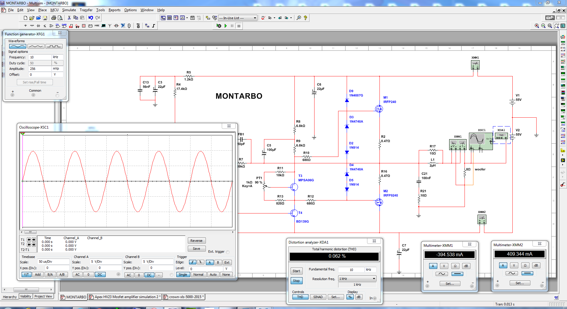

Hey thimios I'm back a placed the circuit on the simulation and yes it works but KTA1268 is not available on my simulation and I use 2SA954 instead also 2SD1857A is not on my simulation so I use BD139 I know this is only software simulation but at least it give an idea that the circuit works an it does work see images 🙂
I call this circuit " MONTARBO " is was name it on the image you send me 😛 let me know what is the real name later when you get a change man 🙂
Regards
Juan
Regards
Juan
what is the dc offset of that schematic?
vostro I have not done that yet I only did a software simulation 🙂 because I like to make sure that the circuit respond you know correctly so far this one does ok,
maybe after is placed on a PCB and test the result might be different this is just a 88% simulation I think 😛 as aproximation
Regards
Juan

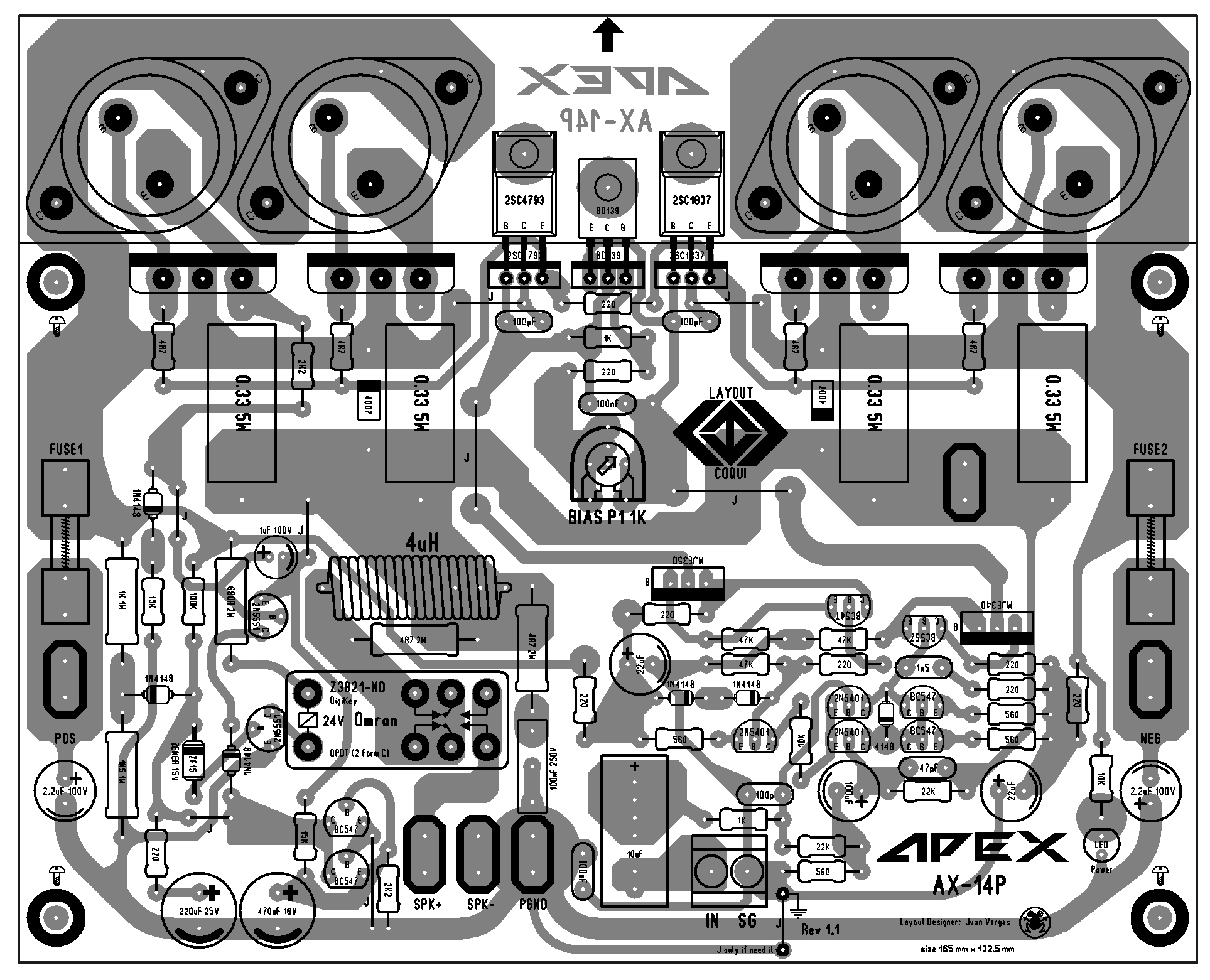

Hello sir 🙂
what you really want to change on the PCB ? you want the same schematic on this PCB ?
Regards
Juan
