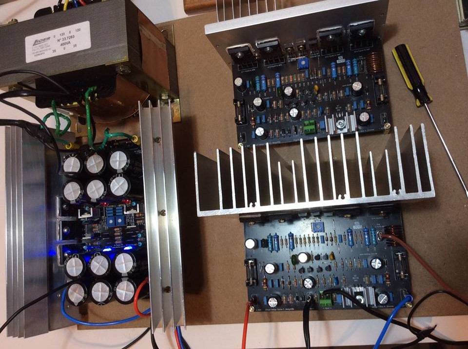

We are now a days offering Dx Super A assembled kits in Brazil, two channels and supply by the equivalent value as 330 USD.
We will not offer outside Brasil because we do not trust our Postal System anymore... here in Brazil gonna be red pcboard with some parts in black...silk screen in white, double face, solder mask, special copper, golden plated, very thick fiberglass pcboard, the size of the full circuit gonna be aprox. equal to the Dx Supply pcboard.. will have no indications, no part number, no values and no schematic.... 5 years full warranty, parts and labour (not shipment for repair)... it gonna be delivered in Brasil fully assembled and tested..no heatsink and no transformers (used two)..it has rectifiers , fuses and filters on board.
People will run to you..as we stop to offer pcboards to the Dx Super A too...so...the only one has pcboards available now a days is you dear Juan... even in Brasil it is offered assembled by 330 USD (two channels and Dx Supply)

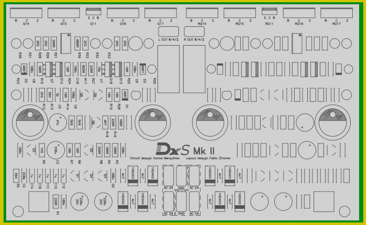

Next circuit gonna be DxS.... will be less expensive...around 300 bucks...for Brasil only ...we do not want to ship...we do not trust our postal system.
Showing you first study related the pcboard.... we have modified this one a lot...but it looks this way....no value gonna be printed.... no schematic will be offered ...we gonna repair if needed...will not be needed....0.000259% THD 8 ohms, 45/90/180 watts RMS at 8/4 and 2 ohms....naturally can work at 6 ohms too.... DC supply 33 volts DC..analog supply without electronic filtering to the DxS MKII... circuit is different compared with the published DxS...this one is MKII.
Guarantee voided if the one operate with voltage higher than 33 volts...we have installed sensors, so...we gonna know what happened....then the guy will pay for the parts and shipment for repair due to bad use.
Was tested 24 hours long..full power with 1.9 ohms complex load, including real speaker without cone not to make noise...pumping out 5 hertz at full power into the threshold of clipping...so...we know it gonna survive with the rated load.
Treble is awesome..bass and mids are fair... 2 ohms goes to 0.001% THD
Silk screen will only show subcircuit position, VAS, Differential, CCS and so on..dotted lines and silk screen with section name..to look good in contrast with the red pcboard a with inscriptions on it.... values shown on the pcboard image published are not real... nor the pcboard is the last revision too.

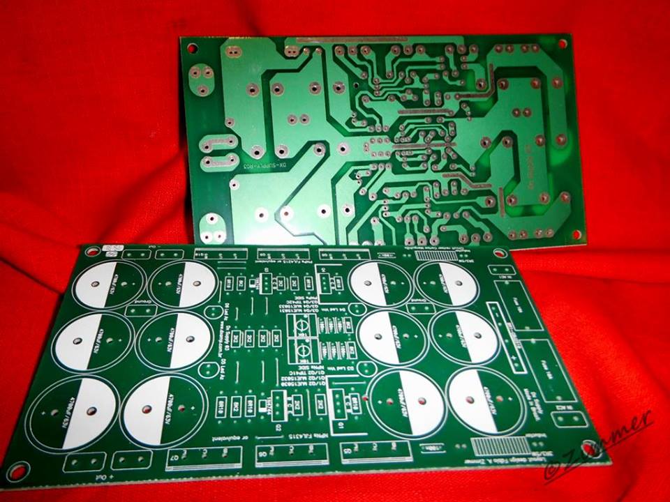

Here you can see another pcboard colour offered only in Brazil for Brazilians.
Just to let you see we are still working on that.
Juan may have some pcboards available, the blue ones.
regards,
Carlos
or damaged parts.

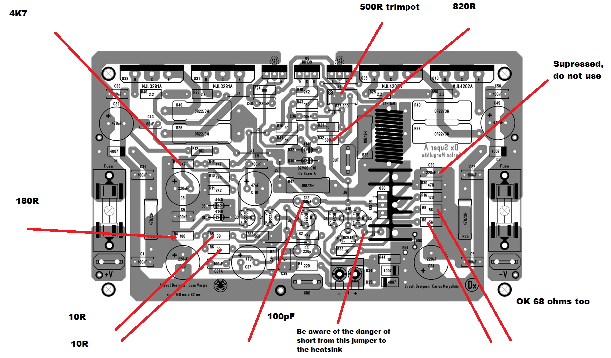

I have finished DX super A. good sound but im not set 2.5V on resistor 10ohm/10w. I tried but it just is 0.5V???
wrong trimmer value? if I recall (R37) it should be 200ohm...(wrong)
ps. I've just noticed from the last update it should be 500, isn't yours a 50ohm?
hello nguyen
check the trim pot maybe is either the value or one of the leads is not bypassed by the other one leads or, maybe one of the resistors that is on the area of the bias circuits the value might be too high "check trim first" the trim can be 500ohms 🙂
this image show annotations from Carlos
Best Regards
Juan
Best Regards
Juan
