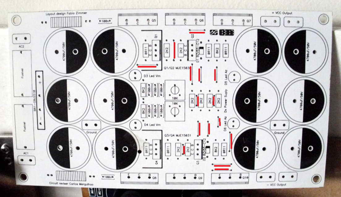

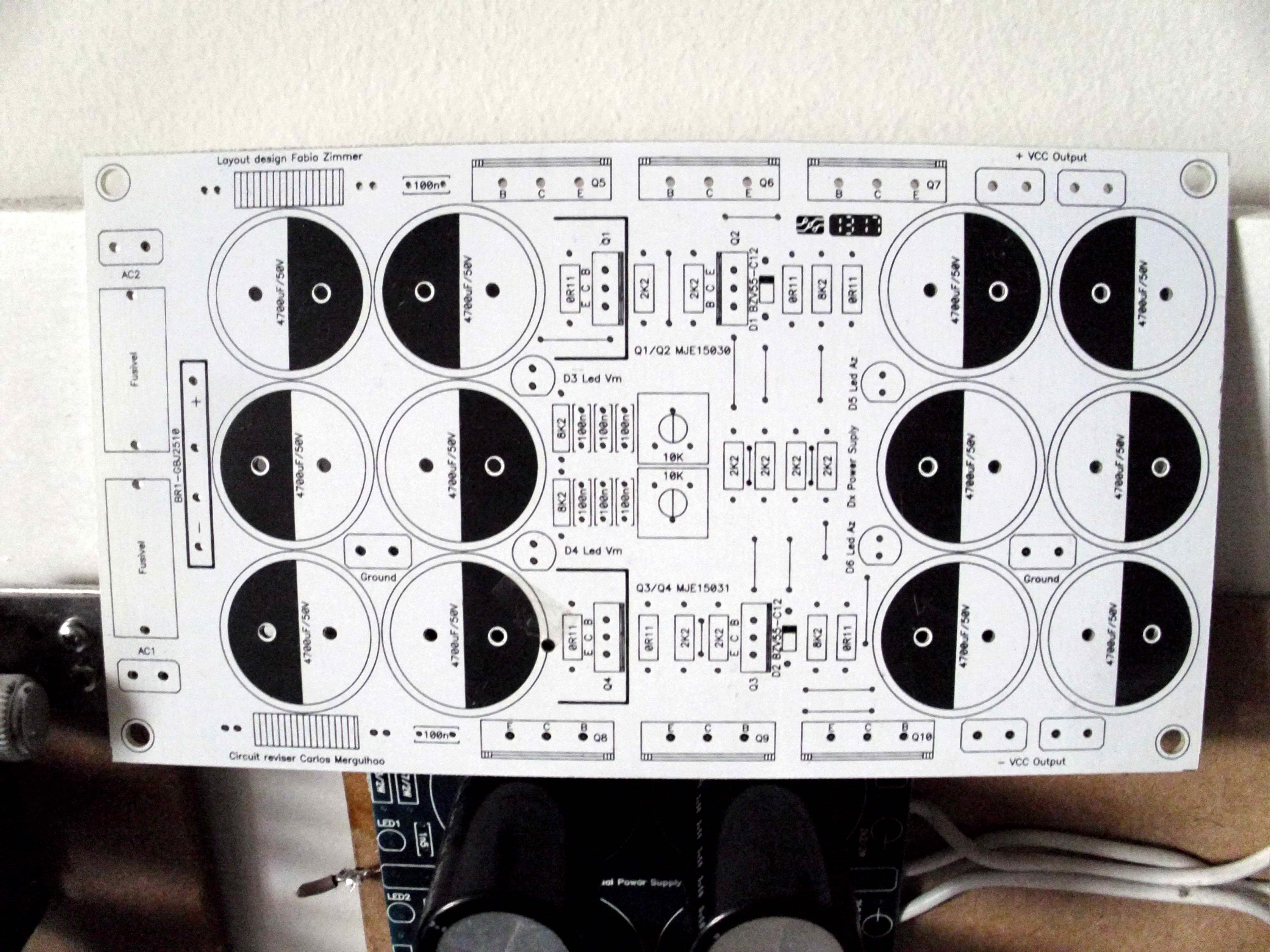

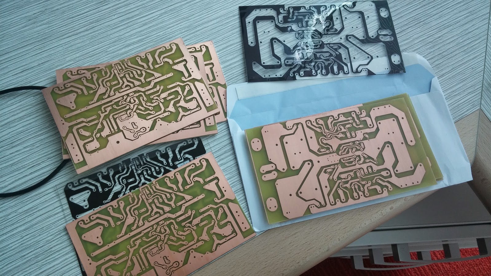

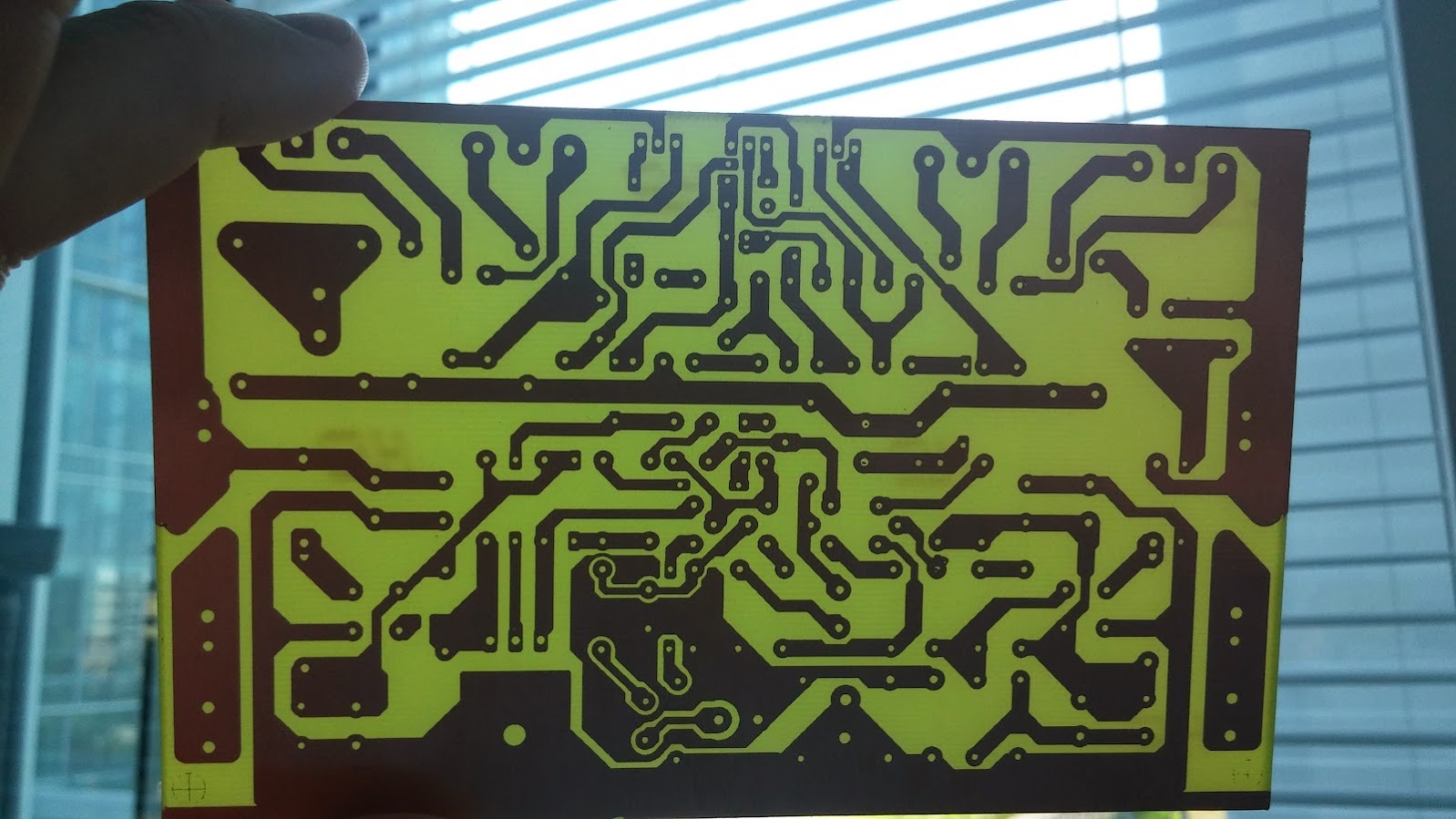

Dear Carlos,
I will use PCB, which are already published in #986 .. I hope, that they are OK..It´s Zimmer design...
Marcel

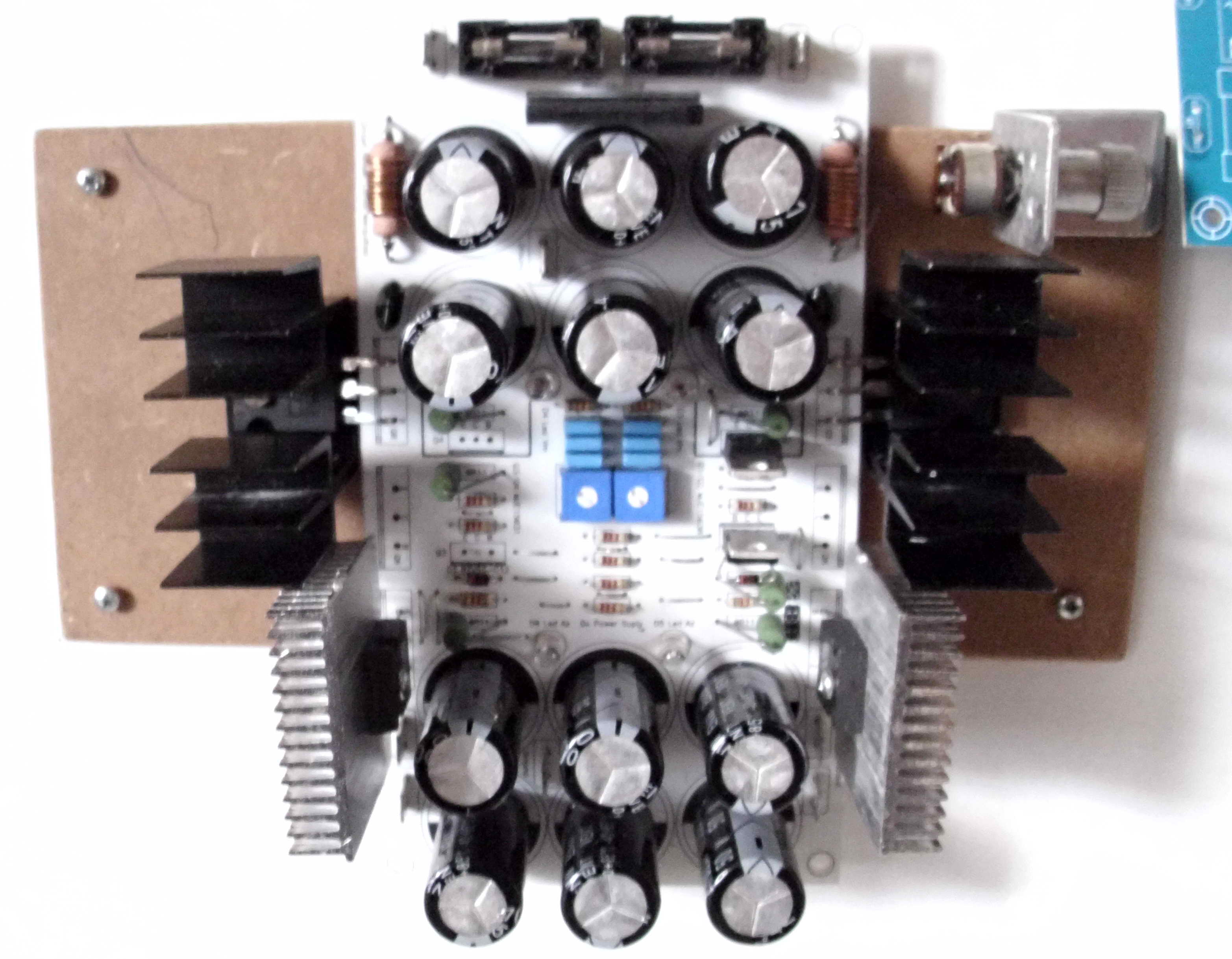

Yes.... pcboards tested.... published layout checked
I am using it at home....i have three unit etched at home inside my amplifiers..and the one show is being installed in my workbench.
Workbench unit is to 20 plus 20 watts dissipation only... voltage entering is 40 volts when lightly loaded .... if i adjust it to 36 volts to a modern JLH (for instance) then i will have 8 to 10 watts each rail drained from the supply.
"Input voltage minus output adjusted voltage multiplied by the ampere drained is the power you will be asking from the supply"
Juan Supply pcboard was not assembled because lack of some capacitors in my stock...but it also works fine.
Sorry...pictures distorted because of camera lenses
Be aware about the wire jumpers.... cannot forget these links made with wire..... leads of resistors or telephone wire.... i use to forget them....as a result sometimes things i assemble fails

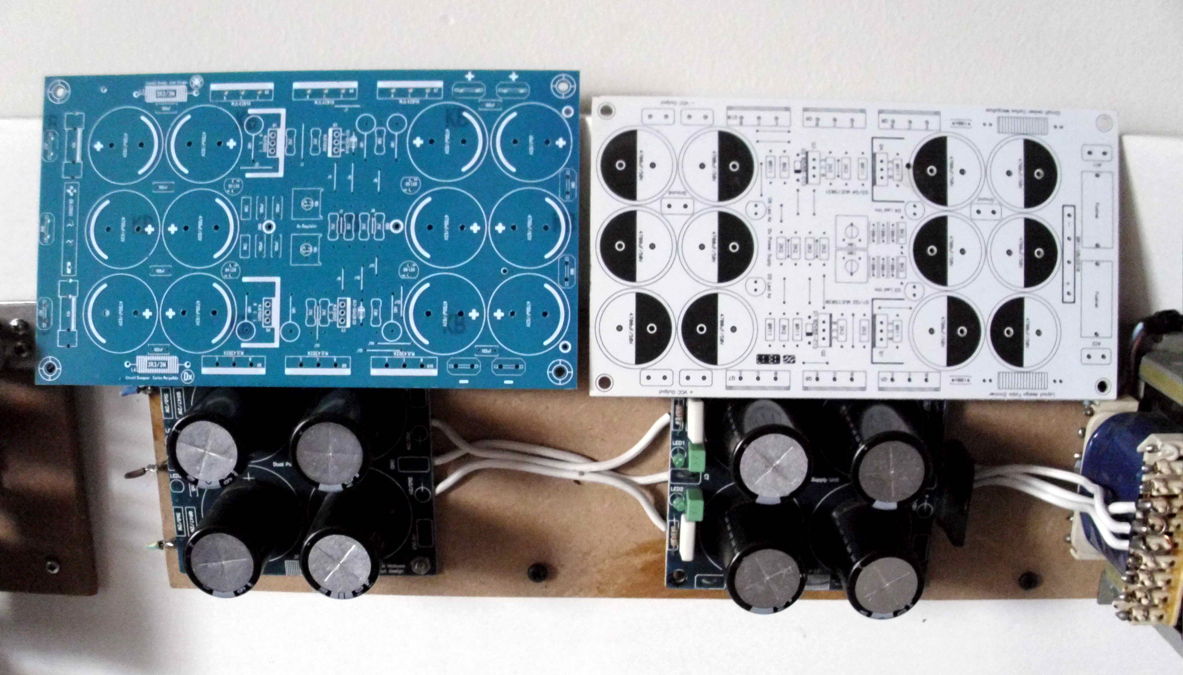

Looks very nice Carlos,have you posted somewhere the schematic or the pcb?Dx Supply installed into my workbench vertical panel...out of the way not to bother my work into the horizontal flat table top... it has voltage adjustment from plus and minus 12 volts to plus 48 and minus 48 volts (5A+5A)...it is adjustable as you already understood, stabilized within 1 percent with electronic filtering (capacitance multiplier effect) to supression of ripple.
Not finished to run cables..i am thinking to run cables from behind the vertical panel...not decided yet.
