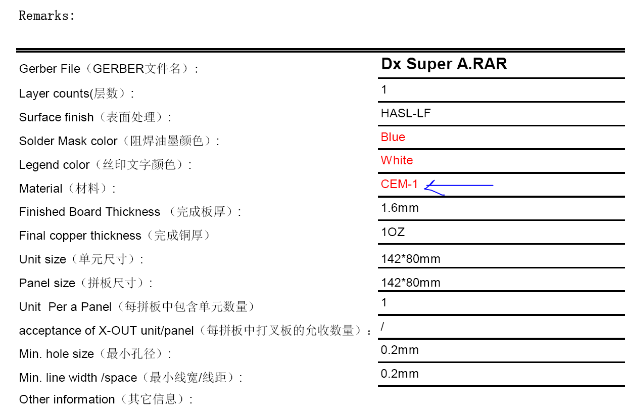

Uoops!... Juan made the mistake
Thank you, we gonna hold on the production to fix the stuff.
This was his last modification..... we have cutted and removed the pcboard excess.... the pcboard was tested... the mistake only in the silks screen of the power ones

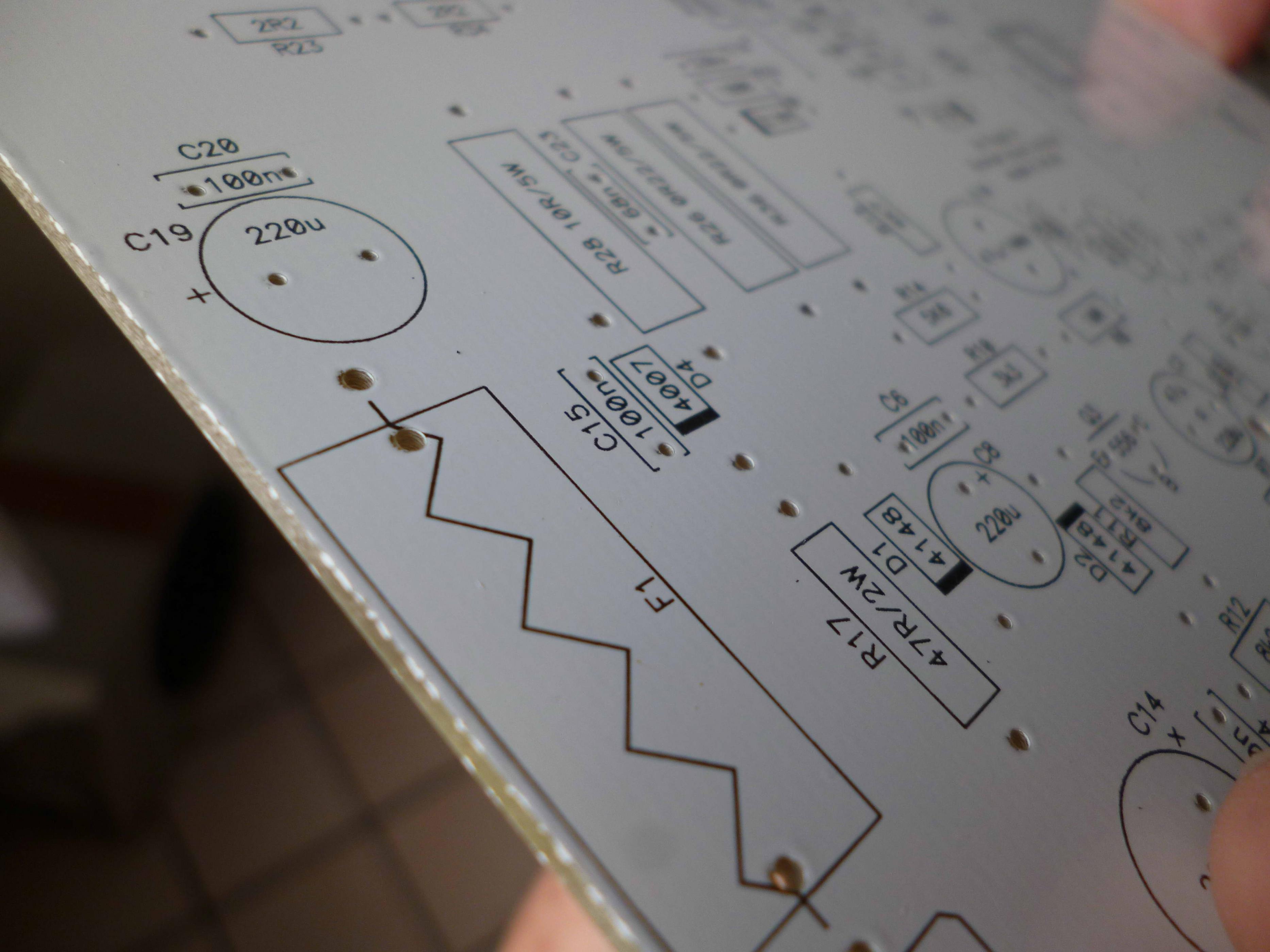

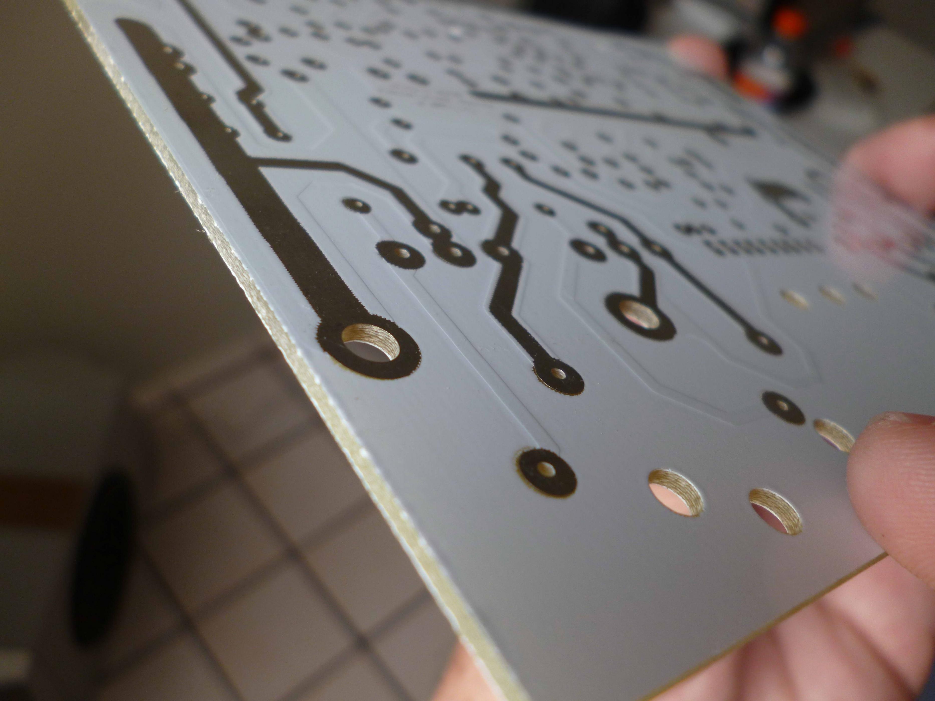

Brazilian pcboards are painted both sides
The ones you gonna see in the video to be posted next, you gonna see a prototype ordered from the factory for testing purposes.... it is painted only in the solder side...the real pcboard will be painted both sides.
Juan is in contact with China to make it painted both sides too.... also will order a polimer to the pcboard...the CHEM1 material that makes the fiberglass more transparent and with a light green alike colour....then Juan pcboards will have better quality compared to the Brazilian ones..will have same features and better polimer to the pcboard material.
Zimmer informed that prototypes were made with a cheaper material to the pcboard itself.... not a fiberglass to the prototype to be cheap to test the pcboards...the real ones are pure fiberglass.

Fixed in the pcboard order dear Ranchu32
Thanks a lot by your help...the eagle eyed man......good!
He will order pcboard material of CHEM-1.... a polimer...a better material, a kind of better, strong and transparent fiberglass, that will increase the cost for use but will be better material for people to have.
Very good.... they are sleeping now...no problems..they have not started the production yet.

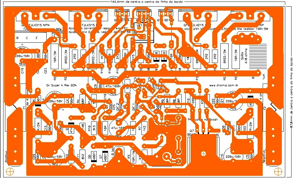

More files from Zimmer...the Brazilian pcboard, soon available for shipment
Make your reservation if you want these ones...this will help Zimmer to order 200, 400 or 600 units.
Also make reservation for Juan international pcboards if this is your choice....he will order 50 kits only..they gonna vanish in a blink of your eyes.... because very few pcboards.
Price gonna be 37.5 for the kit...including two audio amplifier pcboards and one supply pcboard..no bargain or discount.... we arranged the same features to both pcboards.... Juan is blue with white silk screen and Zimmer is white with black silk screen....Juan is CEM-1 pcboard material (polimer) and Zimmer is fiberglass.

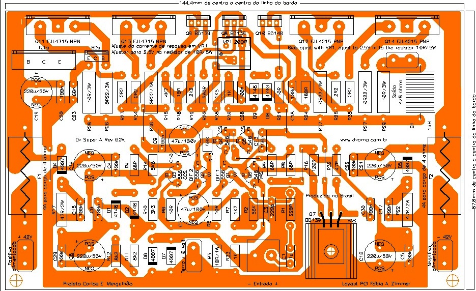

One more file about the Dx Super A - Zimmer layout
Brazilian layout now in preparation for shipment.... one month more and will be ready to go.
Juan pcboards will be available soon..but will vanish soon too because only 50 kits.
Make your reservation.... Brazilians are 180 millions...they want the pcboard too!
Dx Supply files are posted in the Dx Supply thread.... previous posts show you the link to the Dx Supply thread.

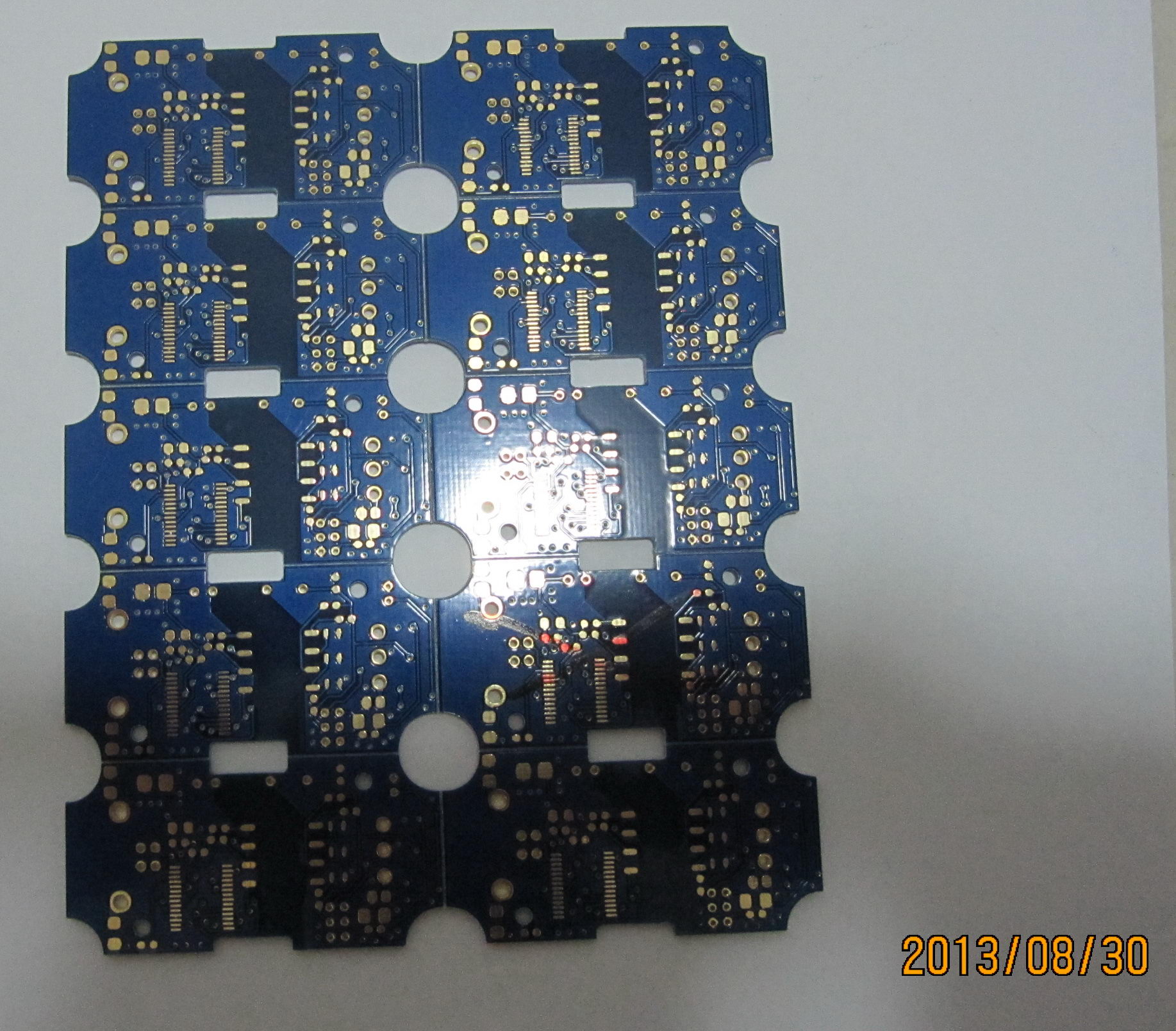

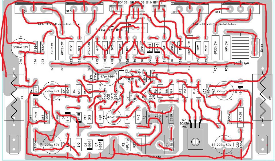

We go still checking.... Dx Corporation does not give room to chance
We guarantee our quality.
Not only Zimmer,.... i am checking every detail and also Juan...not to have failures.
The red line method give us guarantee that everything we have in the schematic is really in the pcboard..also let us check if we have made too much long lines and the distance, the gap, the clearance in between them..also thickness is evaluated.... so..prior to order the manufacturer we go checking..not a double check or a triple check... each one of us check it at least 4 times.
Juan has stopped all his other activities to check his stuff too.
