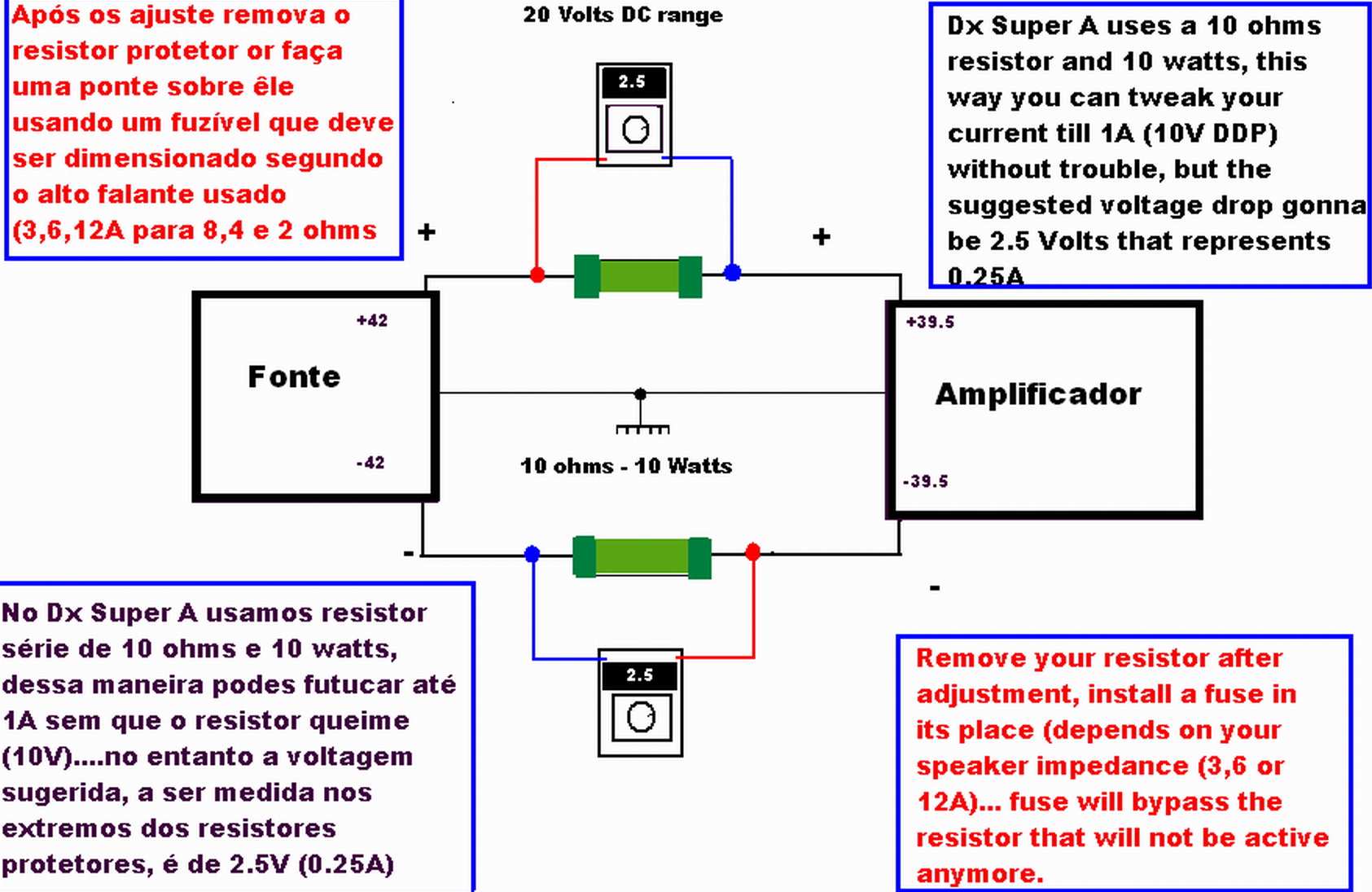

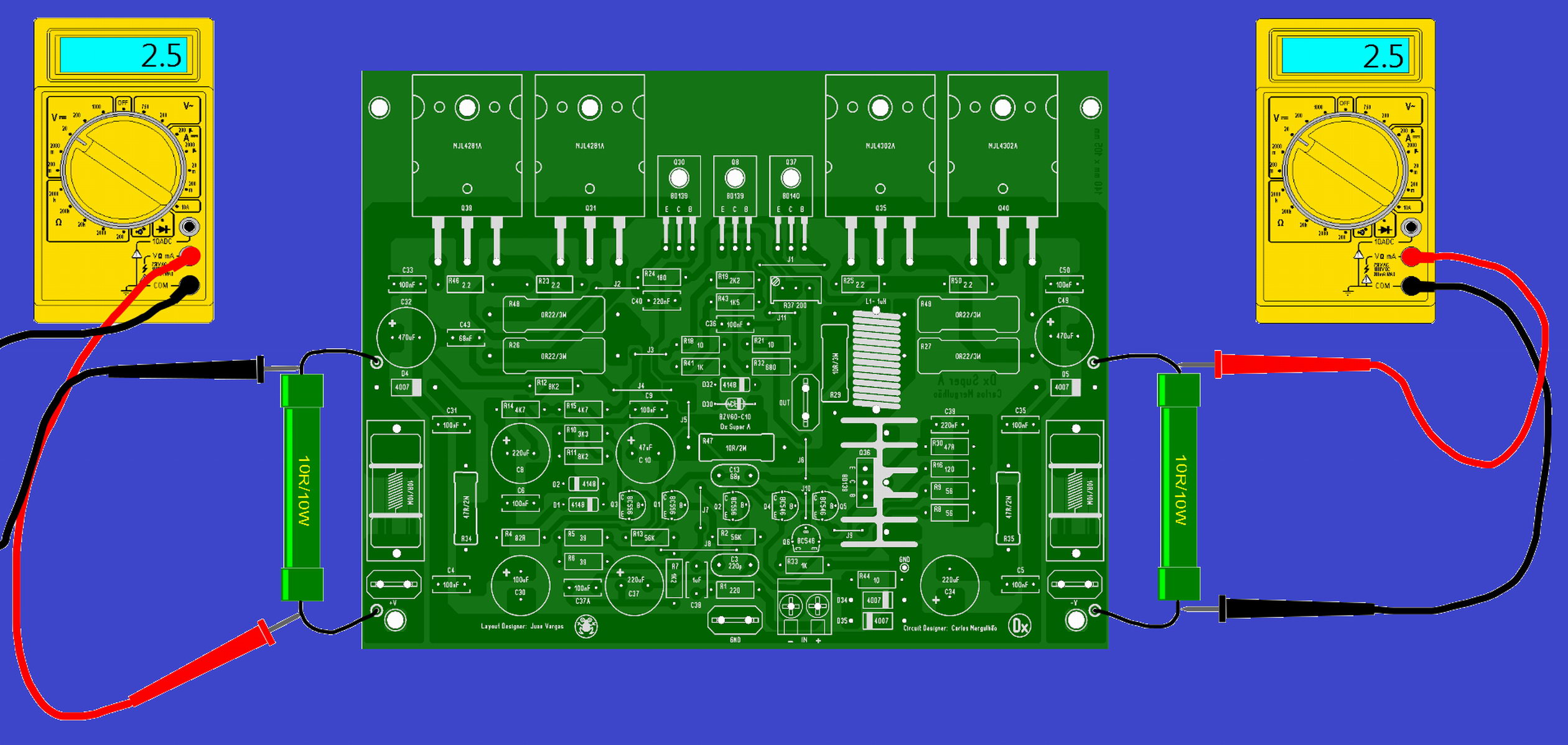

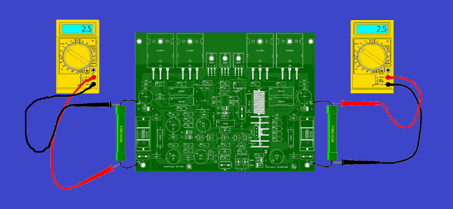

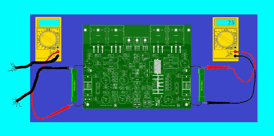

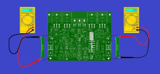

Here you have the adjustment setup

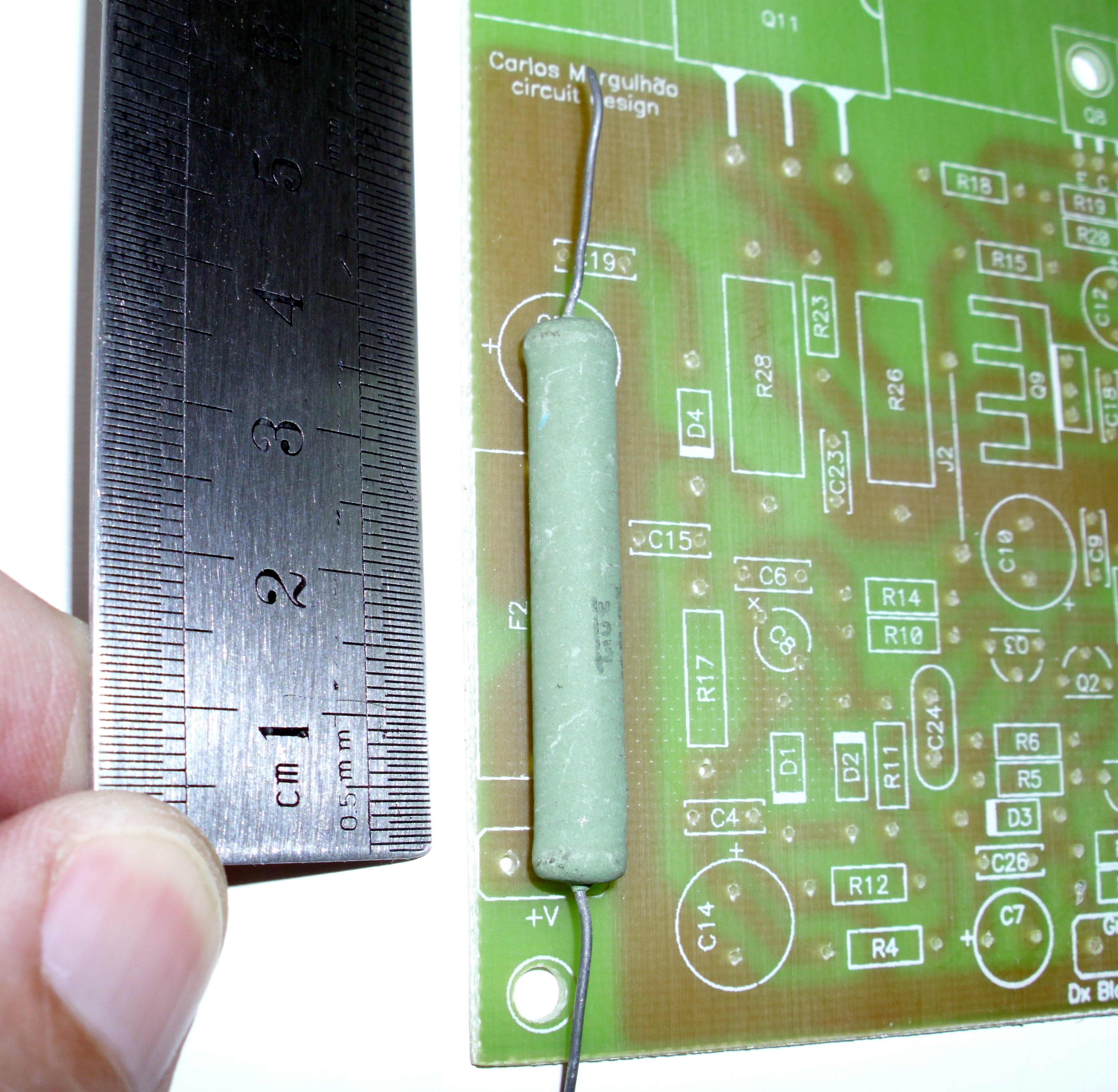

You may have this protective series resistor on board, or maybe not...we are still thinking about it, as people may burn the fiberglass with some kind of misadjustment or errors into the circuit board assembly... fuse socket is to be installed on board..but resistor may be outside, in between the supply pcboard and the power amplifier pcboard.... installed to adjust and them removed.
Image attached,
regards,
Carlos
Image attached,
regards,
Carlos
This resistor watt rate is an overkill
2.5 volts over 10 ohms, means 250mA and this result in 625mW
But 5.0 volts means 500mA and this result in 2.5W
If people try 700mA, then the voltage drop will b 7 volts... results in 5W
But if people make mistakes into the amplifier constrution, shorts and things alike, misadjustment into the bias trimpot..them the current can be several amperes and even the 10 watts resistor will smoke.
This watt ratio will be good to the tweakers...for sure they gonna try 1 Ampere, they will regret and will return to 0.25A
The VBE multiplier working as heat sensor is unable to compensate when the heatsink is too much hot.... so.... with huge dissipation of 60 watts each rail or more, the heatsink will be so hot the transistor will not be able to reduce in the ammount we need....this way...or you use small current or you install dual super fan blowers and giant heatsink and install this devil machine (hot) over a block of Ice in Siberia or Sweden.
Big mistakes will smoke protective resistors anyway...well....they are there for this reason.... to avoid excessive current into the circuit board and to burn opening the circuit alike a fusistor.
regards,
Carlos

Your left multimeter will not read...because no black cable
The one at post 304 is defective.

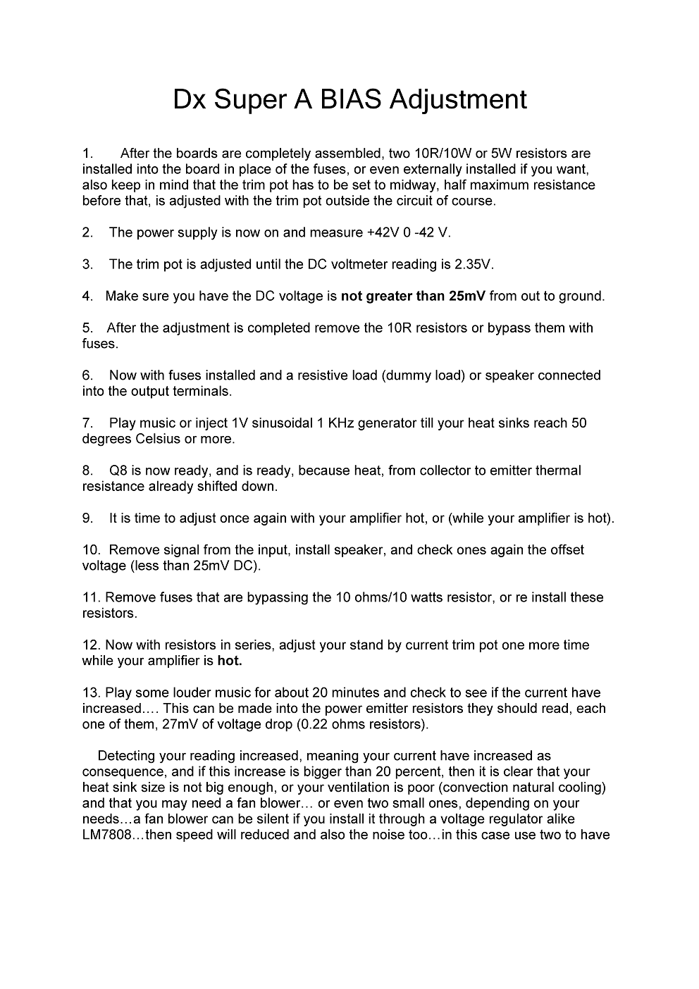

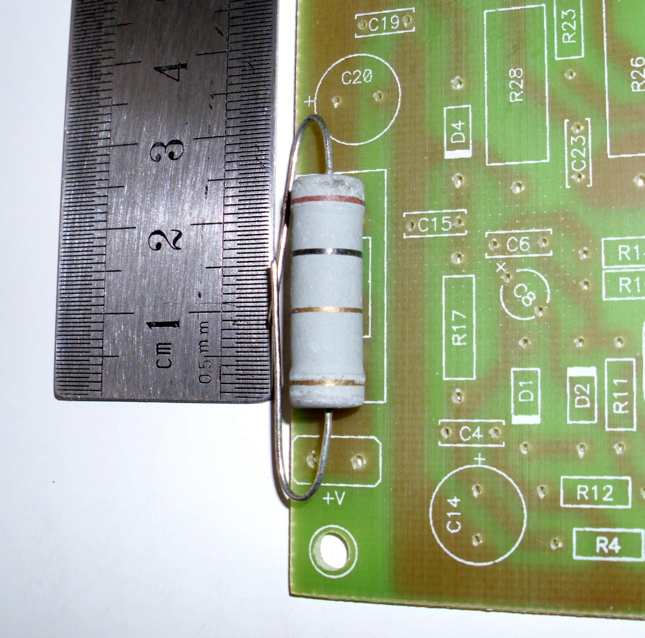

DX is suggesting that some Members/Builders may want to use the fuse alternative resistor to check for amplifier current when using Ibias approaching 1A. Don't do this.
If the PSU is putting out say +-40Vdc when the amplifier is not connected and this drops to +-39.5Vdc when the amplifier is connected then the setting of the bias will further reduce the supply at the amplifier power input terminals slightly, maybe down to +-38Vdc when the bias is set to 100mA to 200mA.
If you insert a 10r resistor instead of the fuse, then the output bias will change from the set value. It might drop to 10mA, but much worse the supply voltage after the resistor will drop badly.
200mA through a 10r resistor will drop 2V.The amplifier will have +-38Vdc at the power terminals but it will only have +-36Vdc after the resistors.
This gets MUCH WORSE if you set the bias to 500mA, Vcc/Vee becomes +-33Vdc,
@ 700mA: +-31Vdc, @ 1A: +-28Vdc
DO NOT SET output bias with resistors replacing the fuses.
The amplifier must see the full supply voltage when you set the output bias.
Use the Vre method to check the output bias current.

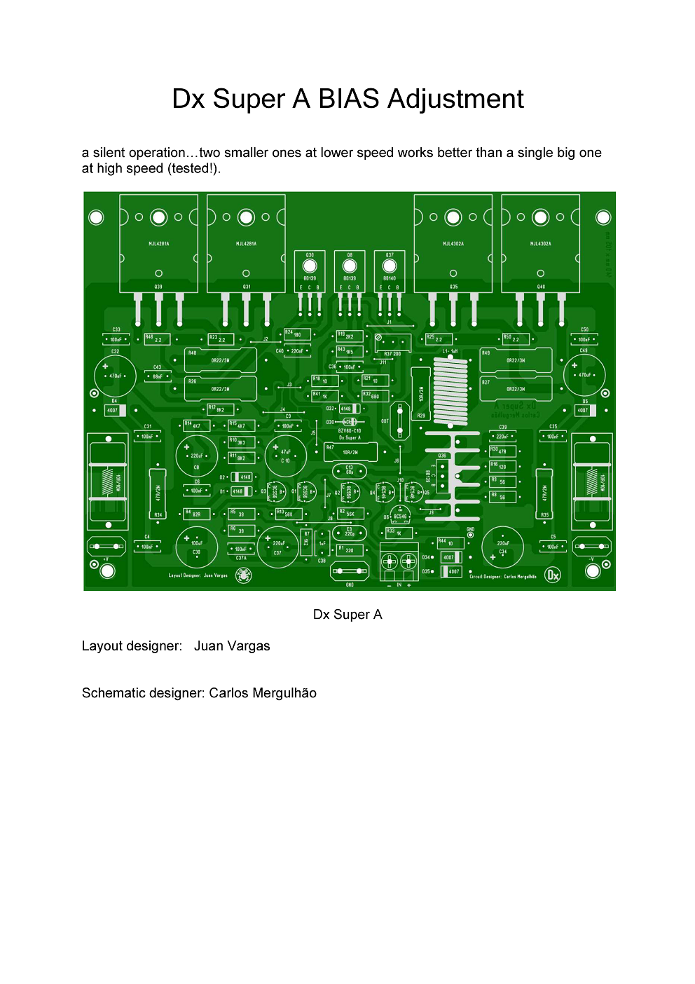

Dx Super A BIAS
Here is a quick instructional information of how to adjust the bias on the Dx Super A. 😀
Regards
Juan
Regards
Juan

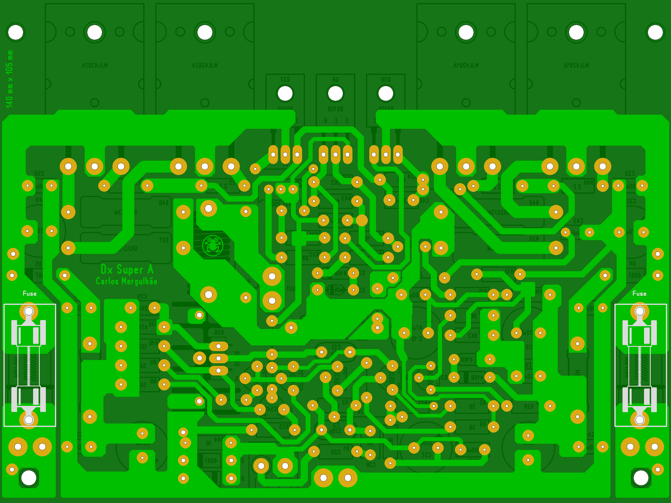

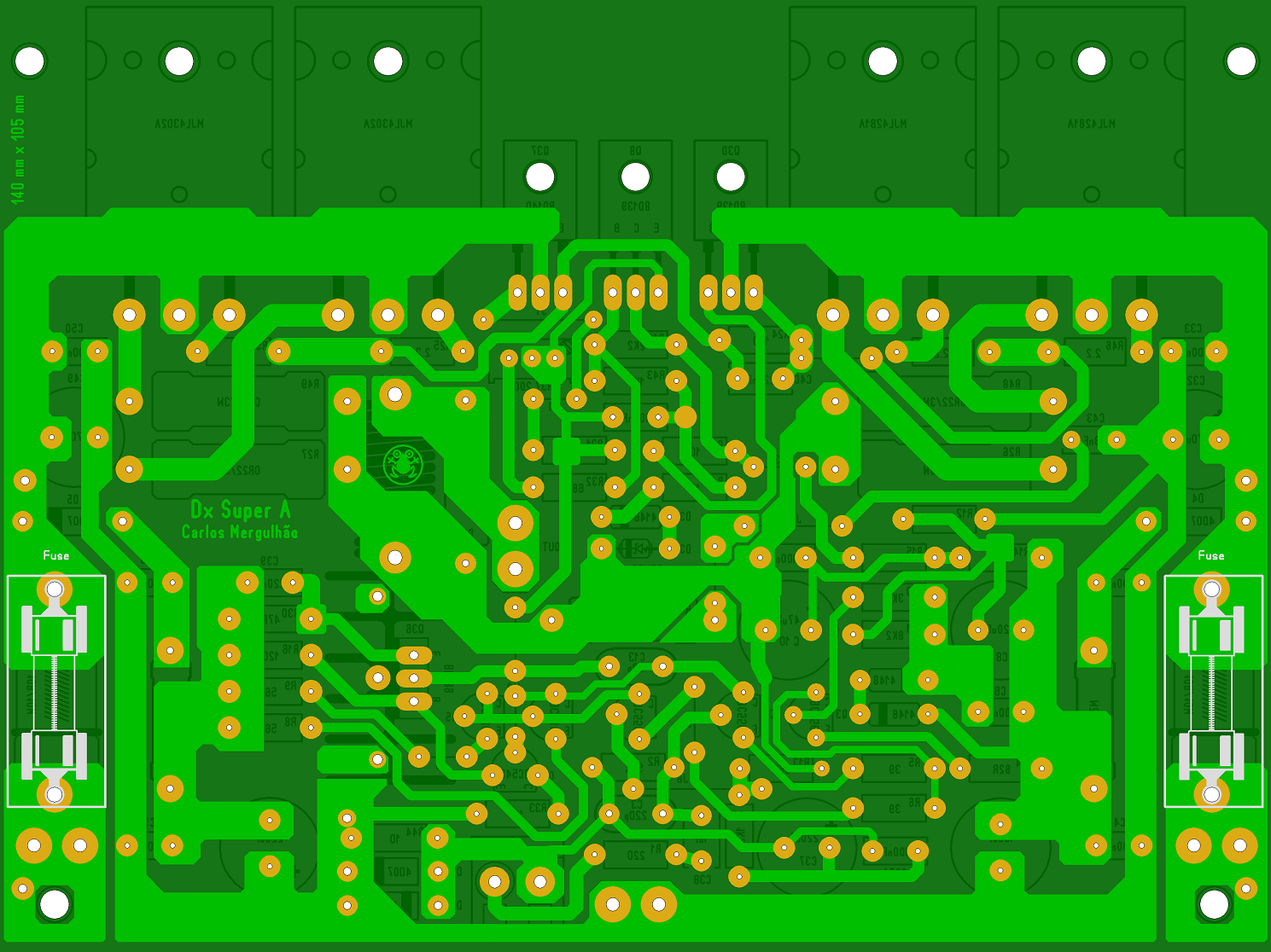

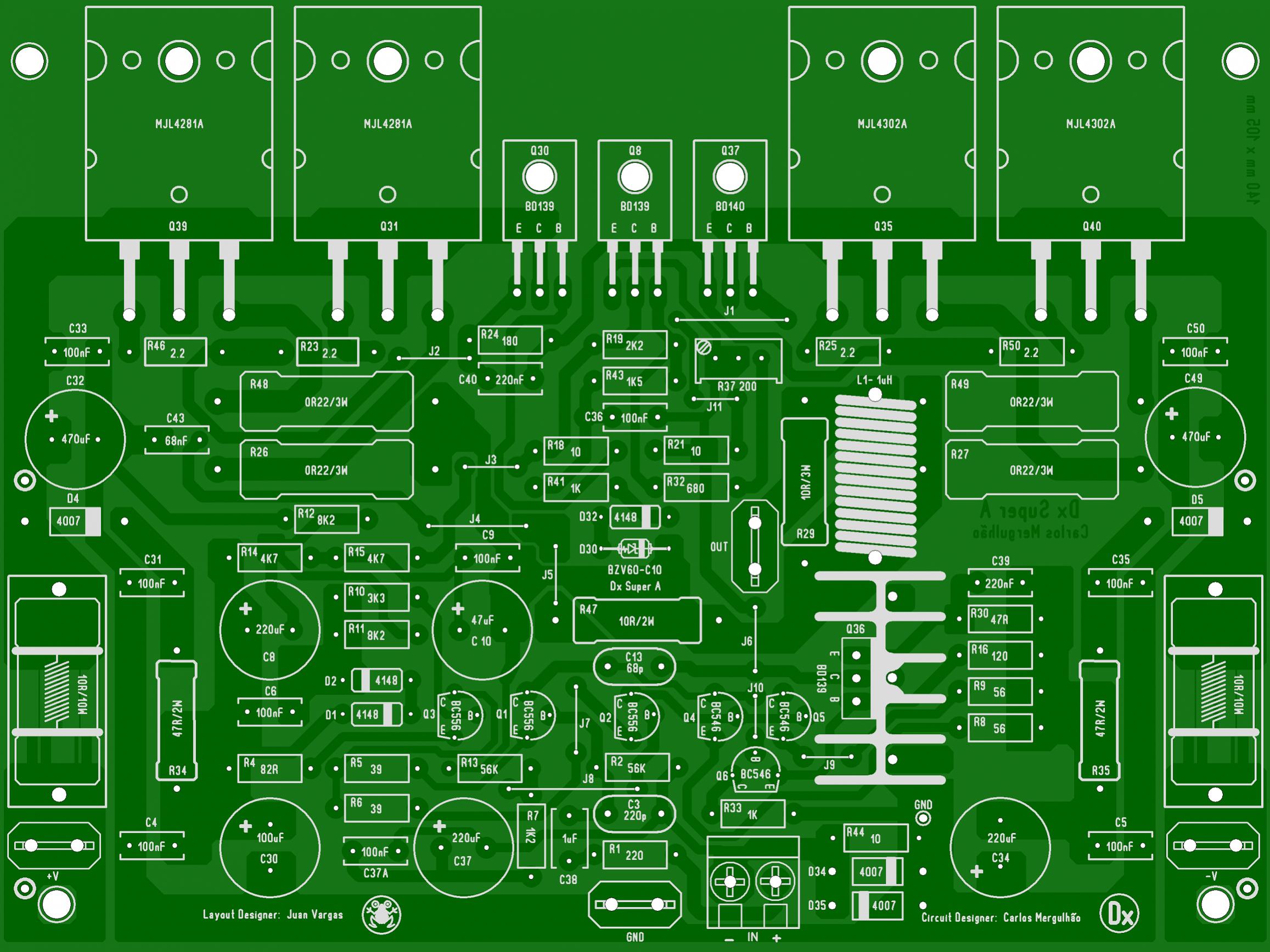

Here are the files for etching hot iron and UV light sensitive boards, there are confusion of if the files is mirrored or no I'm giving you both normal and mirrored files PDF format. 😀 chose the one you need not all printer work the same way.
Regards
Juan
Regards
Juan
