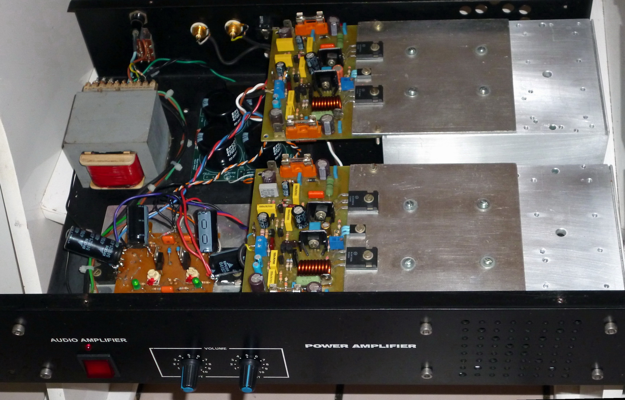

The known solution to this, of course, is to split R19 in two, and take the Q7 base from the junction. The series resistor values allows the desired bias current to flow, while the lower resistor is sized to allow some (safe) higher current to operate Q7.
Leach shows this.The known solution to this, of course, is to split R19 in two, and take the Q7 base from the junction. The series resistor values allows the desired bias current to flow, while the lower resistor is sized to allow some (safe) higher current to operate Q7.
I'm having another look at your Blame ES schematic at Greg's website here: DX Blame ES, ST, MKII, MKII Supercharged
I think you got it right Carlos; it is going to be very difficult to improve this. It is similar to, but not exactly the same as, several amplifiers I have built based on Douglas Self's work.
I like your bootstrap circuit on the voltage amplifier - that is a nice touch.
Sometimes you can use special transistors to make something sound better. The KSC3503 is a very good VAS transistor but I don't know if you can find it in Brasil. Sometimes you can reduce the compensation capacitor for better sound. But sometimes you do it and it sounds worse or it bursts into oscillation. But I'm sure you have tried all these things!
I also have tried Cascode VAS ...no good audible results..sound became vague, not precise...i felt it was lost, loosen...not anymore referenced...the difference we have with driver emitter floating resistors or using dual resistor to the output line..i also quit the cascode VAS.... i am a maniac Ranchu...always trying..... always messing.... testing ideas..... really crazy..... i have readed all books and tried all schematics.... not normal i am..... really i have to accept that....crazy!😕
Cascodes don't work with EF2's ! Not well , at least.
"no good audible results" ... of course.
Put it behind a good EF3 or FET output stage and a cascode is as great
a "jump ahead" as the "blame" was over the original DX.
OS
OS, you should know better than to discuss EF3 in Carlos' thread!! There is something seductive about an amplifier that uses a simple bipolar EF2 output stage, driven from a single-ended VAS loaded with a simple bootstrapped current source.
I haven't had the pleasure of building the Blame ES (yet) but I'm willing to bet it sounds very good indeed, since the circuit is so close to my own circuits that I've built.
But the blames have current sources ... and these are "bad" (4 years ago).
EF3 is taboo , I know. But , EF2 restricts you to high current simple VAS's
only.
A mosfet EF2 would even be a great leap , just as simple (and more durable).
ES is a good design , my next module will be similar (hooked to a EF3😱).
OS
I could not stop it ringing with a 1kHz square wave fed in through a 0.07us input filter (1k + 68pF)....................I haven't had the pleasure of building the Blame ES (yet) but I'm willing to bet it sounds very good indeed, since the circuit is so close to my own circuits that I've built.
Looks a lot worse when 10kHz.
I guessed that the ringing was due to PCB layout, the ground is the type that feeds around the outside of the PCB. The ringing on that ground varies as one moves away from the test reference location.
Both assembled PCBs were the same and have been lying on the shelf for the past year.
Can you listen that ringing Andrew?
I cannot...but i understand...when things are not perfect in our mind we reject.
Fix that ringing and publish schematic related what you have done into your own pcboard.
