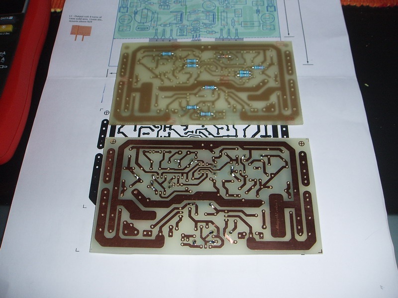

The work is in progress.... soon we gonna have a Dx Blame ST, operating in class A
images attached, captured from the buider's site.
regards,
Carlos

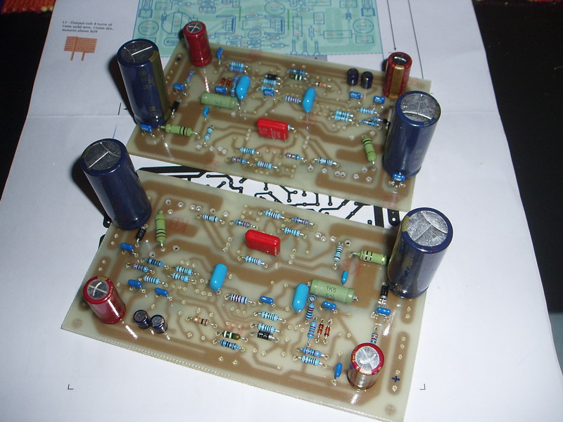

o.k. - some more news in case you don't follow...
pcb is almost finished... i have to put few bigger parts and an output coil...
for power supply i decided to use C-L-C-R-C filtration and a big Semikron rectifier bridge.... (much easier to do and it will give me few extra Volts on power supply...)...
initially i wanted to use only a fixed resistor to have a fixed bias but at the end i decided i will use a resistor together with a trimpot just in case i could not go all the way through class A - i have heatsinks that should be enough for my needs but as you might conclude, they are put together from few smaller pieces to form a bigger unit and this will affect their ability to dissipate heat... so, i maybe don't have enough in heatsinks afterall... i will see that when i start using it (will bias up until i conclude it is enough related to the temperature of the heatsink)... 😛
from pictures Carlos uploaded here, You can see that my pcb is made in a mirror to the real pcb - my mistake... now, i will put every resistor and capacitor from the "right" side of the pcb and transistors will be from the copper side - easiest way to do it... probably emitter resistors will be placed also from the copper side of the board....
Sparkle wrote:
"...From pictures Carlos uploaded here, You can see that my pcb is made in a mirror to the real pcb - my mistake..."
That is why always write a text, some words, on the copper side.
If you can read your text after the PCB has been etched - the PCB is o.k.
If you can't: the PCB is mirrored.
Best regards - Rudi_Ratlos
Rudi - normally i make pcb's by myself and have a method of doing that in a correct way.. Carlos didn't know that i need them in "other way" and my mistake was not to check... 😛 not a problem really - only more mistakes possible.... 🙂
have to check several times more in order to avoid them 😛
at the end - it will not change the sound of the amplifier (if everything works like it should) and maybe this is even better - the pcb is small and this way i will get a bit more room on the part side of the pcb 🙂
heheheheheh
thanks for looking into this thread 😛 best regards
