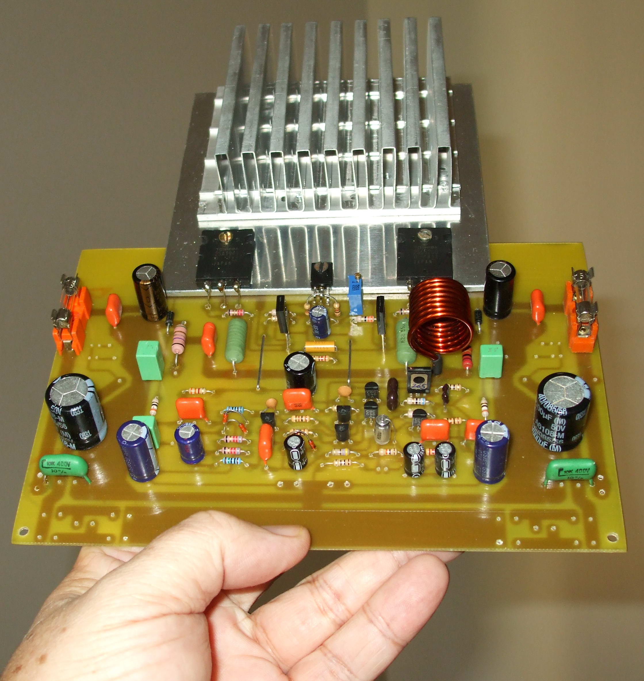

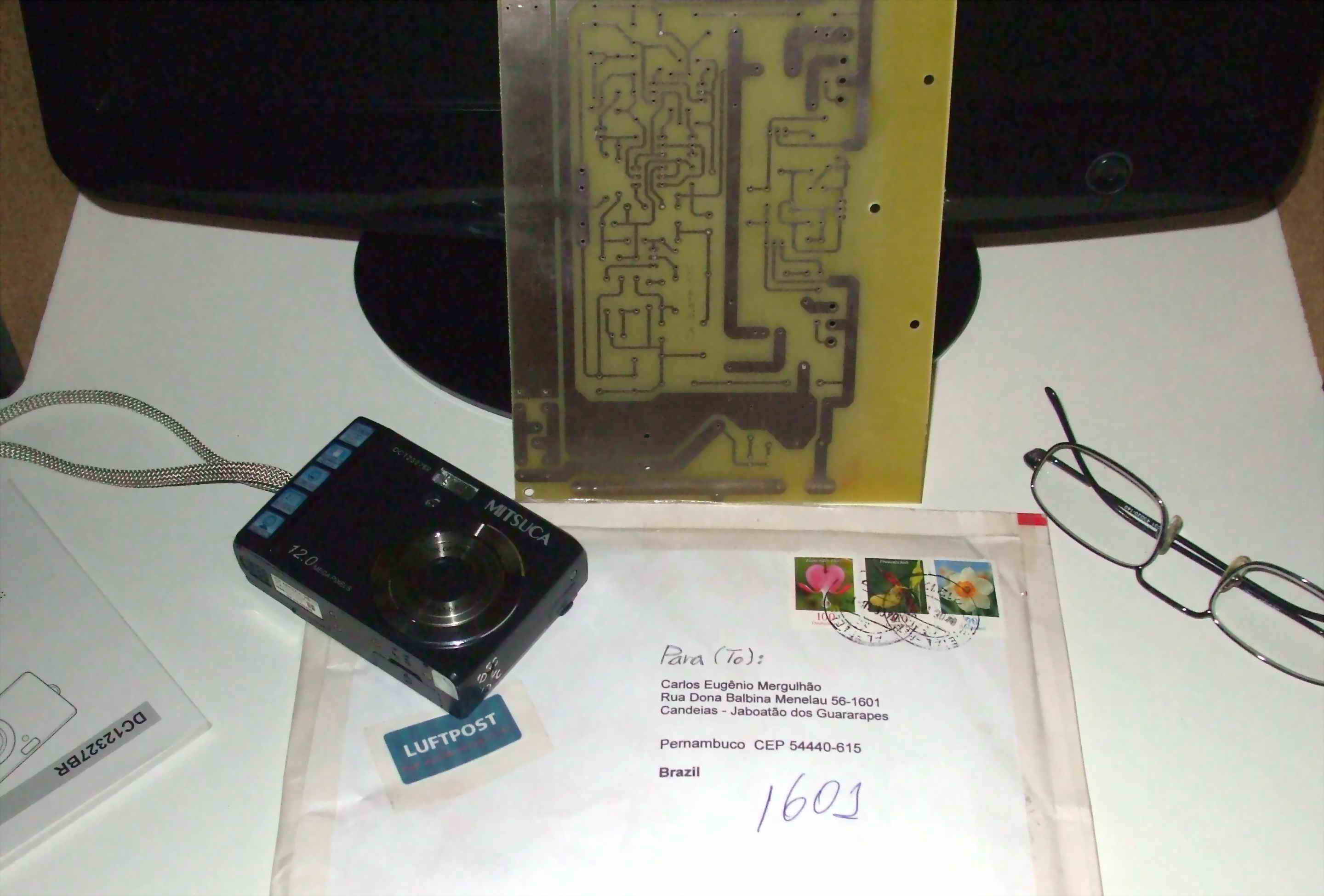

Have arrived since friday... daugther forgot to say.
This board was prepared by Metal..he did the layout and Rudi_Ratlos ordered and sent me for testings
I will manage to build, will not be fast, as i am making medical examinations to operate..so...i am a little bit busy.
Thank you Rudi and Thank you Omar (Metal).... the board arrived June, 17th
regards,
Carlos

I will use this image to help me to assemble.
I have found the board really huge...enormous board...but i like it.... very well done!

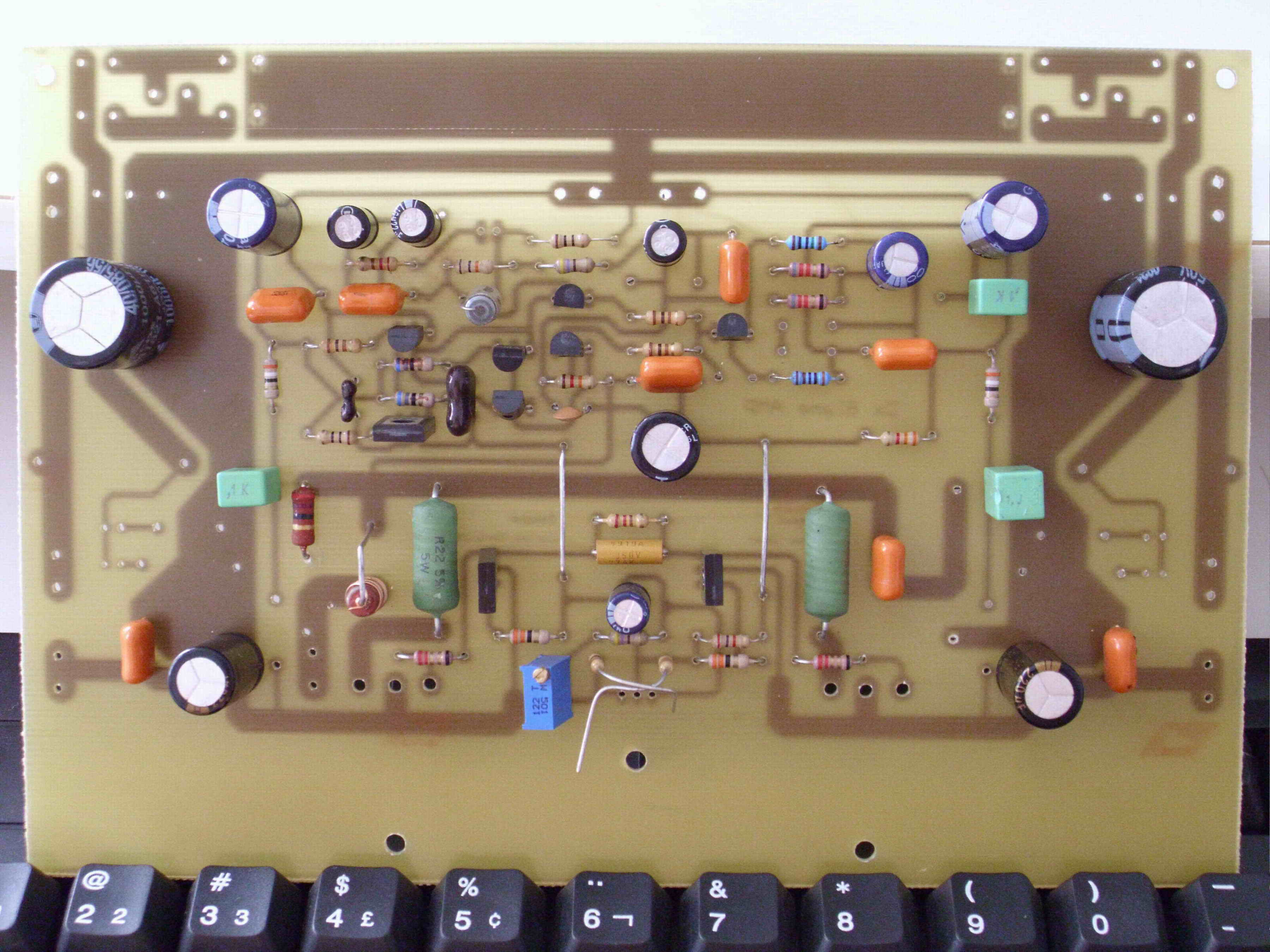

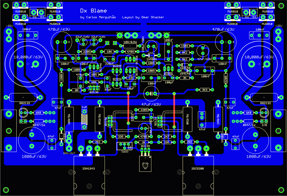

Dear Carlos,
Metal and I felt as well that the board is very huge and we gave up our idea to integrate the PSU on the AMP's PCB.
The PSU will be offered on a separate PCB.
So please: concentrate on the AMP's circuit.
The layout of the AMP has not been / will not be changed.
Best regards - I wish you all the best - Rudi_Ratlos

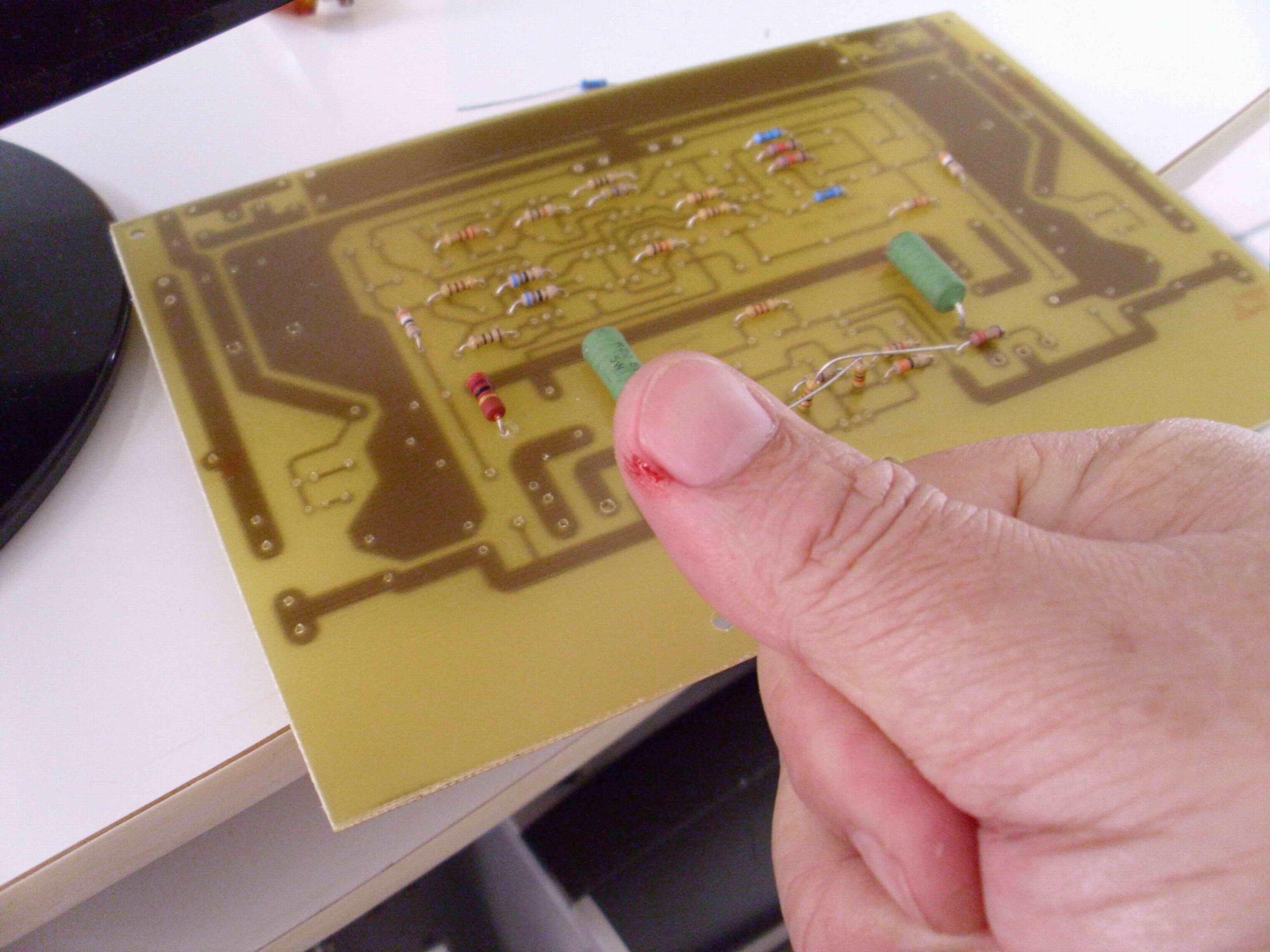

When searching for parts to assemble, dear Rudi, i will not search
R2, C5 or Q1....i will search for values.... XX ohms for R2, XX microfarads for C5 and XX for the transistor.....i have not part printed R2 in it's case..we have colour strips to resistance...because of that one first translation will be needed.
So, this board, specially prepared by Omar, kindly prepared i would say, will be much more helpfull to me.
Of course, to talk about the amplifier, having reference numbers is much better..so, reference IDs are needed to describe operation or to make reference to some part.....but in the assemblage moment, construction moment, boards having values printed on it are much easier and faster.
No double check..first have to translate R2 to see it's value..then to find the part to install.

A new star is born (I hope so - at least):
METAL and I refused this design (after the prototype has been etched and I held it in my hands).
The resulting PCB was simply too broad and we left - at this moment - the idea to implement the PSU on the AMP's PCB.
I like the AMP - section very much.
The components "have space" around them; you do not need an magnifying glass when you solder. This PCB can be soldered by everybody.
And remember: this is only the prototype.
The PCB METAL and I will eventually offer is etched in a professional way.
With soldermask, silk-screen and will be contacted through, no bridges have to be installed.
METAL and I have spent many hours with the CAD (EAGLE) -design of this PCB.
I wonder if Carlos will get this PCB playing.
But since he is the best and since I am sure that I have not overseen any errors in this PCB's desgin: he will.
And while Carlos is still soldering, I am dreaming about the second generation of the DX Blame PCB:
This one (something like this (120 x 130mm), as an alternative) will be offered one day, for sure, but there is still a lot of optimisation Metal and I have to do.
Best regards - Rudi_Ratlos

This is why METAL and I decided to create a PCB for the DX Blame that will support all members of the DX Blame family: be it either the Blame ST, the Blame ES or even the Class A of the DX Blame family.
METAL and I did this using a professional CAD software (not only offering a PDF - document): EAGLE.
What you see on the images above, Holger, is an universal DX Blame AMP-PCB that will be eventually offered in a very profesionally etched way.

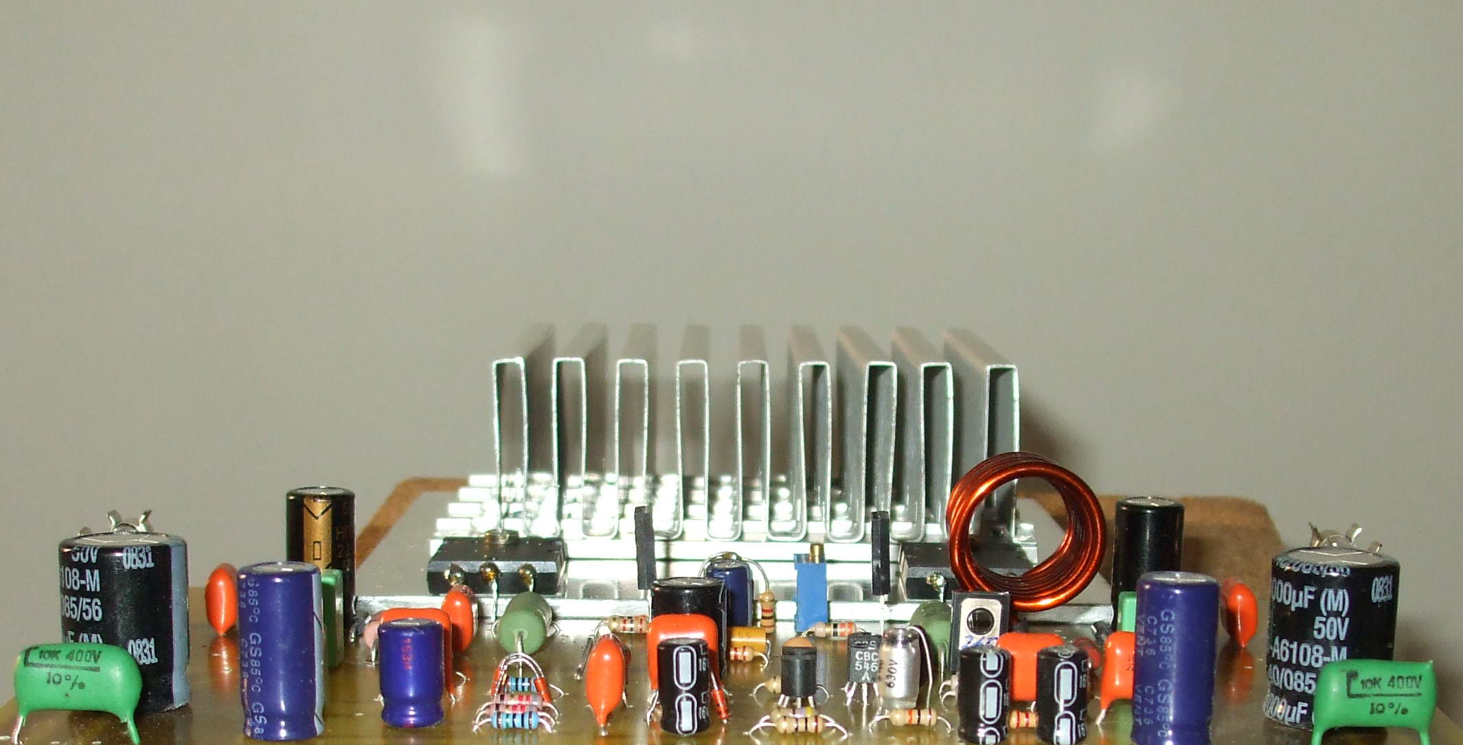

I have not installed the supply.... i feel you will remove from the board..and this supply is to the ones have two transformers of 25 VAC.... transformers with 2 wires in the secondary....strange approach.
And made without short two wires to result three wire transformer.... well.... will forget the supply.
The board is giant... in my imagination you should reduce dear Rudi and dear Omar.
Tomorrow i will be listening...do not feel envy..you have yours..and will sound the same.
Are there errors in my construction..the parts i introduced in this board?... for sure there are several...i will fix them tomorrow.
