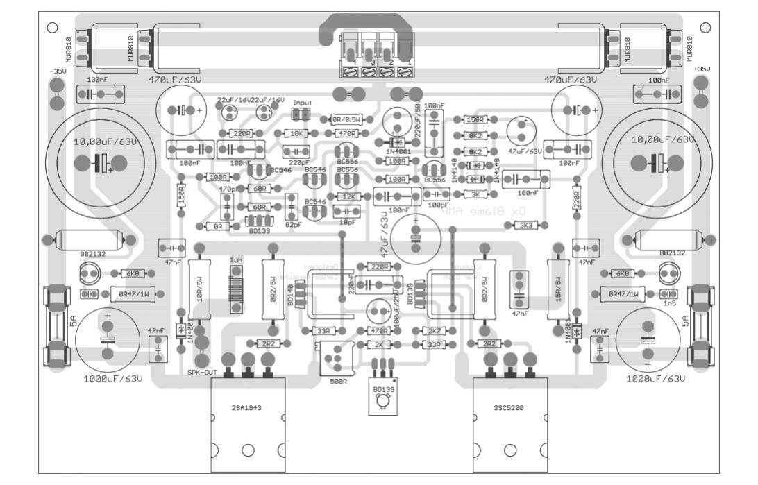

You may have lost the point Krachkiste.... Rudi, decided to make a different layout
based in Todd Johnson layout..almost the same but with some minor modifications.
The idea is to produce the old amplifier, the Dx Blame ES, having room to change/replace parts to turn it Dx Blame ST circuit.... so... two circuits in the same board...the option belongs to the builder.
The Dx Blame ES uses the NFB..the capacitor is in the board..the Dx Blame ST does not use the NFP capacitor, so, it is to be removed.
This was the "spirit" that moved Rudi and some friends.
The amplifier (circuit, schematic and layout) , the official one, the guaranteed one, is Dx Blame ST is the one made by Todd Johnson and previously produced and tested several times.... this new board, when having the Dx Blame ST schematic assembled will be guaranteed too.... but if assemble Dx Blame ES..guarantee will be void.
This amplifier layout was something Rudi and a small group of friends tried to ressurrect..to bring the Dx Blame ES to live again.... also producing a marriage... in the same board, room, indications that allows the builder to decide the one he want to assemble... at least, this was the target.
I have said and i will repeat...the Dx Blame ES is not guaranteed, it has some technicall mistakes, some wrong decisions taken into the schematic...but... despite that, it sound better than the Dx Blame ST that is the official, safest and more technically correct schematic.
You, dear Krachkiste, should read more..to know what happens in the thread, because this was hardly explained, and several times,written in this thread and also in the Dx Blame ST thread, builders thread too... and it is proved you do not use to read the entire thread... an even this way you post questions already answered that you could have readed saving me time and saving me work to explain you, once again.
The use of Dx Blame ES schematic is "up to you"....a "builder decision".... builder "take the risk"... and i think they can, because there are several Dx Blame ES, despite received some criticisms, that are operating fine and super stable...but, as it is not perfect technically, i do not take responsability and also do not feel confortable to point it to guys to build.... this way, having troubles, people cannot complain or, for sure, i will not accept complains..i said not indicated, not entirelly safe...but even this way..by an accident of the destiny, It is the best audio amplifier i have ever listened too..with drunk or defective electrons circulating, wrong circuit decisions taken, wrong technics applied, mistakes, slow downs and all flaws, it is the best in sonics, and able to beat all i could listen.... try to assemble and compare with others and you will know what i am talking about..not building will never know.
The unbeatable one!... sadly, does not match theorists and tecnocrats ideas and they have worked deeply to burn that amplifier image...i had to change the name to save it to be smashed in public... at least..these will not build...they will build the ST.... good one, but not the best one.... that's my revenge... technocrats will have the second, nor the first!
The real clever guys, also the ones read the thread, will understood my message, they will take the risk and will build the Dx Blame ES..the non guaranteed one ...but the one is a ticket to your best sonic dreams!

Hi Metal,
Are you producing the PCB silkscreen with the values on it? If so, I would recommend to use the component names only. The values will change through refinement or error and so your PCB is no longer accurate.
Please remove my name from the PCB, as I have not contributed to this project.

I had some time today (it is an official holiday today in Germany) and took a closer look at Volker's second board.
You remember: one of the boards of Volker's second DX Blame worked like designed, the other one did not.
What I saw at once was a resistor - "melting away".
This is R22, the rail-resistor, having a typcial value of 150Ohm in the ES version of the DX Blame family of AMPs.
The rail-resistor connects to Q7, the 1.st VAS, which is driven by Q6, a BC546 NPN - transistor.
Since I couldn't spot any solder error or misplaced component in this area, I un-soldered Q6 and look what I found at this position:
a BC556, the complementary brother of the BC456, a PNP - type.
That must not be.
Human error.
You need new glasses, Volker, and you owe me something.
