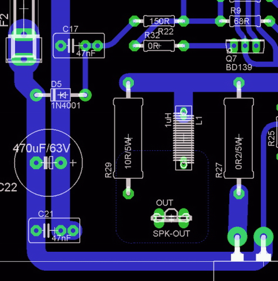

This afternoon was not as successful as I hoped.
One of Volker's new DX Blame / PSU boards (Todd's offcially released 1.4 layout, Greg'S DX PSU)
worked form the start, could be easily adjusted to 4.7V, no component getting warm, .... success.
But the other one:
After power-on: no explosion, the voltage dropping over the 100 Ohm resistor beneath the fuse showed a value of 6.2V.
Not so bad - I thought.
We left the room for 5 minutes, came back, there was a very light smell in the area above the board (?),
we tried to adjust, turned the trimmer from left to right: nothing happened to the voltage.
It did not follow the VBE multiplier at all, constantly stayed at 6.2 V.
I touched the big SANKENs with my fingers: cool, I touched the second VAS, Q7, BD137: very hot.
So we have to find out what is going wrong with this board.
I will collect in a document any error ever made (the ones I know of course), while building the DX Blame.
Maybe this document will be a help for those who start with the DX Blame so they do not repeat these errors.
Best regards - Rudi_Ratlos

As I said, Carlos:
One board works "as designed".
The other does not.
I am sure everybody will tell me right now: "Rudi: compare the 2 boards very closely. Take a magnifying glass, check the connection of the transistors to the heatsink, check once more the values of resistors, capacitors, directions of diodes, capacitors, resistances, ..."
That is what I will do.
Regards - Rudi_Ratlos
