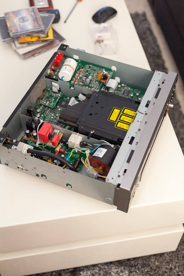

Htguy, make sure the laser has failed. I have bought a Denon dvd-5000 and 9000 that the owners said the laser failed. Both units had operating lasers, but the alignment was the culprit. Not sure if there is any adjustments on your transport(?).

all the denon
5910
3910
2900
2910
use the laser
HOP-1200S
I have the two players denon dvd 3910 and denon dvd 2900
And switched between them the laser Without problem.
If you buy a new laser
Make sure you remove the shorted solder bridge from the new laser
5910
3910
2900
2910
use the laser
HOP-1200S

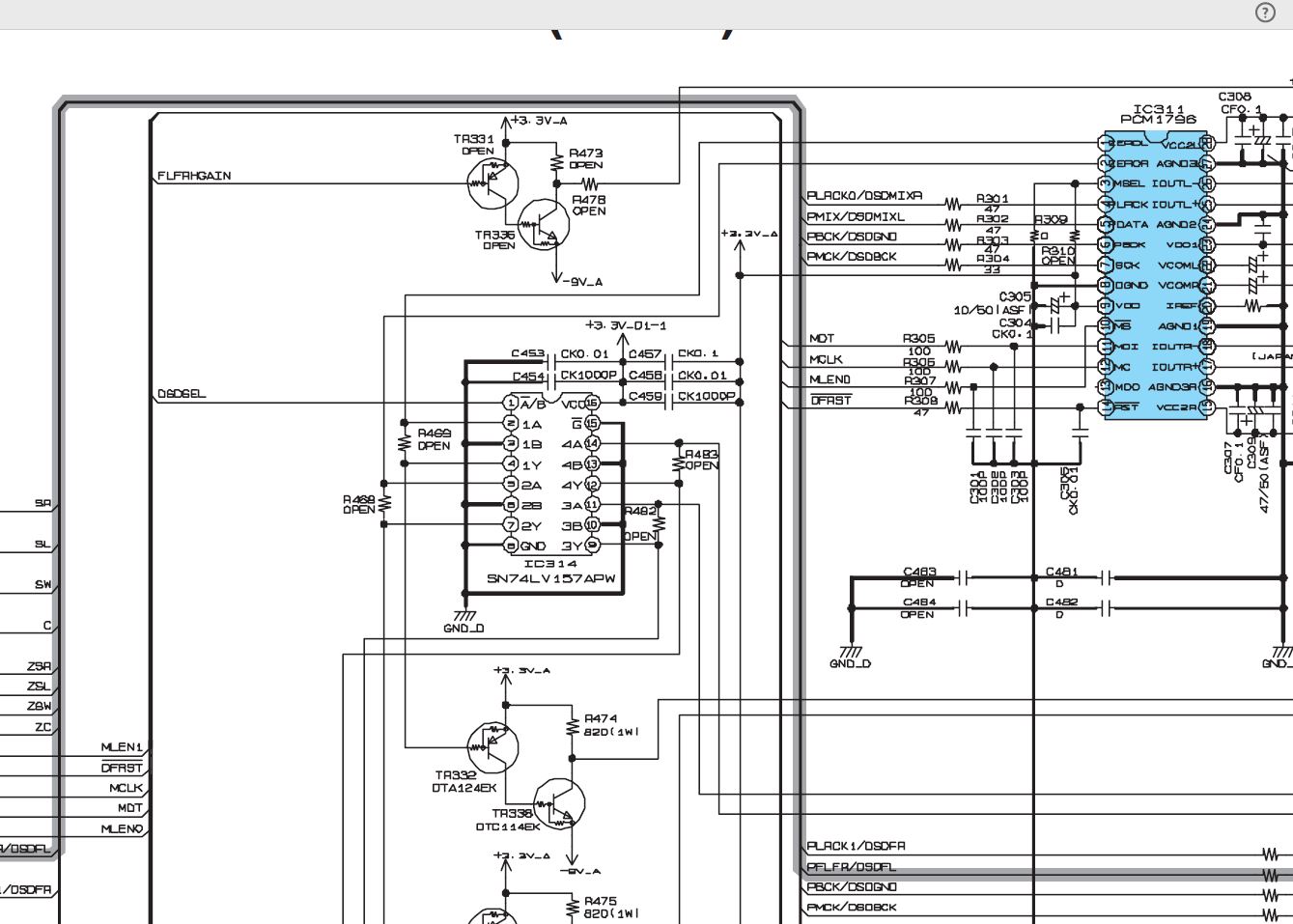

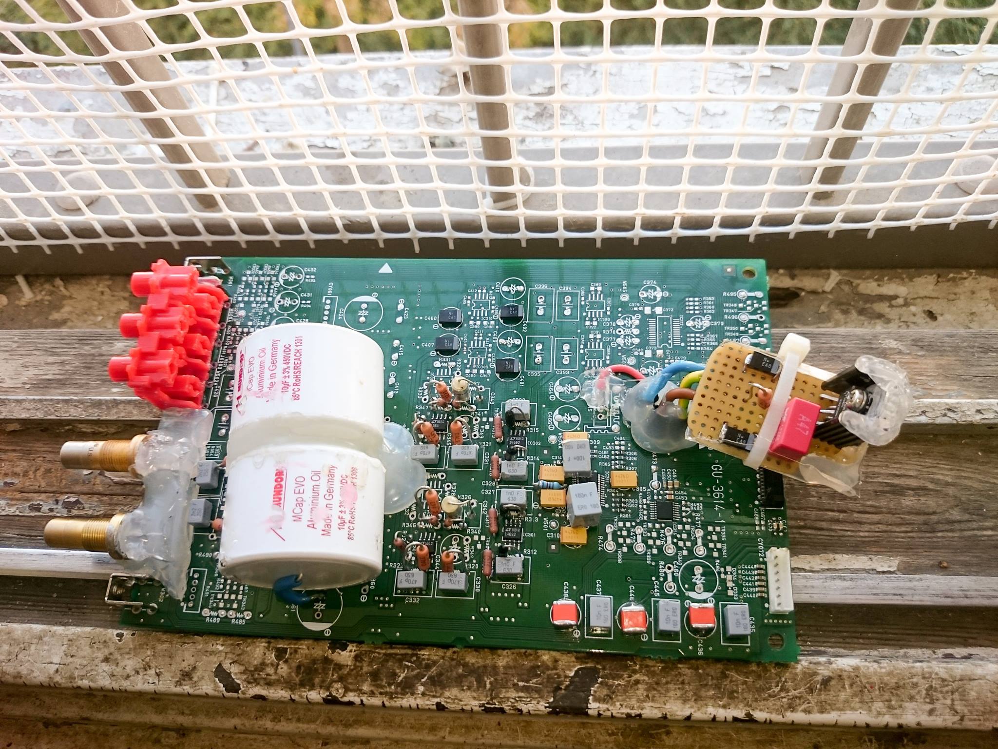

There are a few things you should check
1 Is SACD discs workers
2 Are Disks DVD workers
3 Is the CD workers
Concrete example
In my case about my project on the DENON 3910
One of the change i do in the audio circuit
I removed the SN74LV157 ( Data Selectors )
As a result of the PURE DIRECT circuit
did not work.
And CD discs did not work. and dvd\sacd work
I returned back to the SN74
To circuit
And discs of the CD worked.
My experience on my own projects
