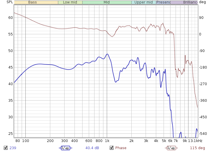

Off axis response with and without tape. Blue is without, purple is with
Oddly, the difference is not as apparent in the acoustic measurements as the impedance measurements.
I think this resonance is not storing energy but rejecting it at peaks in the impedance curve. Similar to how a notch filter does not continue to ring after it is stimulated. Or maybe I just have no idea.
Or perhaps the acoustic effect is more due to the tape acting like a phase plug. This would explain why the acoustic effect has repeating frequency components while the impedance effect does not.
