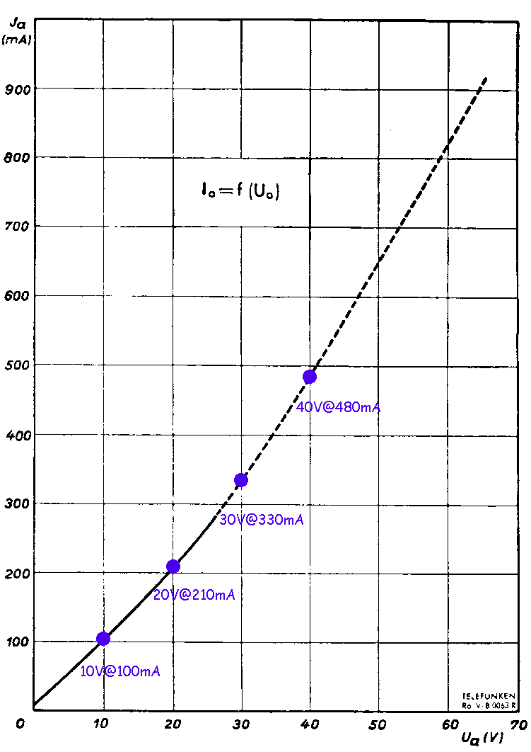

I could probably figure this out without getting it into Duncan's PSU designer, but I am doing my best to learn more about design and build the best amplifier I can. Thus I would like to model the power supply. However, I can't figure it out!! This is my first time attempting to use the software, let alone adding a custom tube. I am following Duncan's youtube video on the subject, and trying to follow along with the Telefunken datasheet. Duncan advises to get the datasheet, and find the INSTANTANEOUS FORWARD VOLTAGE chart. What I am seeing on the Telefunken datasheet does not appear to match up with what's requested. I hope someone more experienced can point out if one of these charts in fact does provide the data I need, or if neither does, what can be done to model the EZ150 rectifier.

You are easily my favorite person today. Out of curiosity, did you already have this EZ150.rect file, or did you create it from the telefunken datasheets?Hello,

The 5V4G has quite a similar anode-cathode voltage drop versus current to the EZ150, so as a simple first-in use (or a comparison to any EZ150 model you prepare), it can be used in any PSUD2 simulation. Yes the simulation may alert you to limits being exceeded, but that won't void the simulation results.

Hmmm... one of the first Google hits for "EZ150 rectifier data", this, seems to have that info.Duncan advises to get the datasheet, and find the INSTANTANEOUS FORWARD VOLTAGE chart. What I am seeing on the Telefunken datasheet does not appear to match up
Also that sheet has graphs of "Typical" operation. Top of page 2 shows, fer example, 500VAC and 100r DCR (each side) into 16uFd makes 707VDC (of course) at no-load, 580VDC at 100mA, 400VDC at 200mA. Plot your hoped-for load condition on this graph, then think about your differences (more uFd, less R, etc).

Hi,You are easily my favorite person today. Out of curiosity, did you already have this EZ150.rect file, or did you create it from the telefunken datasheets?
And no, I did the EZ150 yesterday, because I already did it for silicon rectifiers... and it's simple.
