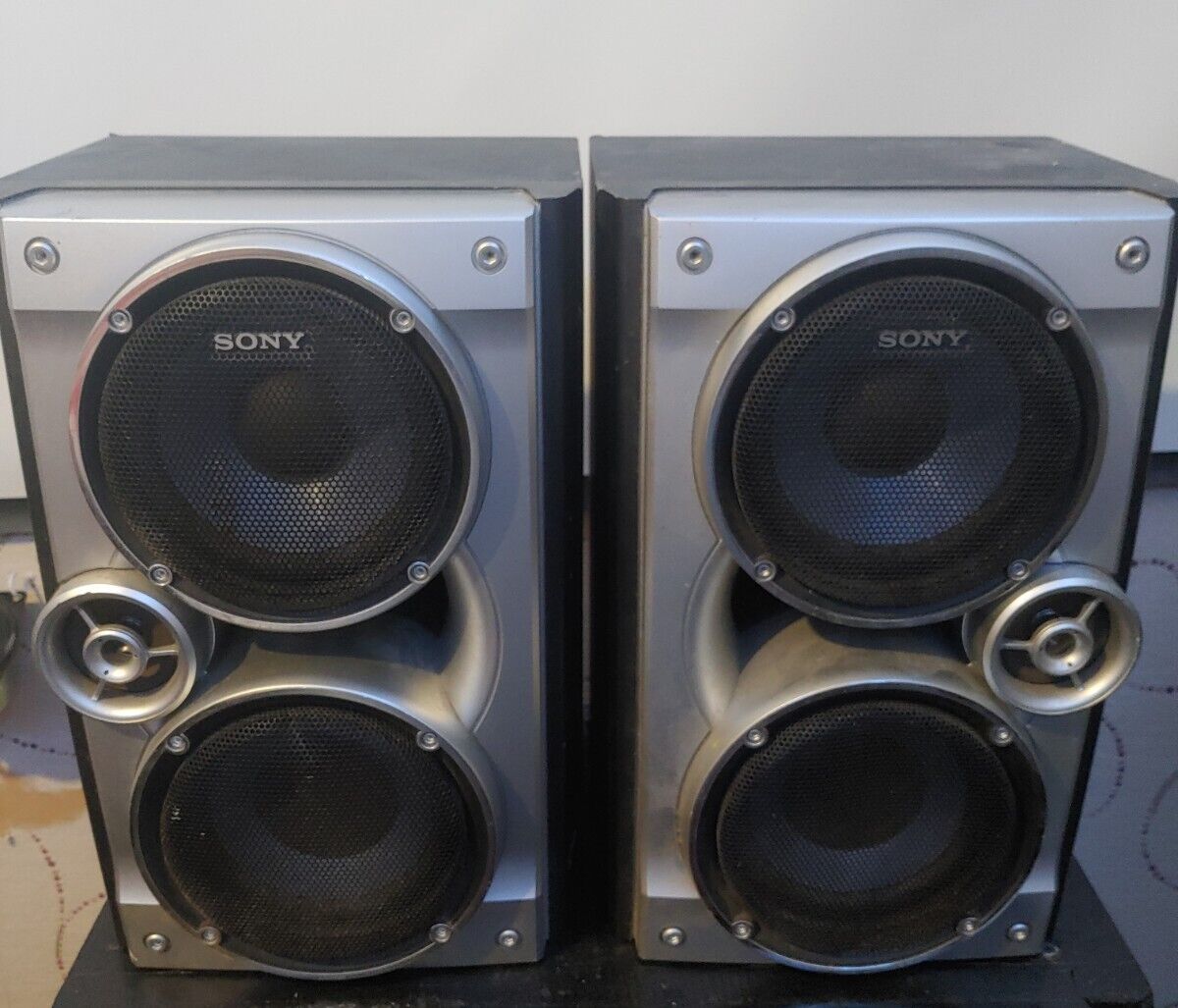

20-25 years ago Japanese manufacturers went on some bizarre, space-age trip. They started manufacturing weird-looking, plastic endowed speakers modelled on the Star Ship Enterprise. In 2023, they're just plain hideous!

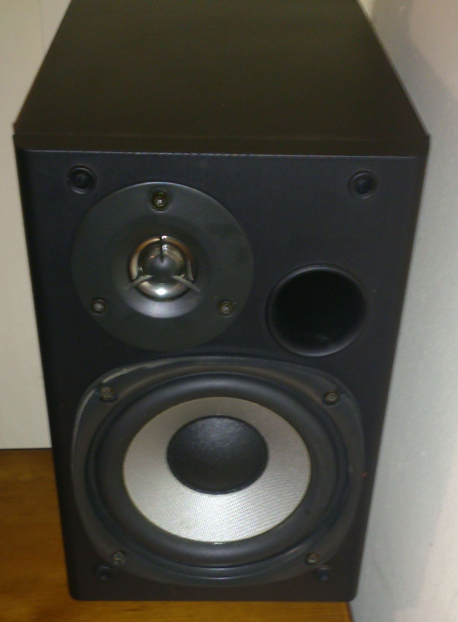

Bought these for £8.

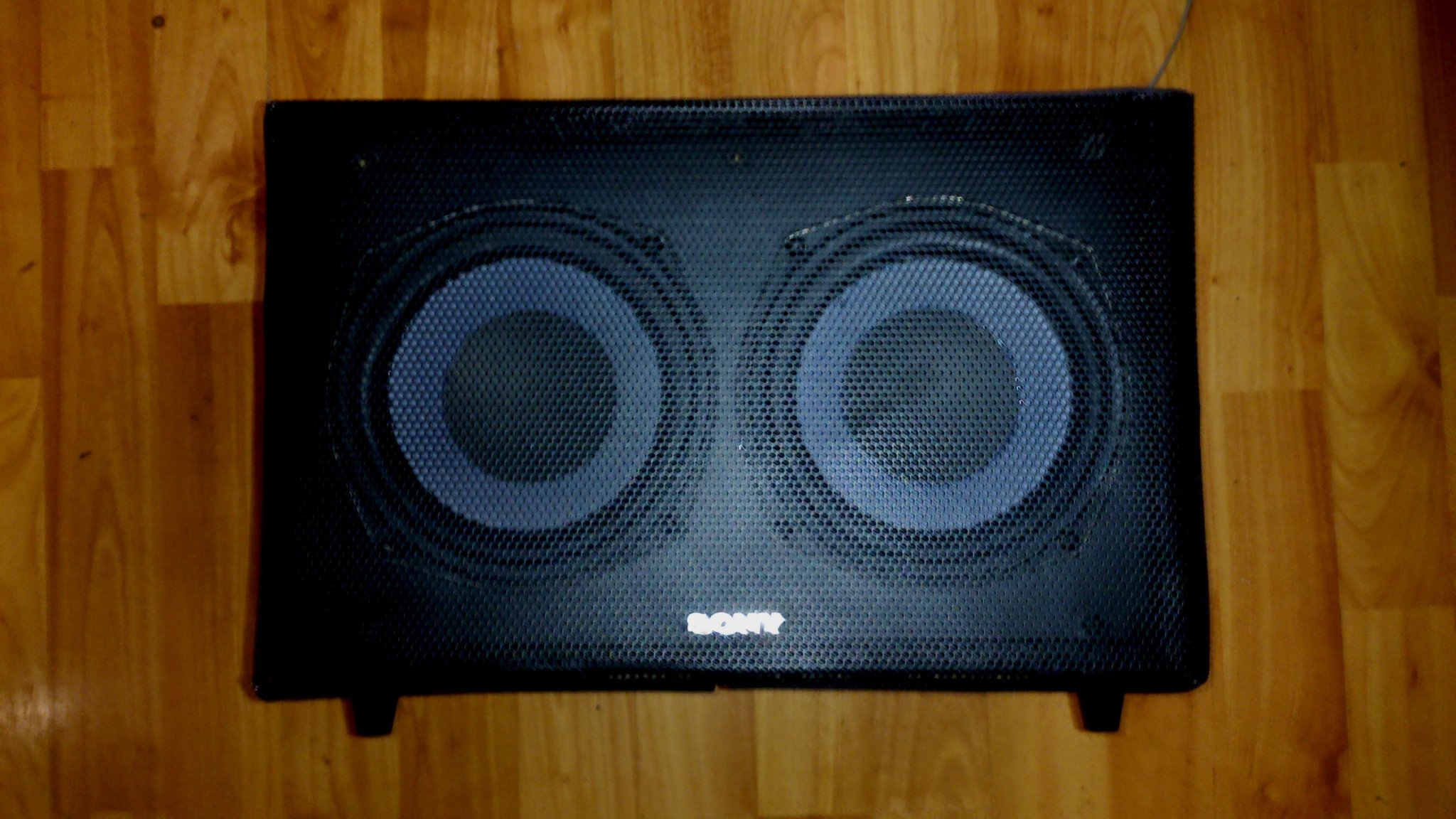

And I literally pulled a pair of Sony midi hi-fi speakers from a dumpster. The bass drivers were shot but tweeters functioned ok.

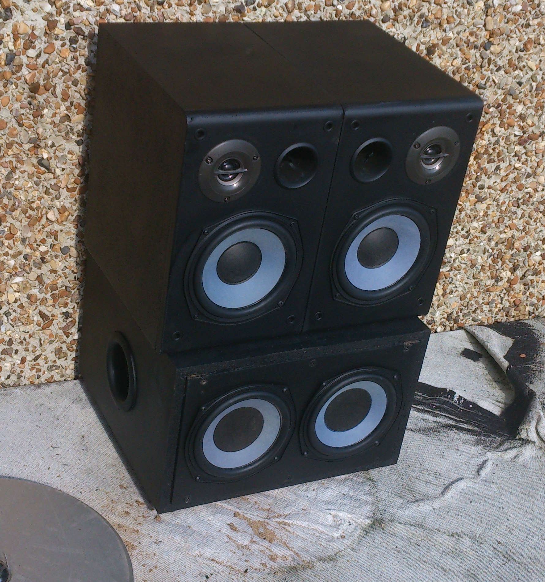

I wanted to make something that I could set up outside for barbeques etc. Something that cost nothing. Something that I wouldn't cry about if it got wet in a shower or if burger sauce got dripped on it.
Voila!
It's far from finished but I'm shocked at how good this sounds outside. I'm having a small problem with the sub grille (rattles) but that will be cured when I can get hold of router. I also suspect the Bluetooth TPA3116D2 will object to 3ohms on the mono channel at some point.
My total cost including Bluetooth amp and laptop brick will be less than £30.
Thoughts?

Good work. IME, some Sony drivers are very good, probably some of the best roadkill I have found, currently doing a small 3 way with nice 6" paper Sony woofers.

Can you tell if the rattle is from the unsupported span or from something happening at the edges? How is it mounted currently?
