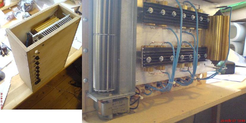

Hi.
I made this box from scrap. The following resistances are available:
2 * 7.33 Ohm /150W
2* 7.6 Ohm /100W
1* 7 Ohm /250W
Cooling is done with a fan. I don't think it could remove the worst-case-heat, but for shorter periods its fine.
Regards TroelsM

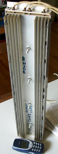

my double dummy load
This is my own made double dummy load. In a simple package there are two dummies made from nickel-chromium edge wound wire each of 8Ù / 20°C or 8,16Ù / 100°C. And each of power about 2,5KW.
